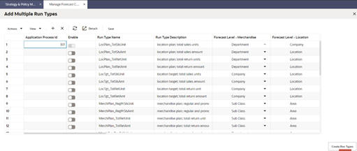

Add Multiple Run Types
Click on the Add Multiple Run Types button. It will open a tab with a table consisting of available templates to create multiple run types at a time, as shown below. If the Enable column button is turned on and Process Flag column is null, then the corresponding row will be considered for creating run type. Click on the Create Run Types button to create multiple run types.
Click on + icon to add new process IDs to the table, as shown below. Select rows from the table and click on X icon to delete process IDs. User can also edit parameters within each row if Process Flag is null. Click the Save button to save the changes.
Figure 11-14 Add Multiple Run TypesAdd multiple run types.
Figure 11-15 Specify Run Type ConfigurationsSpecify run type configurations
