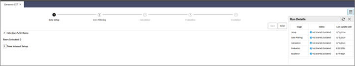

The Generate CDTs tab is used to configure, run, evaluate, modify, and deploy a CDT. The process is divided into five stages that must be run in order. You can return to a stage you have already completed and make changes, but if you do, you must rerun that stage and all the stages that follow that stage, as the calculations are invalidated by the modifications you just made to the settings in the stage you changed.
Figure 2-10 Generate CDT Tab
The five CDT stages are:
Table 2-6 Generate CDTs Tab: Stages
| Stage Name | Description |
Data Setup |
Select CMPO groups and define the time intervals for the data to be used in the calculation. |
Data Filtering |
Filter out input data that may result in inaccurate or unreliable answers. |
Calculation |
Calculate the CDT. |
Evaluation |
Assess the reliability and accuracy of the results of the calculation. Prune unreliable or inaccurate answers. |
Escalation |
Set the escalation path for the CDT. Use the Escalation Report to evaluate the results of the escalation. |
