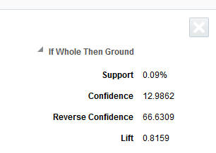

Support
The percent of market baskets that contain items from the IF and THEN components of the rule.
Written as a formula: Rule Transaction Count/Total Transaction Count
Confidence
The ratio of the number of transactions where the entire rule is present, compared to all transactions containing IF items.
Written as a formula: Rule Transaction Count/Total IF Transaction Count
Reverse Confidence
The ratio of the number of transactions where the entire rule is present, compared to all transactions containing THEN items. If a rule has a higher Reverse Confidence than its own Confidence value, then it indicates that the rule is better represented by the reversal of the IF and THEN components.
Written as a formula: Rule Transaction Count / Total THEN Transaction Count
Lift
A statistical measure of how strong the product affinity is, as compared to random chance for the rule (higher is better).
Written as a formula: Rule Transaction Count * Total Transaction Count / Total IF Transaction Count/Total THEN Transaction Count

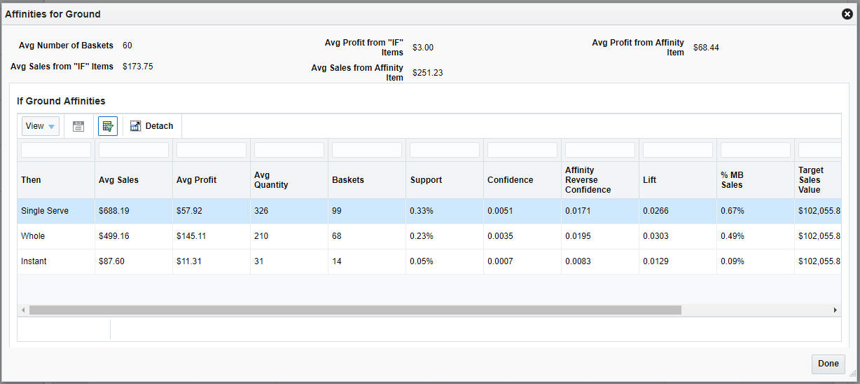

Another way to view the market basket affinities is to click the button found to the left of each row in the data table. This button displays a pop-up window with all of the product affinities that have been found for the IF components of the rule. This can be especially useful when your goal is to find any relationships with a specific product category, rather than seeing all of the relationships between different products.
Figure 7-9 Targeted Product Affinities Pop-Up
Description of Figure 7-9 follows
Description of "Figure 7-9 Targeted Product Affinities Pop-Up"
This screen is split into two main sections: the top section displays summary metrics for all rules associated with the IF components, and the bottom section displays all of the product affinities found for the IF components and a selection of detailed metrics for them.
Table 7-14 Targeted Product Affinities Summary Metrics
Field Name Description
Avg Number of Baskets
The average number of baskets found on a rule containing the IF items.
Avg Sales from IF Items
The average sales retail amount for the IF items in the rules.
Avg Profit from IF Items
The average sales profit for the IF items in the rules.
Avg Sales from Affinity Item
The average sales retail amount for the THEN items in the rules.
Avg Profit from Affinity Item
The average sales profit for the THEN items in the rules.
Table 7-15 Targeted Product Affinities Detail Metrics
Then
Displays the class or subclass that was found to have an affinity with the IF components of the market basket rule.
Avg Sales
The average weekly sales retail amount for the IF and THEN items in the rules.
Avg Profit
The average weekly sales profit for the IF and THEN items in the rules.
Avg Quantity
The average weekly sales units for the IF and THEN items in the rules.
Baskets
The number of market baskets that contain items from the IF and THEN components of the rule.
Support
Confidence
Affinity Reverse Confidence
Lift
% MB Sales
The percent of total sales retail amount that the rule represents.
Target Sales Value
The average weekly total sales retail amount across all transactions in the selected periods.
Target Profit
The average weekly total sales profit across all transactions in the selected periods.
Target Sales Quantity
The average weekly total sales units across all transactions in the selected periods.
This view of market basket affinities provides powerful insight into the relationships between different product categories, as it may expose affinities even between seemingly unrelated categories that your customers tend to purchase together. This screen allows you to see how actions taken on the target (IF) products will impact other areas within your business. For example, any action taken to increase the sales of an IF category can lift the sales of all other products with a strong affinity to those items. Conversely, if you have a category that is performing poorly on the THEN side of a rule, you may be able to take action on the IF products to boost that category's sales indirectly.
