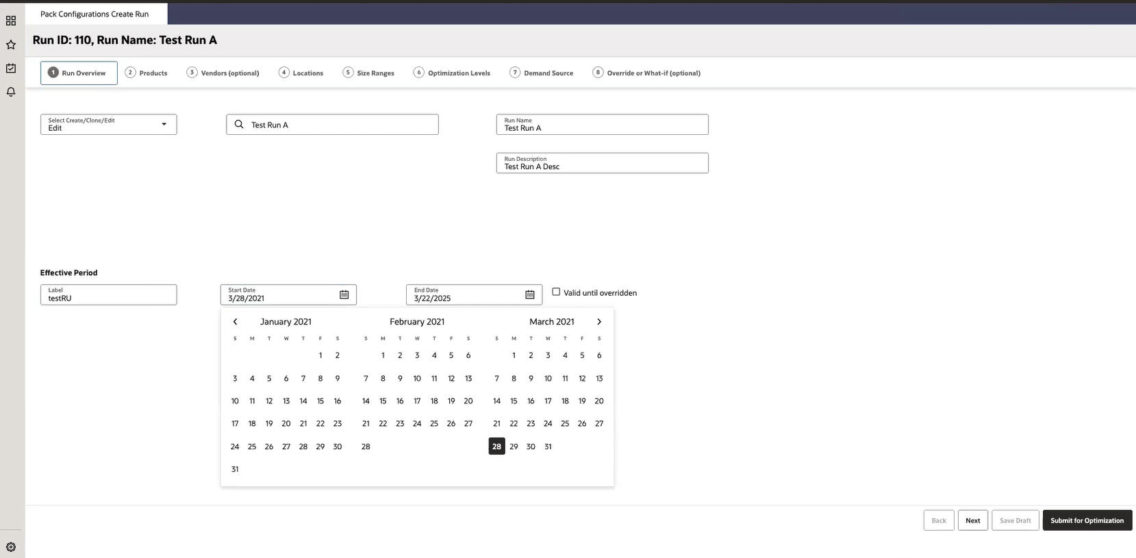

- Run Name is a user-entered label that is used throughout the application to reference a given run. The Run description allows you to provide some additional description about the run.
The Effective Period Label gives you a way to track the period for which these pack configurations are effective, which could be the Season such as “Fall 2028” as an example. Selected Start and End dates denote the effective time periods. The option for Valid Until Overridden when checked indicates that the Pack Configuration is effective until superseded by another Approved Pack Configuration (from a different Run or a scenario).
The effective periods are used in the following places:
When Creating a Run (in the optional override/what-if tab), other available pack configurations are displayed based on the effective product/location/vendor/size range and effective period.
When Approving Runs, you can choose to filter Pack Configuration runs based on the time period they are effective for.

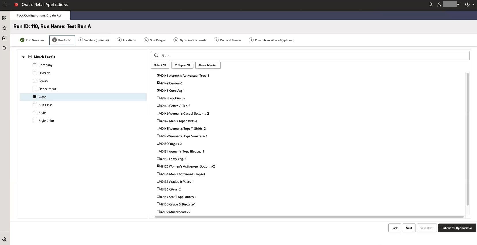

Select Products
Figure 14-5 Select Products
Products can be selected from any level. Lowest level is Style Color. Typical expected usage is Selection at the Department or Class level.
The selected products' (further filtered by vendors, locations, and size ranges) demand source will be included when generating pre-pack configurations.
Demand Source is explained below. Note also the selected Products, Locations, Vendors, and Size Ranges define the Scope of a run and when combined with the Optimization Level, determine how many pre-pack configuration sets are generated.Select Vendors

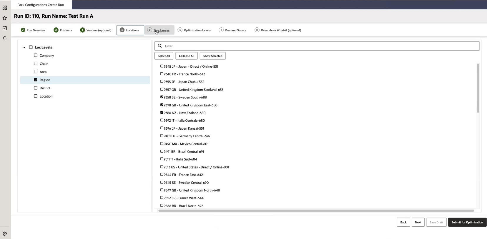

Select Locations
Figure 14-7 Select Locations
Locations selected are included for the Pack Configuration Optimization.
The selected locations' (further filtered by selected products, size ranges, and vendors) demand source will be included when generating pre-pack configurations.
Demand Source is explained below. Note also the selected Products, Locations, Vendors, and Size Ranges define the Scope of a run and, when combined with Optimization Level, determine how many pre-pack configuration sets are generated.Select Size Ranges

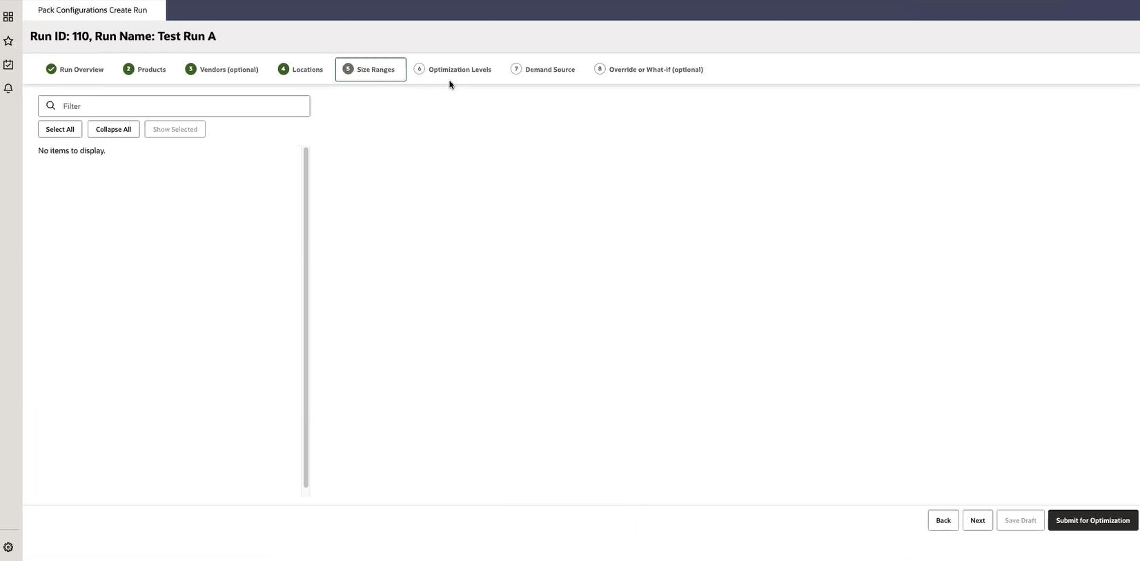

Figure 14-8 Select Size Ranges
Size Ranges provided are pre-filtered based on selected Products and Locations.

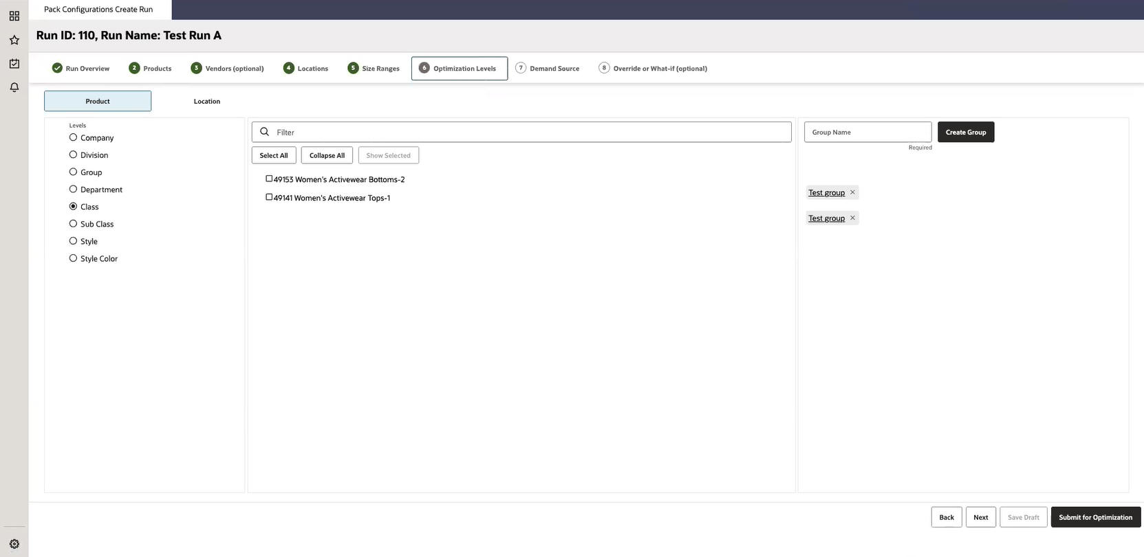

Select Optimization Level
Figure 14-9 Select Optimization Level
The Optimization level drives the level at which Pack Configuration sets are generated. All selected Products and Locations are then grouped by or aggregated to the selected optimization level.
For example, if Dept A (Product) and Chain (Location) are selected in the Select Product and Select Location steps and the optimization level is specified as Class/Chain level, pack configurations are generated by Class for all Products in Dept A.
For example, if Styles 1,2, and 3 and Chain (Location) are selected in Select Product step and Select Location steps and the optimization level is specified as Class/Chain level, pack configurations are generated by Class but only including demand data from Styles 1, 2, and 3.

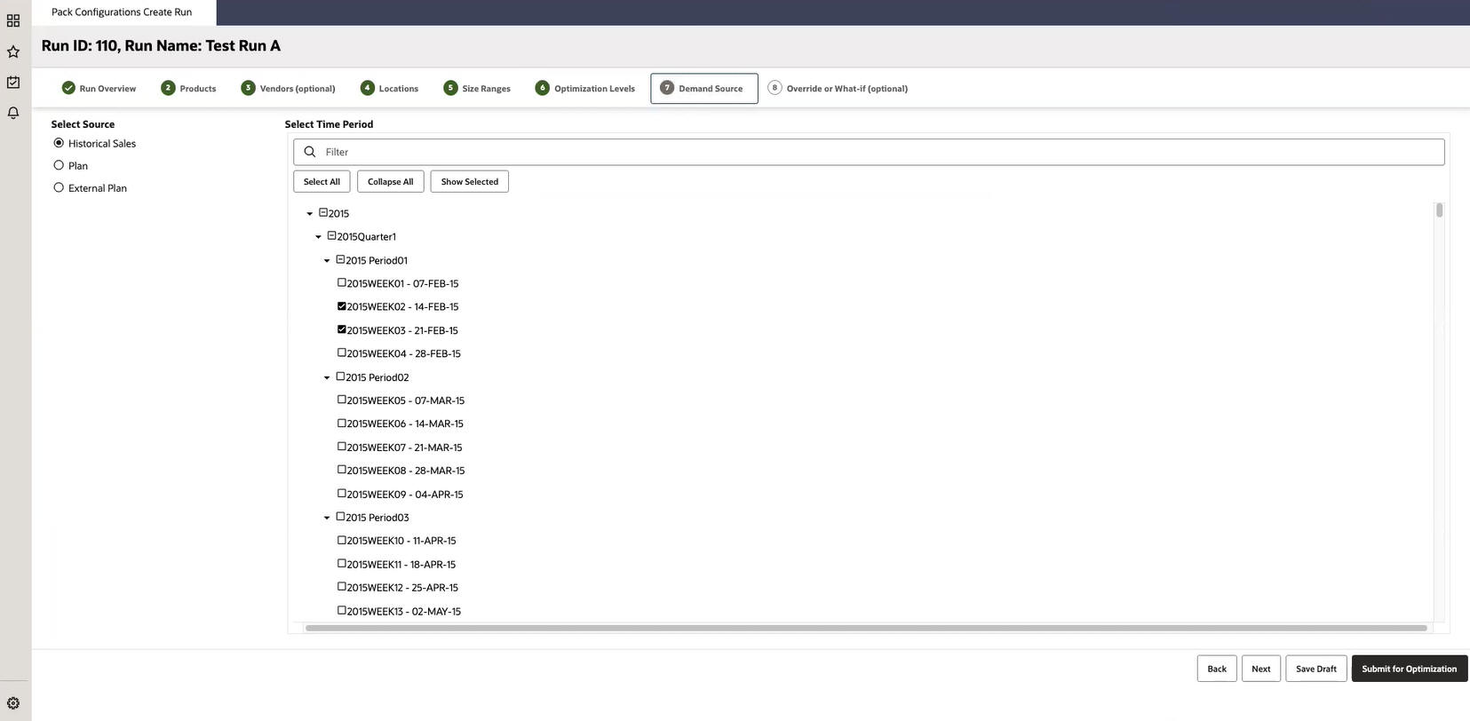

Select Demand Source
Demand Source can be selected to be either Historical Sales or External Plan. Once the demand source is selected, you can select the time periods to include.
These selections form the basis for generating pre-pack configurations recommendations. For example, when generating pack configurations for Women's Activewear for the next Fall season, it is expected that you select the relevant time periods from Historical Sales or External Plan. It is possible to select multiple weeks from the same selling period, for example, all fall weeks across multiple years.

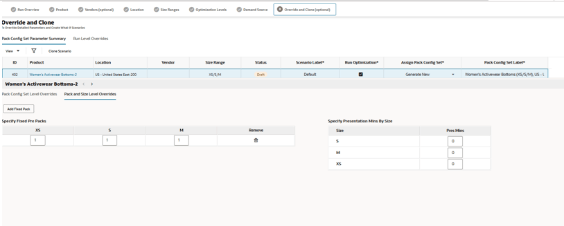

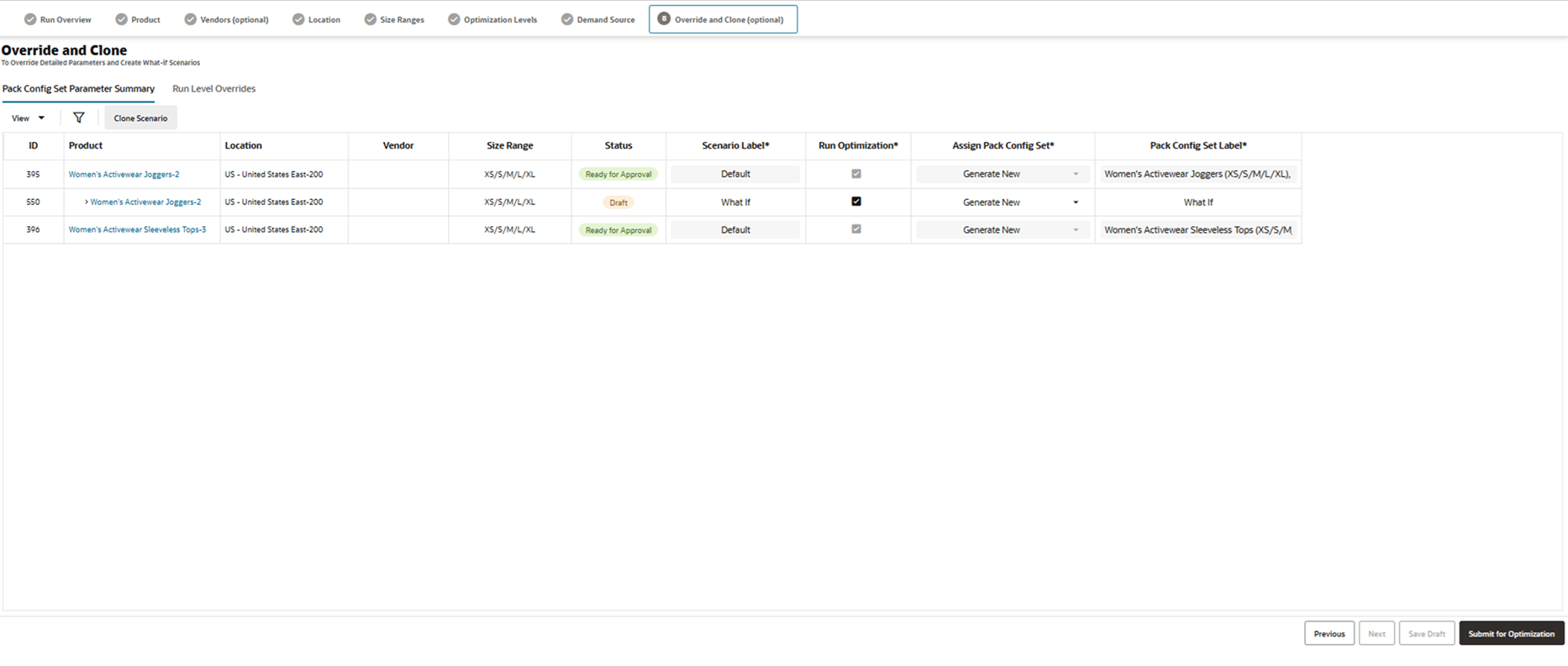

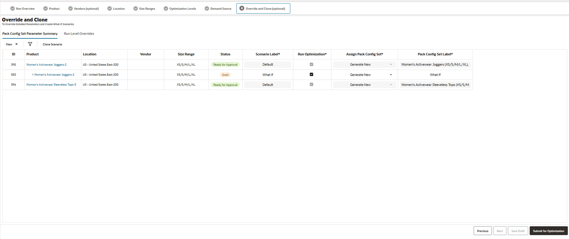

Override and Clone (Optional)
This screen might take a minute or so to load, depending on number of prod/locs selected. The spinner displays the completion percentage.
Once the screen loads, you can see a table filled with Pack Configuration Sets to be generated in this run. The table is generated based on the selections from the previous step, as explained in the preceding text. A single scenario is created for each Unit of Work or desired Pack Configuration Set with the scenario label defaulted. You have the option to relabel the scenario.
Each row corresponds to a desired Pack Configuration Set, when the table is initially created. You have the option to create additional rows in the table by cloning existing scenarios.
The Product Level and Location Level are dynamically determined based on the selections for Optimization Level. These are the first two column names in the table.
Labels with an asterisk indicate user-editable fields.
Pack Config Set Label is auto-generated based on the combination of Product/Location/Size Range/Vendor values. You have the option to override them. The label can then be used when reviewing and approving Pack Configurations in the Review and Approve flow.
Assign Pack Config Set defaults to Generate New.

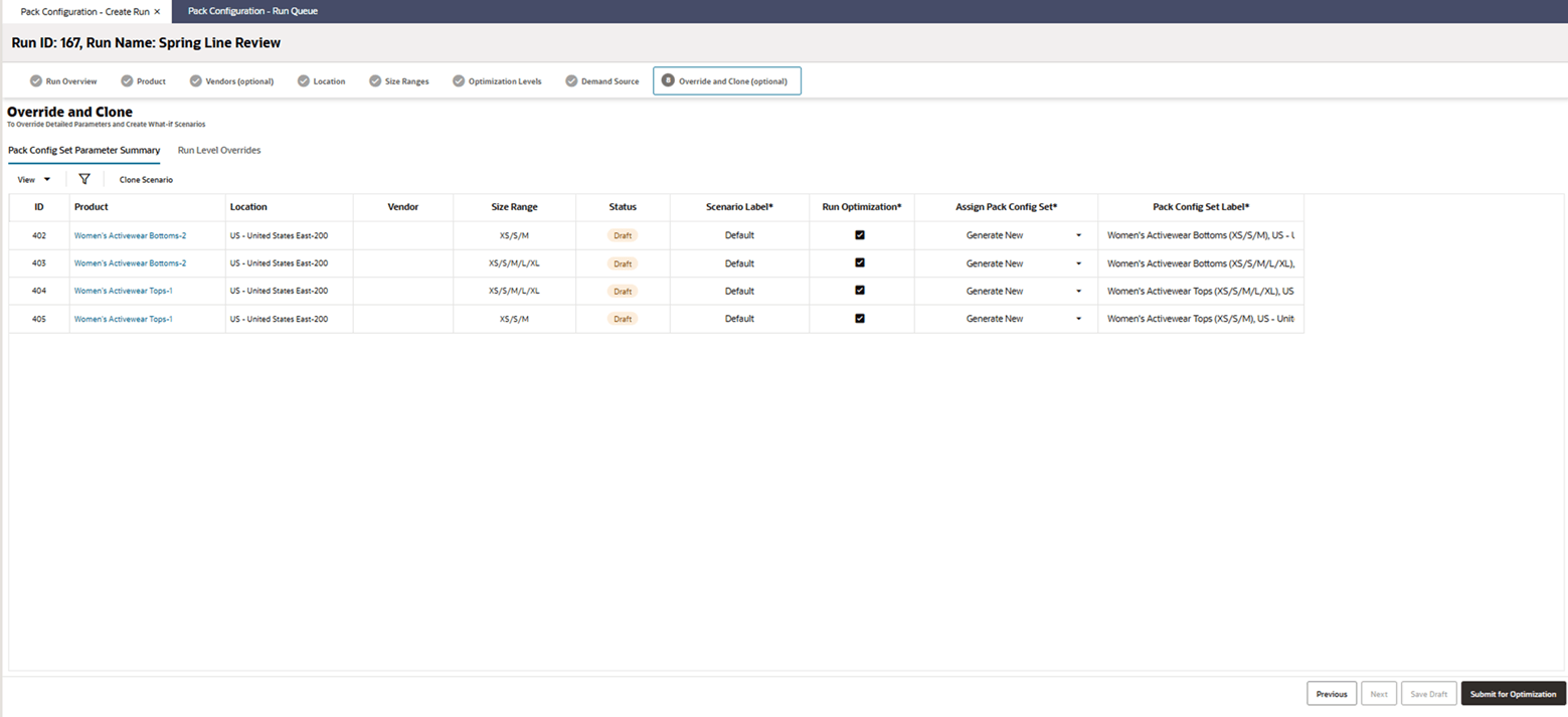

Figure 14-10 Override and Close

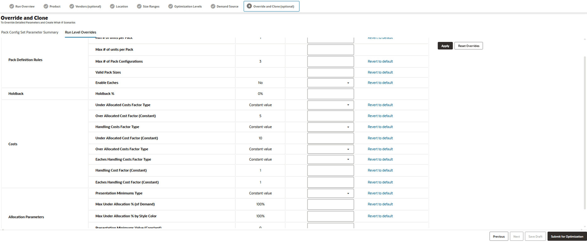

Overriding Parameters at the Run level
Figure 14-11 Override at the Run Level
Four sets of Run level override parameters are available to all application users: Pack Definition Rules, Holdback, Costs, and Allocation Parameters. An additional set of Advanced Parameters are available for override only to users entitled with the ADMINISTRATOR_JOB role (see the Oracle Retail AI Foundation Cloud Services Administration Guide for details).
These rules represent business constraints that need to be honored around how packs are recommended. These constraints could be due to constraints from the vendor or supply chain constraints around the ability to handle certain sizes of packs.
Minimum total units per pack: This is to be set based on vendor and supply chain constraints.
Maximum total units per pack: This is to be set based on vendor and supply chain constraints.
Valid Pack Sizes ladder: This allows you to enter a list of acceptable values such as 4,6,8,10,13,14.
Enable Eaches: If this is set, the optimization will fill the remaining demand outstanding after allocating packs with Eaches.
Max number of Pack Configurations: This value is set to indicate to the system not to try more pack configurations than this during optimization. This is helpful to ensure the optimization runs within acceptable and realistic search space and therefore does not unnecessarily process unrealistic scenarios. Within this, the optimizer will recommend the optimal number of Pack Configurations.
Holdback
This allows you to simulate situations where it is best practice to holdback a % of the demand at the Warehouse to replenish in eaches to stores, based on in-season sales. It is possible for you to simulate different holdback scenarios to see the difference in recommended pack configurations.
Holdback%: A % value of demand to be used as held back demand. For example, if this value is set to 30%, then 70% of the total demand (from the user selections of time period for the optimization level) are used for Pack Optimization. The remaining demand is assumed to be fulfilled in Eaches.
Holdback Eaches Handling Costs Factor Type: This currently defaults to Constant.
Holdback Eaches Handling Cost Factor (Constant): Specifies the factor by which every single holdback item gets multiplied by, for computing the handling cost associated with Holdback for the scenario. It should be noted that Holdback costs are not considered as part of the optimization, but are included in the results for reporting purposes.
Costs
These are cost factors that the optimizer considers when balancing tradeoffs.
Under Allocated Costs Factor Type: This currently defaults to Constant.
Under Allocated Costs Factor (Constant): Specifies the factor by which every under allocated unit gets multiplied by, when the optimizer computes the over allocation cost for any scenario it evaluates. Recall that the optimizer tries to minimize the net objective cost and it is computed as the sum of Over Allocation Cost, Under Allocation Cost, and Handling Cost.
Over Allocated Costs Factor Type: This currently defaults to Constant.
Over Allocated Costs Factor (Constant): Specifies the factor by which every over allocated unit gets multiplied by, when the optimizer computes the over allocation cost for any scenario it evaluates. Recall that the optimizer tries to minimize the net objective cost and it is computed as the sum of Over Allocation Cost, Under Allocation Cost, and Handling Cost.
It may be considered that the cost of over allocating is different from cost (increased markdowns) of under allocating (lost revenue). Hence this level of flexibility is provided.
Handling Costs Factor (Constant): Specifies the factor by which every pre pack gets multiplied by, when the optimizer computes the handling cost for any scenario it evaluates. Recall that the optimizer tries to minimize the net objective cost and it is computed as the sum of Over Allocation Cost, Under Allocation Cost, and Handling Cost.
Eaches Handling Cost Factor (Constant): Specifies the factor by which every single item (also called Eaches) gets multiplied by, when the optimizer computes the handling cost for any scenario it evaluates. It is possible that it may be less or more laborious to handle eaches compared to handling pre-packs, hence this level of flexibility is provided. Recall that the optimizer tries to minimize the net objective cost and it is computed as the sum of Over Allocation Cost, Under Allocation Cost, and Handling Cost.
Allocation Constraints
These allow you to impose constraints for the mock allocation to ensure presentation minimums are met and style colors and stores do not get allocated below or above an acceptable threshold even if it may be sub-optimal to do so at an aggregate level.
Presentation Minimums Type: This can be chosen among Constant, Size and no value (see Presentation Minimums Value for details).
Presentation Minimums Value: If it is required that a minimum quantity of each SKU is sent to each store, this value can be set. For example, this would be useful to maintain presentation standards at the launch of an assortment at the beginning of the season. Note that this parameter can be overridden at the Size level if the Presentation Minimums Type field is set to Size, and this enables the corresponding Presentation Minimums by Size table in the Pack Configuration Set and Size Level Overrides tab (see below). In this way, for example, it is possible to specify presentation minimums for only some core sizes rather than all SKUs. If any changes are made in this screen tab, any size level overrides will be overridden.
Max Under Allocation % (of Demand): This parameter value imposes a maximum acceptable threshold on the percent of underallocation computed as the total underallocation across all stores aggregated up relative to the total demand. This can be used as a guard rail to ensure overall underallocation stays within a threshold even when it may be more efficient to underallocate demand rather than incur additional distribution costs.
Max Under Allocation % by Style Color: When the system performs the mock allocation, it computes the misallocation at each SKU and Store level. Misallocation is percent of demand that was either over or under allocated relative to the SKU/Store demand. This misallocation% is recomputed at the Style Color level by computing the total misallocation across all SKU/ Stores in the Style Color and comparing it to the demand at the Style Color. This parameter value imposes a maximum acceptable threshold on this. This can be used a guard rail to ensure no Style Colors are excessively used.
Max Over Allocation % (of Demand): This parameter value imposes a maximum acceptable threshold on the percent of overallocation computed as the total overallocation across all stores aggregated up relative to the total demand. This can be used as a guard rail to ensure overall overallocation stays within a threshold even when it may be more efficient to overallocate demand rather than incur in lost sales costs.
Advanced Parameters
These are advanced optimization parameters that are only available to Administrator users and allow deeper control on the optimization internals.
Enable Heuristic Mode: This enables the initial phase of the optimization algorithm (packs search) based on heuristics. Enabled by default.
Enable Full Optimization Mode: This enables the initial phase of the optimization algorithm (packs search) based on a linear cost model. Disabled by default.
Only one among Heuristic and Full Optimization modes can be enabled at one time.
Enable Demand Clustering: In the initial optimization phase, it reduces the demand matrix size by clustering.
Clustering Max Iterations: The maximum number of iterations of the clustering algorithm.
Max Demand Level Clusters: The maximum number of demand levels resulting from the clustering algorithm.
Max Size Profile Clusters: The maximum number of size profiles resulting from the clustering algorithm.
Number of Random Runs for Optimization Mode: The number of times the Full Optimization algorithm (packs search phase) is executed (with randomized initialization) to find the best solution.
Max Time at Plateau (sec) for Optimization Mode: For the Full Optimization mode (packs search phase), if the solution does not improve for the specified number of seconds, the algorithm will assume to have found a plateau, thus will accept the solution and proceed with the subsequent phases.
Max Total Runtime (sec) for Optimization Mode: For the Full Optimization mode (packs search phase), the maximum number of seconds the algorithm is allowed to run (regardless of plateaus), before accepting the solution and proceeding with the subsequent phases.
Convergence % Threshold for Optimization Mode: The percentage convergence threshold for the Full Optimization mode.
Max Total Runtime (sec) for Eaches Optimization: To obtain a measure of the misallocation induced by the integer rounding of the demand matrix, and at the same time obtaining a baseline measure of the costs incurred if only eaches (and no packs) were utilized, the optimization starts by simulating an allocation via eaches only; this parameter controls the maximum total runtime of this phase.
Number of Random Runs for Optimal Allocation Mode: The number of times the final allocation phase of the optimization is executed to find the best solution, regardless whether Heuristic or Full Optimization modes were enabled in the initial packs search phase.
Max Total Runtime (sec) for Optimal Allocation Mode: For the final allocation phase of the optimization, the maximum number of seconds the algorithm is allowed to run before accepting the solution.
Convergence % Threshold for Optimal Allocation Mode: The percentage convergence threshold for the final allocation phase.
Enable Verbose Logging: This enables additional logging for the optimization algorithm, which is only available to Oracle Support.
Saving overrides at the run level: Once you click Apply, this spreads the override values to all scenarios. Note that any previous scenario level overrides will then get overridden. Hence it is important that you set parameters at the Run level first and then perform any scenario specific overrides.
The Reset Overrides automatically overrides any user-entered values with Default values. This is an easy way to undo any work in progress edits and start over.

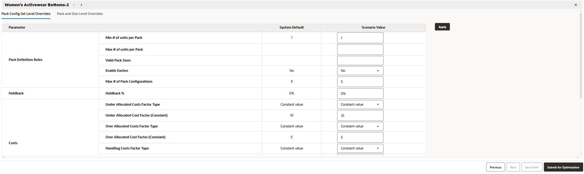

Figure 14-12 Pack Configuration Set and Size Level Overrides
Pack Configuration Set level Overrides: Parameters provided are similar to the Run level overrides. For details, see above.
Figure 14-13 Pack Configuration Set and Size Level Overrides
Fixed Pre-Packs
These pre-packs, if specified, are used by the optimizer as given. The user has the option to create additional rows to specify fixed pre-pack configurations by clicking the Add Fixed Pack button.
See above for details on Presentation Minimums. It is possible to override or specify these at the size level here.
Note that parameters are saved for approved scenarios and used for subsequent runs.
Creating Additional Clone Scenarios
After selecting a scenario or Unit of Work in the table, the Clone Scenario button is enabled. Clicking it prompts you to enter a Scenario Label and once you click OK, it creates a new row in the table with all the same values as the parent scenario other than the Scenario label. You can then go to the override drawer to make scenario specific overrides.
