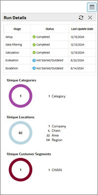

CDT Generation Stage Status
The CDT Generation Stage Status table displays the status of each of the CDT stages.
Click the Refresh icon to update the fields and see the latest status for each stage.

You can use the status information to monitor the progress of each stage. It contains the following fields, which can be viewed, but not modified. You can also view from the contextual pane the number of categories/Locations/Segments that are used for the CDTs current run.

A row exists in the table for each CDT stage that provides detailed status information. The five stages are Setup, Data Filtering, Calculation, Evaluation, and Escalation.
Stage Status
The current status of the stage: Not Started, Not Started (Scheduled for Later), Processing, Completed Successfully, Completed with Errors, Stopped/Paused, Cancelled, or Failed.
