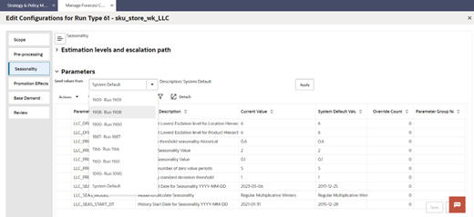

To review and override the value of configuration parameters for a run type, select a row and click Edit Configuration Parameters above the table. This button will display as View Configuration Parameters if the run type is in active status. The Edit configuration pop-up is similar to the Create Run pop-up that is used to create forecast runs and has a tab for each stage of estimation and forecast. In each tab, you can do one of the following, as shown below. .
  • Set the values of all configuration parameters in that stage, based on the system default for the run type. To do this, select System Default from the drop-down menu and click Apply.
  • Set the values of all configuration parameters in that stage based on the values that were previously set in one of the what-if runs. To do this, select the desired run from the drop-down menu and click Apply.
  • Override the value of a certain configuration parameter. To do this, select a row and click the Edit icon above the table.
Figure 11-32 Edit Run Type Configuration
Description of Figure 11-32 follows
Description of "Figure 11-32 Edit Run Type Configuration"
