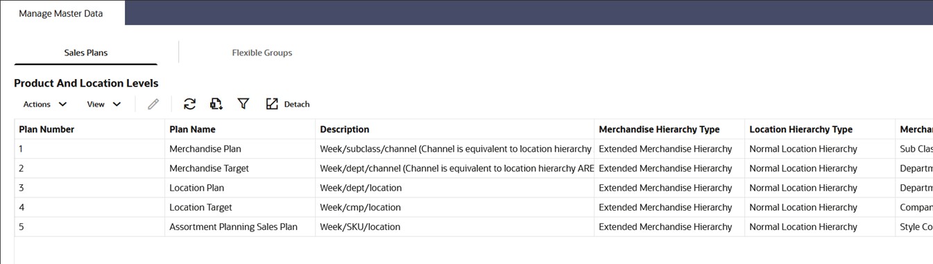

In the Sales Plans tab, as shown below, you can select a row and edit the Merchandise Level/Location Level or reset the value to the default levels. Sales Plans are used for in-season (Bayesian) forecasting within the Automatic Exponential Smoothing run types.
Figure 11-40 Sales Plans Tab
This image shows a sales plan.

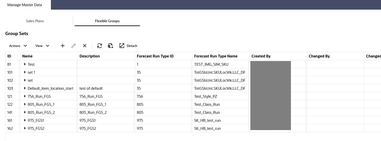

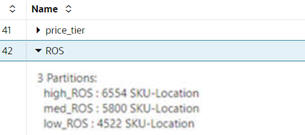

The Flexible Groups provide the grouping of merchandise/locations based on different criteria. These are used in the escalation path to estimate seasonality/elasticity values for Sales & Promo and Life Cycle run types. Flexible Groups ensure that the seasonality/elasticity estimation results are separately calculated for each group of merchandise/location. Group Set is the parent (that is, the grouping definition). Partitions are the children (that is, the groups within each group set). In the Flexible Groups tab, you can create a new flexible group set and edit and delete an existing flexible group set, as shown below. While creating a new flexible group set, you can add a new group set name (which must be unique), group set description, and select an existing run type from the drop-down list, as shown below . Once this step is done, the partitions (groups) inside the group set must be created. The partitions can be provided through IW using custom calculations or loaded through the staging interface (RSE_FLEX_GROUP_DTL_STG). By clicking the icon near group set name, you can see the partitions under it, as shown below. .
Figure 11-41 Flexible Groups Tab
This image shows flexible groups.

Figure 11-43 Partitions (Groups) under a Group Set
This image shows partitions.

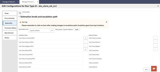

Once a new flexible group set is created and mapped to a run type, new escalation levels corresponding to the flexible group set will be automatically added under the Available Values column in the Estimation Levels and Escalation Path section of the Seasonality tab for the corresponding run type in Edit Configuration Parameters within the Manage screen, as shown below. .
Figure 11-44 Escalation Levels Based on Group Set are Available
This image shows edit configurations.
When a new What-If run is created from the Test screen under the corresponding run type, the run will also contain the additional escalation levels corresponding to the flex group set and will be displayed under the Available Values column in the Estimation Levels and Escalation Path section of the Seasonality tab.
