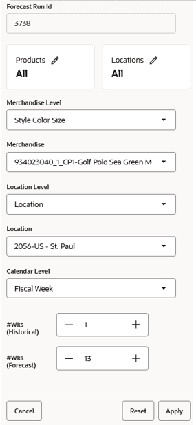

When entering the workspace, you can open the top filters panel.
The settings in the define the scope of the workspace.
For instance, you can select the products and locations that you want to review. Also, you select the number of historical and future weeks. Note that all the above selections can be made very easily. It is not necessary to select a huge scope, since working with smaller chunks of data is much more manageable from the workflow and performance perspectives.
Figure 12-26 Forecast Run Id
Forecast Run Id

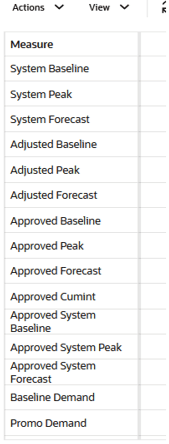

Once the scope of the workspace is determined, you move to the main screen and starts reviewing the forecasts. The information can be reviewed in grid format, as a chart or both. There is also the option to view the data in a pivot table.
Figure 12-27 Forecast Review Actions
Forecast Review actions
The metrics available in the screen are:
System Baseline
The System Baseline displays the system-generated baseline forecast. The values contained in this field are read only. The system baseline incorporates level, trend, seasonality, but no causal-related information.
System Peaks
The System Peaks displays the offer impacted demand generated by the engine. It is a read-only field, the together with the System Baseline equal the total demand.
System Forecast
This is a read-only measure that equals the system baseline plus the system peaks.
Adjusted Baseline
The value in this field initially defaults to the System Baseline if the forecast is automatically approved by the system or through a Forecast Approval Alert. Otherwise, the value in the Adjusted Baseline is different than the System Baseline if the metric has been updated by you.
Adjusted Peak
The value in this field initially defaults to the System Peak if the forecast is automatically approved by the system or through a Forecast Approval Alert. Otherwise, the value in the Adjusted Baseline is different than the System Baseline if the metric has been updated by you.
Adjusted Forecast
This is a read-only measure that equals the adjusted baseline plus the adjusted peaks.
Approved Baseline
The value in this field initially defaults to the Adjusted Baseline if the forecast is automatically approved by the system or through a Forecast Approval Alert. Otherwise, it displays the last approved baseline value.
Approved Peak
The value in this field initially defaults to the Adjusted Peak if the forecast is automatically approved by the system or through a Forecast Approval Alert. Otherwise, it displays the last approved peak value.
Approved Forecast
This read-only metric displays the approved forecast quantity. If changes are made to the Adjusted Forecast, the value in the Approved Forecast will reflect the adjustment.
Approved System Forecast
The Approved System Forecast is populated with the last System Forecast approved for a time series:
  1. Approval Method set to Automatic Approval
  2. Approval Method set to a Forecast Approval Alert and the alert is not triggered
Approved Cumint
Cumulative Intervals are used in safety stock calculation within allocation and replenishment systems. Its value is similar to a running total of a percentage of the actual forecast and is read only.
Baseline Demand
This read-only measure is the demand data used to generate the baseline forecast. This allows you to compare Actuals to forecast values. The metric is based on the historical sales which are undergoing several rounds corrections, including the removal of offer impacts on demand.
Promo Demand
This read-only measure is the demand data used to generate the forecast. This allows you to compare values. The metric is based on the historical sales which are undergoing several rounds corrections. The Promo Demand equals the Baseline Demand plus the promo driven demand.
Last Year Demand
This read-only measure equals the Baseline Demand shifted 52 weeks. This enables a convenient way to compare last years and future demand.

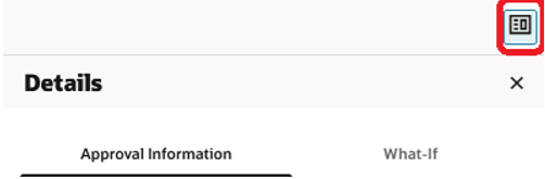

A screen that complements the review workflow is the Approval Information tab, that opens when you click Details.
Figure 12-28 Approval Information
Approval information
The two views have synchronized product and location hierarchies.

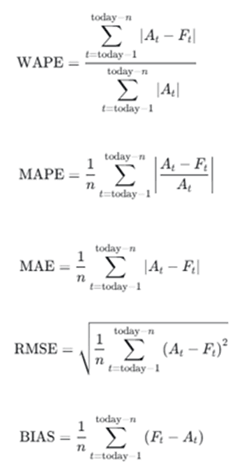

Error Metrics
To assist the forecast analyst in deciding which forecasts to review, there are several error metrics that can be reviewed.
When the accuracy is good with only a small error, the analyst may decide to move on and review other forecasts. When an item performs poorly, the analyst may want to spend some time to adjust the forecast values.
The error metrics are:
  • Weighted Absolute Percentage Error (WAPE)
  • Mean Absolute Percentage Error (MAPE)
  • Mean Absolute Error (MAE)
  • Root Mean Squared Error (RMSE)
  • Forecast Bias (BIAS)
The figure below shows the error metrics calculations. The errors are calculated using total adjusted sales (preprocessed) and approved forecast values in history.
Error Metrics Calculation
