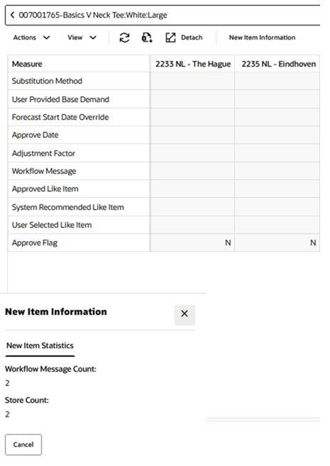

Figure 12-31 New Item Setup
This image shows the new item setup.

You can find more details when accessing the views in the bottom drawer, by clicking New Item Information in the main grid.
There are two tabs:
  • New Item Statistics
  • New Item Forecast
New Item Statistics
The measures in the New Item Statistics view are supporting the New Item setup process that happens mainly on the main screen. There is no need for a cycle set. The information shown in this view is relevant to the item selected in the grid, and for all stores.
The New Item Statistics view contains the following measures:
  • Workflow Message Count: This measure displays the count of the Workflow Message measure in the Select and Approve view. The workflow messages are guiding you in the New Item setup process. If the count is zero, you have set up correctly all New Items. The count corresponds to the number of New Item/store combinations that you still have to finish setting up.
  • Store Count: This measure displays the number of stores that a New Items has been set up for.
