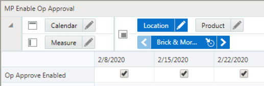

Merch Plan Step
In this step, you manipulate the Planners' ability to submit a plan for approval. Typically, this is enabled, allowing for submissions, until shortly before the period becomes in-season.
Select the weeks by department that you want to enable Planners to submit and approve plans to the original plan. Once you are satisfied with the setting updates you have made, commit the workbook in order to retain your changes.
Figure 6-1 MP Enable OP Approval View
Table 6-1 MP Enable OP Approval View Measure
Measure Description
MP Op Approve Enabled
Place a check mark in this measure to enable merch Planners to submit plans for approval. If approved, the plan can be promoted to Original Plan.

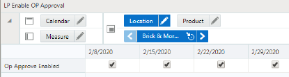

Location Plan Step
In this step, you manipulate the Location Planners' ability to submit a plan for approval. Typically this is enabled, allowing for submissions, until shortly before the period becomes in-season.
The Location Plan step has one view: LP Enable OP Approval.
Select the weeks by department that you want to enable Location Plan users to submit and approve plans to the original plan. Once you are satisfied with the setting updates you have made, commit the workbook in order to retain your changes.
Figure 6-2 LP Enable OP Approval View
Table 6-2 LP Enable OP Approval View Measure
Measure Description
LP Op Approve Enabled
Select this measure to enable Location Plan users to approve plans which can then be promoted to Original Plan.
