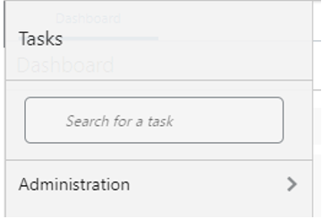

  1. After provisioning MFP Cloud Service, log in to the bootstrap domain as an Administration user.
  2. In the Tasks list, select Administration and then Online Admin Tools. Click Submit a New Admin Task.

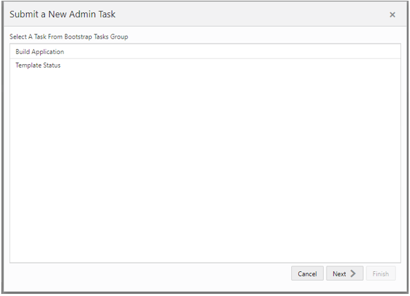

  3. Select the Build Application task and click Next.

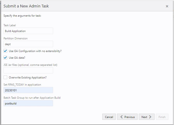

  4. Set the arguments for the task:
    Figure 2-3 Select Build MFP Cloud Service Domain Task Arguments
    This figure shows the task arguments.
    1. Enter the Task Label.
    2. Partition Dimension is defaulted to dept dimension in the MFP CS Template version. If the customer is deploying the application as a non-template version, provide the equivalent dimension name from the product hierarchy equivalent to the level of department. The application will be internally partitioned based on this dimension to allow parallel processing of data in the batch.
    3. Select the Use GA Configuration with no extensibility check box, only if you need to deploy the pure template configuration without any changes, otherwise uncheck this box and upload the new configuration to the Object Storage. If no configuration is found in Object Storage, the deploy job will fail.
    4. Select the Use GA data option only if the customer wants to deploy the application using the GA data set readily available for the application. If the customer wants to deploy and use their own data set, upload the files to Object Storage.
    5. Specify the JSE Jar files names if the customer is planning to use new special expressions within the configuration and the JAR file names containing those expressions to be registered. If the customer is providing these file names, they should also upload the JAR files to Object Storage.
    6. If the application was already created and needs to be overwritten, select the Overwrite Existing Application option; otherwise, do not select this option. Selecting this option will drop the existing application and all associated meta data stored, so it will also lose connection to the environment. The customer will need to log out and log in again to view the status of the deploy.
    7. RPAS_TODAY is an optional parameter. It is needed only if the customer is planning to use the GA data set. For MFP GA data, the preferred RPAS_TODAY date is 20230101.
    8. Select the Batch Task Group to run after Application Build. This is an optional parameter and if the template and GA dataset are used, the batch task to run is postbuild.
      If it is a template and non-GA dataset, the customer can either use set_rdx to enable RDX, or run post_hier to enable it and load/import hierarchy files. Or the customer can run postbuild_rdx to enable RDX and then run the postbuild with the customer data.
      If it is a non-template deploy, the customer can provide the batch task name that they want to run after the application build.
      Application Deploy without any batch will not load any hierarchy or data into the application, so the customer may need to run tasks to load hierarchy and data after domain build if they are not providing any task to run during the Application Build.

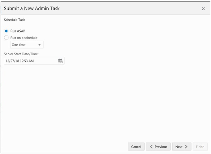

  5. Select the time to schedule the task and click Next. Click Run ASAP if the Administrator wants to run the task now or the task can be scheduled by selecting the Run on a Schedule option.

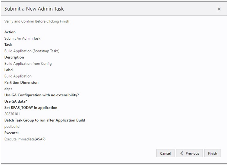

  6. Review the selections and click Finish.
    Figure 2-5 Verify and Confirm Selections
    This figure shows the screen to verify and confirm the selections.
  7. After submitting, review the status of that task in the dashboard similar to any other standard administration tasks.
  8. After the task is successfully completed, log out and log in to the application to view the additional tasks specific to the newly built domain.

  1. After deploying MFP Cloud Service, log in to the application as an Administration user.

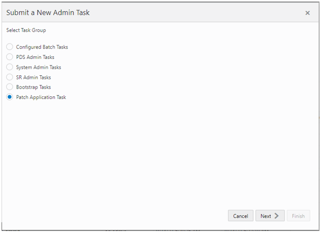

  3. Select the Patch Application Task and then click Next. Then select Patch Application in the available list of tasks.

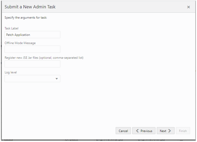

    Figure 2-8 Select Patch Application Task Arguments
    This figure shows specifying the arguments for the task.
    1. Enter the Task Label and Offline Mode Message.
    2. Specify if any new JAR files that need to be registered for any changes to the application configuration as part of the Patching process. The customer should also upload any new JAR files containing that special expression.
    3. After choosing all the necessary options and Log level, click Next.

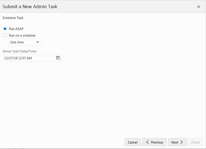

  5. Select the time to schedule the task and click Next. Click Run ASAP if the administrator wants to run the task now or the task can be scheduled by selecting the Run on a Schedule option.

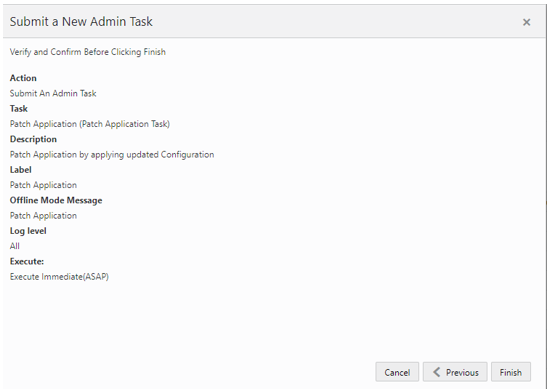

    Figure 2-10 Verify and Confirm Selections
    This figure shows the Verify and Confirm screen.

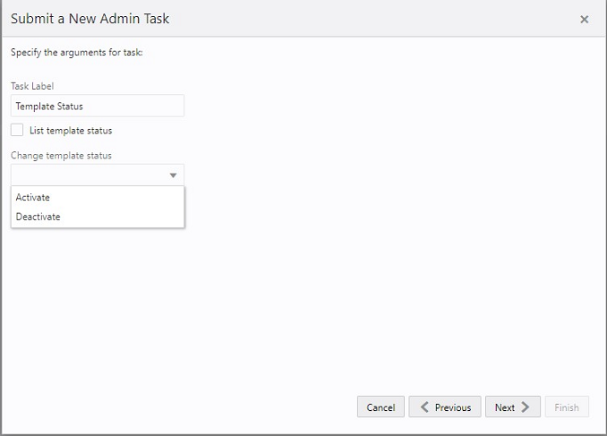

Template Status
The MFP CS application when provisioned will be deployed as a Template application with the Template status of Activated. The customer has the option to deactivate the template status meaning it is a fully custom configuration. If it is a custom configuration, the customer should upload and completely maintain the configuration. Regular upgrades or patches will not patch the application and only upgrade the server version.
The following task can be used to activate/deactivate the template status of the application. It is advisable for the customer to decide on the template status before the application is built for the first time. Later, it may be easier to convert from the template to the non-template version without any limitations. But it will not be easy to move from a non-template version to template, if the configuration does not follow the extensibility rules for the template version of MFP Configuration. See the Oracle Retail Merchandise Financial Planning Implementation Guide for extensibility guidelines for the MFP template version; only if the non-template application follows those guidelines can it be converted to template.
The Template Status changing task is available as a Bootstrap task together with Build Application. In the Change template status drop down, select the Activate or Deactivate option to toggle the template status option and submit the task to change the template status. Activate means it is a template. Deactivate means it is a custom (non-template).
The customer can also use the same task and choose List template status to view the current template status of the deployed application.
Figure 2-11 Template Status
This figure shows setting the template status.
