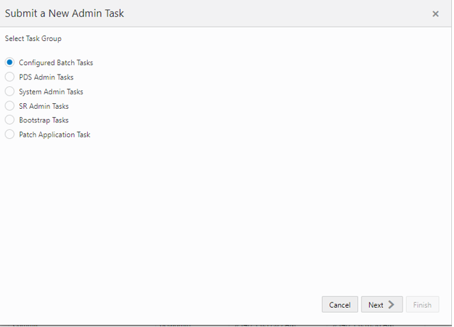

RPASCE Online Administration Tools support the scheduling of standard RPAS utilities and, in addition, scheduling application-specific services. For a detailed understanding of the Online Administration Tools, see the Oracle Retail Predictive Application Server Cloud Edition Administration Guide.
JOS/POM is used to schedule pre-configured jobs from MFPCS. Any jobs scheduled using JOS/POM from planning applications, in turn will only schedule the jobs as an OAT task which can also be monitored using OAT dashboards like any other tasks scheduled directly within the application.
The following sections explain the application-specific administration tasks that are pre-configured for MFP Cloud Service. These tasks are only applicable for Template implementations.
For non-Template type implementations, the Configured Batch Tasks can be fully configured by making changes to the batch control files. For information about changing the batch control files and how to upload them, see the Oracle Retail Predictive Application Server Cloud Edition Implementation Guide.

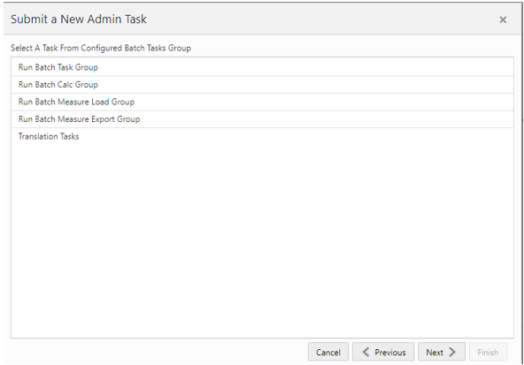

The following list shows the application-specific administration tasks that are pre-configured for MFP Cloud Service under Configured Batch Tasks:
  • Run Batch Measure Load Group
  • Run Batch Measure Export Group
  • Run Batch Calc Group
  • Run Batch Task Group

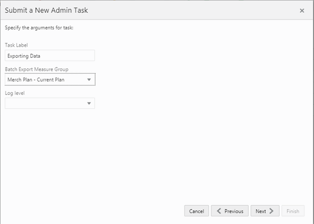

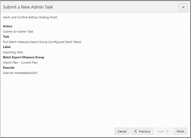

This task exports a predefined set of measure data into flat files. The predefined set of measures to be exported are defined in the batch control file batch_exportmeas_list.txt. This set of exported data can be used for integration with other applications. Typically, the data exported can be interfaced to an external database that can be used to create reports or queries by users who need Planning data. The Administrator needs to schedule the Set Export Flags under the Run Batch Calc Group task to set the required export flags before scheduling this task. Exported files for this task are put into the Object Storage location; the Administrator can download the files from this location.
The standard exports from MFP are available to the retailer to use by any downstream applications which need MFP plan data. Default approved plan standard exports are included as part of the daily and weekly batch.
The predefined options for these tasks are listed below:
  • Merch Plan - Current Plan (mpcp)
  • Merch Plan - Original Plan (mpop)
  • Merch Plan - Submitted Plan (mpwa)
  • Merch Plan - Working Plan (mpwp)
  • Merch Target - Target Plan (mttg)
  • Merch Target - Working Plan (mtwp)
  • Location Plan - Current Plan (lpcp)
  • Location Plan - Original Plan (lpop)
  • Location Plan - Working Plan (lpwp)
  • Location Target - Target Plan (lttg)
  • Location Target - Working Plan (ltwp)

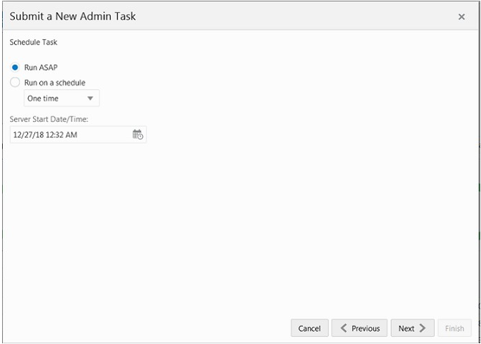

This process runs as part of a Weekly Batch. This task may be also scheduled if a retailer has data issues and needs to reload corrected actual data files in the middle of week and reprocess the week batch calculation.

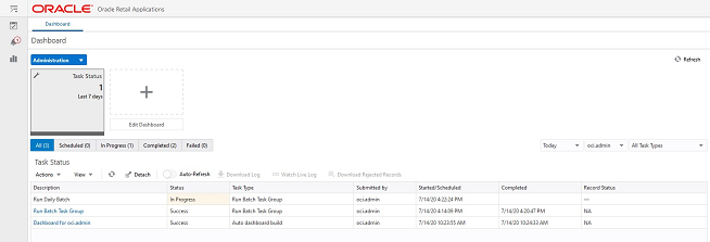

This task is used to schedule a predefined set of batch tasks such as load measure, batch calc, and batch exports in a sequential order. The batch control file batch_exec_list.txt defines the steps in the specific order that will be executed during batch task execution. This task is used to schedule a typical daily or weekly MFP Cloud Service batch. The customer may need to use this only if they are not using JOS/POM to schedule their batch jobs. If they use the JOS/POM to schedule the daily or weekly batch jobs, they in turn call this pre-configured batch task
If any task aborts, a log is created and the process terminates. This task has the option to restart from the last failed service rather than running all the completed services again.
Typically, the Administrator must schedule this task within a time frame after a domain backup and when no users are logged into the domain because this task runs in domain exclusive mode. The Administrator must work with Oracle to find out the time of backups and any other jobs.

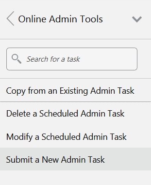

  2. In the Tasks list, select Admin Tasks for MFP CS Customer Domain and then select Online Admin Tools. Click Submit a New Admin Task.
    Figure 1-1 Administration Tasks
    This figure shows the Administration tasks.
  3. Select the Configured Batch Tasks for the Task Group and click Next.
    Figure 1-2 Select Task Group Window
    This figure shows the Select Task Group window.
  4. In the task list, select Run Measure Export Group and click Next.
    Figure 1-3 Select Task Workbook Wizard Window
    This figure shows the Select A Task From Configured Batch Tasks Group.
  5. Enter the Task Label. This task has an additional parameter to choose the export measure group. In following figure, as an example, Merch Plan - Current Plan is selected. Click Next.
    Figure 1-4 Select Export Measure Group
    This figure shows the selection of an export measure group.
  6. To schedule the task to run immediately, select Run ASAP and click Next. To run on a particular date and time, select Run on a Schedule (One time / Hourly /Daily/ Weekly/ Monthly). Provide the Server Start / Stop Date/Time and click Next.
    Figure 1-5 Schedule Task Workbook Wizard Window
    This figure shows selecting Run ASAP.
  7. In the Confirm Action window, review the task scheduling details. To confirm the scheduling and submit the task, click Finish.
    Figure 1-6 Confirm Action Window
    This figure shows the Confirm Action window.
    The task submitted confirmation message appears.

  8. To check the status of all submitted tasks in the Dashboard, click Dashboard and select Administration from the list of Dashboard Profiles in the dropdown.
    Figure 1-8 Location of Administration Dashboard Selection
    This figure shows the location of the Administration Dashboard selection.
    At the bottom of the dashboard, it contains the lists of tasks submitted and their status.
    Figure 1-9 List of Submitted Tasks
    This figure shows the list of submitted tasks.

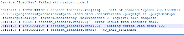

    The Status column shows whether a job has completed successfully, failed, or is pending (Scheduled). For any completed (Success/Failed) tasks, click the job name to view the subtask details if any for that job. To view the log, select the task and click Download Log. For failed tasks, the logs show the error details.
    Following is an example of a log showing an error:
    This image shows an example of a log showing an error.
    Following is an example of a log showing the cause of an error:
    This image shows an example of a log showing the cause of the error.
    The detailed log file will also be uploaded to Object Storage so the customer can download. The log file names are first appended with planning/outgoing/logs/ and with the text success/failure (with error code) along with the process name and control file entry set names and the time stamp for easy identification. For example:
    /planning/outgoing/logs/success.eebatch_calc.exp_set.20190614124917.tar.gz
    /planning/outgoing/logs/failure.13.eebatch_exec.setup.20190614043009.tar.gz

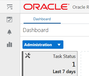

Dashboard
The Dashboard provides pre-configured dashboard profiles to the user once logged into the application. There are six profiles pre-configured for MFPCS:
  1. Administration - task status

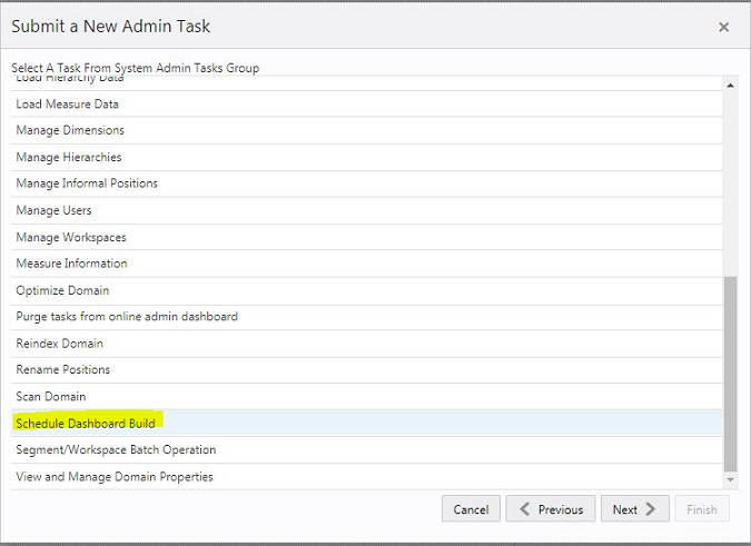

The dashboard pulls the data from an admin workbook built from the Online Administration Tools. In order to view the dashboard, an Administrator must schedule the dashboard builds from the System Admin Tasks.
Figure 1-10 Schedule Dashboard Build Task
This figure shows selecting the Schedule Dashboard Build task.

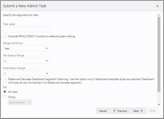

Figure 1-11 Specify Arguments for Schedule Dashboard Build Task
This figure shows specifying the arguments for the task.
  • Task Label - Enter the name of the build task to review the status of build.
  • Select Override RPAS_TODAY - Check box and then select a date, if you need to build the dashboard as of a day other than the current date.
  • Range dimension - Calendar dimension against which the dashboard will be pre-ranged.
  • Pre-Season Range - Number of periods of the Range dimension that need to be included before the Current period Range. Current Period Range will be always included.
  • Post-Season Range - Number of periods of the Range dimension that need to be included after RPAS_TODAY.
  • Select Delete and Recreate Dashboard Segment check box, only if there are any changes to the dashboard template selection after patching.
  • Users - Select All Users, Group, or Users that can access that dashboard.
For the pre-configured GA dashboard profiles, the preferred selections for Range dimension: Half, Pre-Season Range: 1, and Post-Season Range: 1.

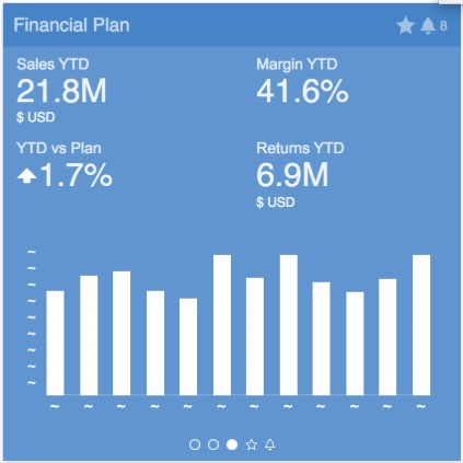

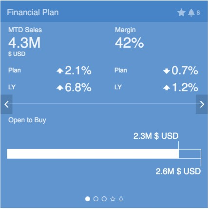

If Retail Home is configured, it provides a dashboard view of key configured metrics as tiles across multiple applications in the enterprise. MFPCS has the following tile views configured for Retail Home. The metrics are configured in the same dashboard templates, so the regular dashboard segment first should be built first, in order to see the tiles from Retail Home. Retail Home uses a different set of JSON files to get the data from the dashboard segments into these tiles. For template versions, after the domain is configured, the customer needs to seed the retail home JSON file once after Retail Home is configured. For more details about how to seed Retail Home JSON files, see the Oracle Retail Predictive Application Server Cloud Edition Administration Guide.
Figure 1-12 MFPCS Tile View for Retail Home
This figure shows an example of a tile.
Metrics shown in the above figure:
  • Month-to-Date Sales (MTD)
  • MTD Sales to Plan (OP)
  • MTD Sales variance to LY
  • MTD Margin %
  • MTD Margin variance to Plan (OP)
  • MTD Margin variance to LY
  • Open to Buy bullet chart: total is Open to Buy + Net On Order
Figure 1-13 MFPCS Tile View for Retail Home
This figure shows and example of a tile.
  • Year-to-Date Sales (YTD)
  • YTD Margin %
  • YTD Sales variance to Plan (OP)
  • YTD Returns
  • Line Chart: YTD Sales variance to Plan with X-axis as Month
