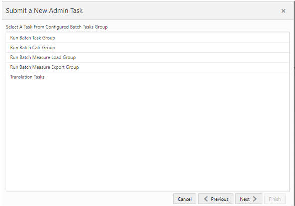

The following list shows the application-specific administration tasks that are pre-configured for MFP Cloud Service under Configured Batch Tasks:
Run Batch Measure Load Group
Run Batch Measure Export Group
Run Batch Calc Group
Run Batch Task Group

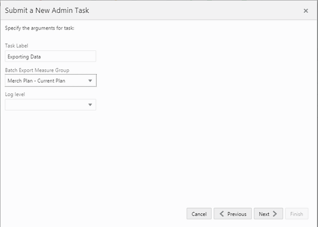

This task exports a predefined set of measure data into flat files. The predefined set of measures to be exported are defined in the batch control file batch_exportmeas_list.txt. This set of exported data can be used for integration with other applications. Typically, the data exported can be interfaced to an external database that can be used to create reports or queries by users who need Planning data. The Administrator needs to schedule the Set Export Flags under the Run Batch Calc Group task to set the required export flags before scheduling this task. Exported files for this task are put into the Object Storage location; the Administrator can download the files from this location.
The standard exports from MFP are available to the retailer to use by any downstream applications which need MFP plan data. Default approved plan standard exports are included as part of the daily and weekly batch.
The predefined options for these tasks are listed below:

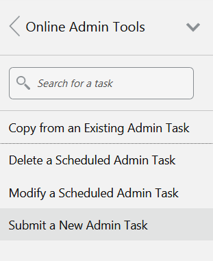

Log in to the MFP Cloud Service (mfpcs) application as an Administration user.
In the Tasks list, select Admin Tasks for MFP CS Customer Domain and then select Online Admin Tools. Click Submit a New Admin Task.

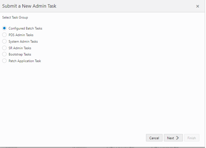

Select the Configured Batch Tasks for the Task Group and click Next.
Figure 1-2 Select Task Group Window
In the task list, select Run Measure Export Group and click Next.
Figure 1-3 Select Task Workbook Wizard Window
Enter the Task Label. This task has an additional parameter to choose the export measure group. In following figure, as an example, Merch Plan - Current Plan is selected. Click Next.
Figure 1-4 Select Export Measure Group

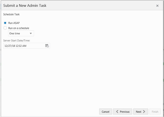

To schedule the task to run immediately, select Run ASAP and click Next. To run on a particular date and time, select Run on a Schedule (One time / Hourly /Daily/ Weekly/ Monthly). Provide the Server Start / Stop Date/Time and click Next.
Figure 1-5 Schedule Task Workbook Wizard Window

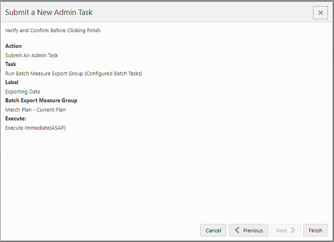

In the Confirm Action window, review the task scheduling details. To confirm the scheduling and submit the task, click Finish.
Figure 1-6 Confirm Action Window
The task submitted confirmation message appears.

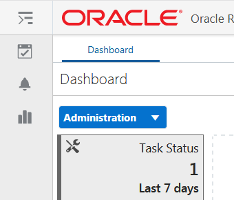

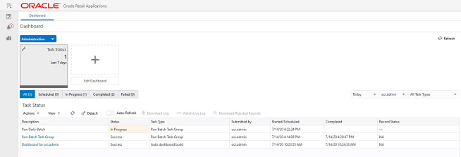

To check the status of all submitted tasks in the Dashboard, click Dashboard and select Administration from the list of Dashboard Profiles in the dropdown.
Figure 1-8 Location of Administration Dashboard Selection
At the bottom of the dashboard, it contains the lists of tasks submitted and their status.
Figure 1-9 List of Submitted Tasks

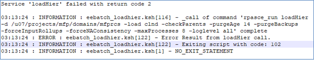

The Status column shows whether a job has completed successfully, failed, or is pending (Scheduled). For any completed (Success/Failed) tasks, click the job name to view the subtask details if any for that job. To view the log, select the task and click Download Log. For failed tasks, the logs show the error details.
Following is an example of a log showing an error:
Following is an example of a log showing the cause of an error:
The detailed log file will also be uploaded to Object Storage so the customer can download. The log file names are first appended with planning/outgoing/logs/ and with the text success/failure (with error code) along with the process name and control file entry set names and the time stamp for easy identification. For example:

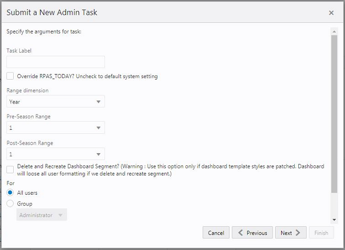

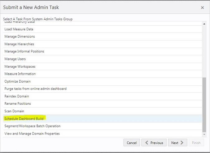

The dashboard pulls the data from an admin workbook built from the Online Administration Tools. In order to view the dashboard, an Administrator must schedule the dashboard builds from the System Admin Tasks.
Figure 1-10 Schedule Dashboard Build Task
Figure 1-11 Specify Arguments for Schedule Dashboard Build Task
Task Label - Enter the name of the build task to review the status of build.
Select Override RPAS_TODAY - Check box and then select a date, if you need to build the dashboard as of a day other than the current date.
Range dimension - Calendar dimension against which the dashboard will be pre-ranged.
Pre-Season Range - Number of periods of the Range dimension that need to be included before the Current period Range. Current Period Range will be always included.
Post-Season Range - Number of periods of the Range dimension that need to be included after RPAS_TODAY.
Select Delete and Recreate Dashboard Segment check box, only if there are any changes to the dashboard template selection after patching.
Users - Select All Users, Group, or Users that can access that dashboard.
For the pre-configured GA dashboard profiles, the preferred selections for Range dimension: Half, Pre-Season Range: 1, and Post-Season Range: 1.

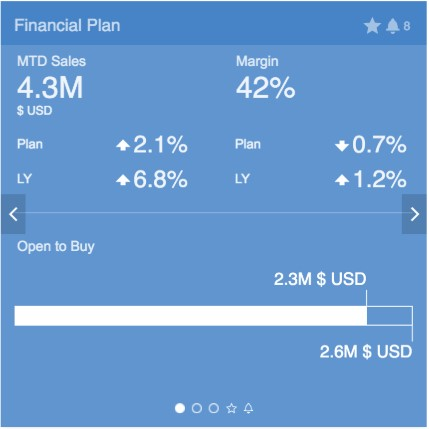

Retail Home

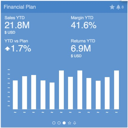

If Retail Home is configured, it provides a dashboard view of key configured metrics as tiles across multiple applications in the enterprise. MFPCS has the following tile views configured for Retail Home. The metrics are configured in the same dashboard templates, so the regular dashboard segment first should be built first, in order to see the tiles from Retail Home. Retail Home uses a different set of JSON files to get the data from the dashboard segments into these tiles. For template versions, after the domain is configured, the customer needs to seed the retail home JSON file once after Retail Home is configured. For more details about how to seed Retail Home JSON files, see the Oracle Retail Predictive Application Server Cloud Edition Administration Guide.
Figure 1-12 MFPCS Tile View for Retail Home
Metrics shown in the above figure:
Month-to-Date Sales (MTD)
MTD Sales to Plan (OP)
MTD Sales variance to LY
MTD Margin %
MTD Margin variance to Plan (OP)
MTD Margin variance to LY
Open to Buy bullet chart: total is Open to Buy + Net On Order
Figure 1-13 MFPCS Tile View for Retail Home
Year-to-Date Sales (YTD)
YTD Margin %
YTD Sales variance to Plan (OP)
YTD Returns
Line Chart: YTD Sales variance to Plan with X-axis as Month
