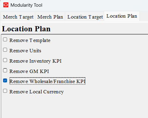

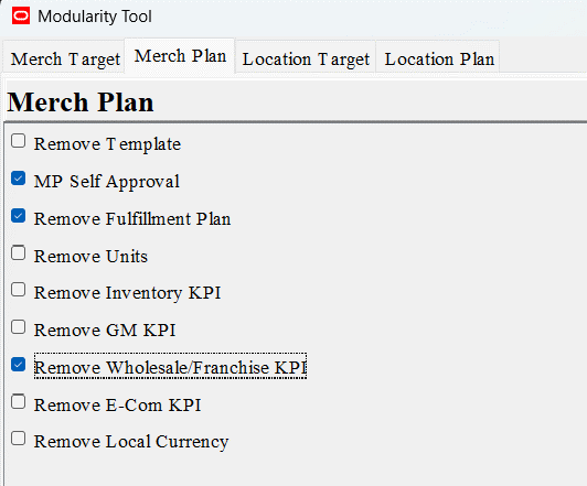

The following modules are pre-defined for GA MFP Retail solution for each template:
Figure B-2 Merch Target Module
Figure B-3 Merch Plan Module
Figure B-4 Location Target Module
Figure B-5 Location Plan Module

MP Self Approval:
This module updates the Merch Plan approval process to be a self approval process instead of submitting the plans to Merch Target approval. It updates the current Submit Plan rules to approve plan directly to CP/OP and removes Merch Target Approve Plan rules.
This modularity utility only affects the measures and rules by removing or unregistering them. It does not directly update the Workbook and Taskflow automatically. The output base configuration after running the utility requires the Implementor to update the Workbook and Taskflow level modification as part of the customization.

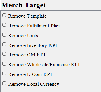

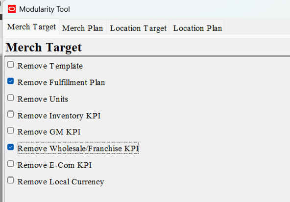

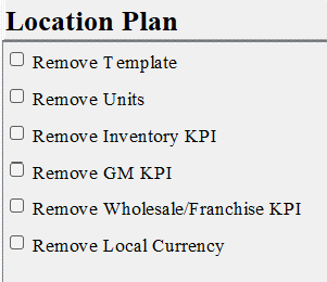

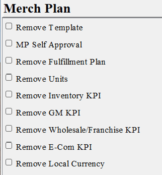

Select the modules to apply against the GA configuration from the pop-up UI for each template to satisfy the requirements for the new base configuration.
Figure B-6 Merch Target Module
Figure B-7 Merch Plan Module
Figure B-8 Location Plan Module

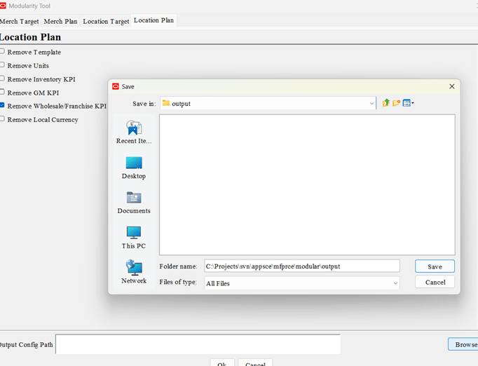

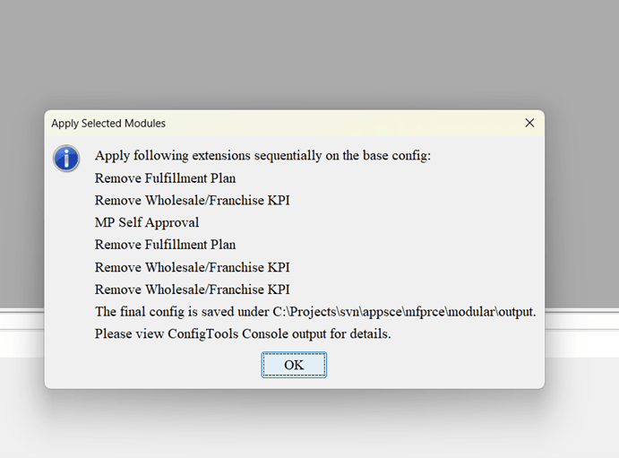

Once the modules are selected, specify the output directory for the new base configuration. Click OK after you review the Apply Selected Modules.
Figure B-9 Specify the Output Directory
Figure B-10 Confirm the Selected Modules
Open the new base configuration from the output saved directory and check to see if any errors or warnings exist under the Task List. No errors or warnings means that the modularity tool successfully updated the measures and rules associated with the selected modules.

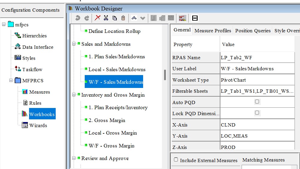

The following workbook level updates are just a recommendation and it is up to the Implementor and customer to update accordingly with the labels and views required for the customer. This new simplified configuration is now the base configuration for the customer to build their custom logic and functionality on top to meet their business needs.

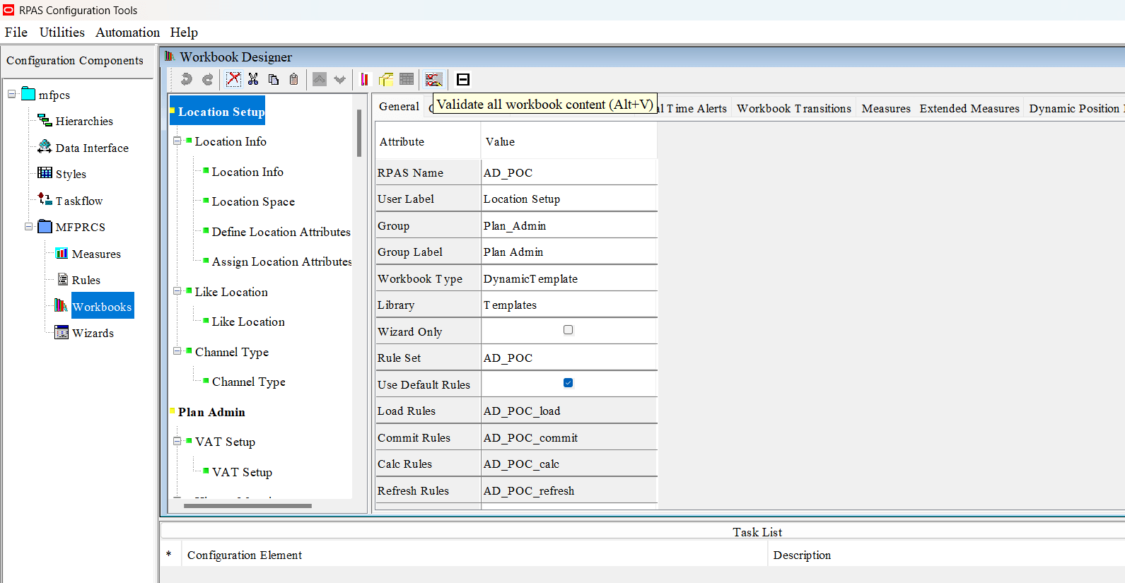

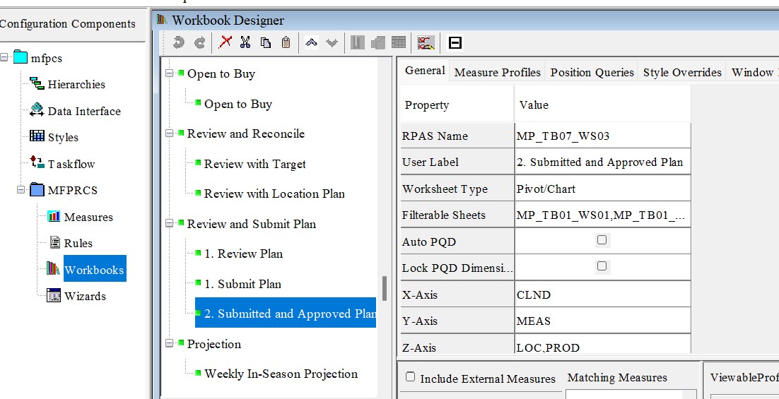

Under Workbook Designer, click the Validate all Workbook Content icon that provides all errors and warnings associated with the workbook templates. This provides descriptions of all template level errors that needs to be resolved; such as a potential error that could be unregistered measures not cleared from the worksheet view that must be manually removed or unregistered measures impacting the workbook properties like real time alerts or extended measures. .
Figure B-12 Check for any Worksheet Errors in the Task List

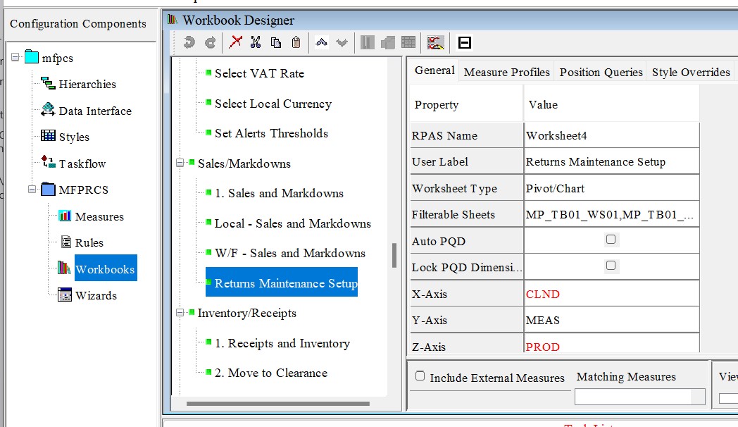

In the previous use case example, remove worksheets if associated with the module applied, such as Remove of Fulfillment and Wholesale/Franchise. These worksheets should be removed from the template or taskflow.
Figure B-13 Remove Worksheets
Figure B-14 Remove Worksheets from the Template or Taskflow

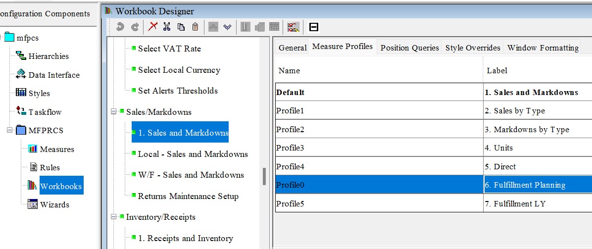

Additionally, check the Worksheet Measure Profile tab to make sure that no specific profile exists. Remove any existing profiles.
Figure B-15 Verify that No Specific Profile Exists

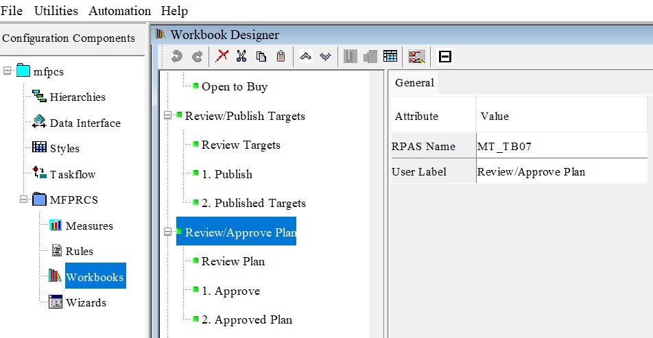

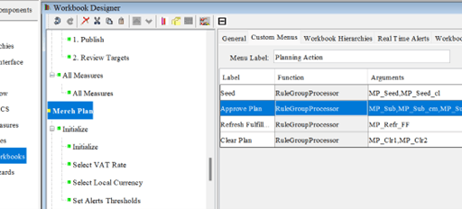

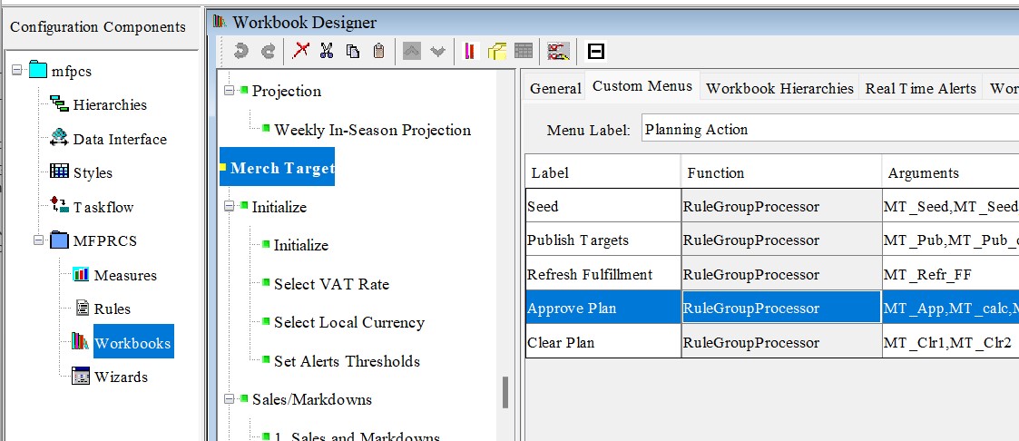

The Merch Plan Self Approval module is more complex in that it affects the custom menu rule groups and require more in-depth updates to the Workbooks within Merch Plan and Merch Target templates as follows.
In the Workbook Designer, navigate to Merch Target and then Custom Menus. Remove Approve Plan since the Merch Plan approval is self-approval.
Figure B-16 Remove Approve Plan

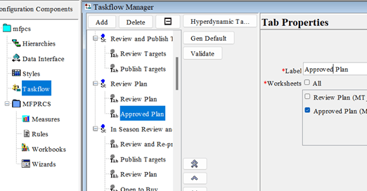

Update the Merch Target Taskflow label from Review and Approve Plan to Review Plan.
Figure B-18 Update the Merch Target Taskflow Label
In the Workbook Designer, navigate to Merch Plan and then Custom Menus. Change Submit Plan to Approve Plan.
Figure B-19 Update the Merch Target Taskflow Label
