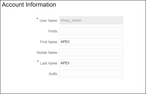

Before you can log in to Oracle APEX for the first time, you must set up the login details for the APEX workspace administrator. A Retail Workspace Administrator (rtlwsp_admin) account has been created during AI Foundation provisioning. This has the necessary privileges within the APEX workspace. However, since this APEX instance uses header authentication, an IAM entry will need to be created for this username as a one-time activity. Login to IAM as an administrator, create a new user, and set the information as shown below.
User Name: rtlwsp_admin
First/Last Name: APEX
Password: <use any password meeting your security requirements>
Figure 10-1 APEX User Setup in IAM

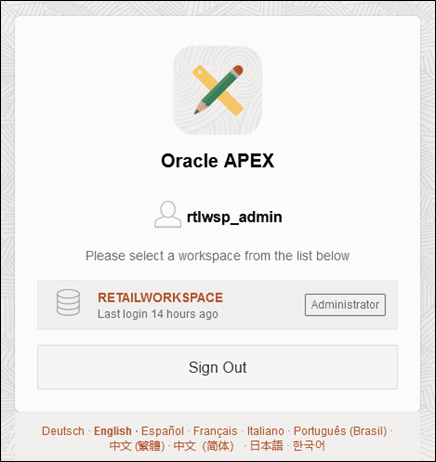

Depending on your APEX version, you will see either an ORDS Landing Page or an APEX welcome screen. If you are shown the ORDS Landing Page, click the Go button below the Oracle APEX header, which takes you to the APEX welcome screen. From there, you must select an available workspace to continue.
Figure 10-2 APEX Workspace Pre-Authenticated Login

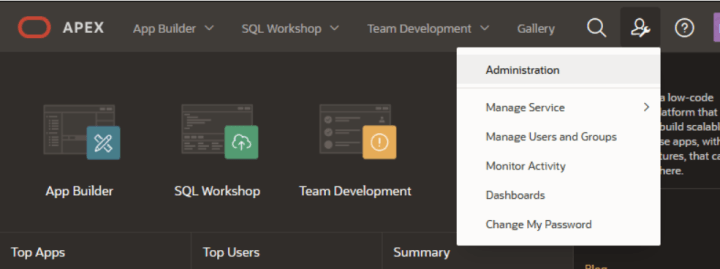

  1. From the APEX start page, access the Administration menu in the upper right corner and select the Manage Users and Groups option.
    Manage Users and Groups Menu Option

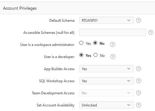

  4. Under Account Privileges, select whether the User is a workspace administrator or the User is a developer.
    If neither option is selected, then the user will not have the ability to create anything in APEX but may be able to access applications that are already created.
    Account Privileges
