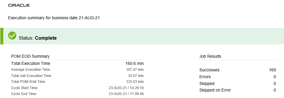

The primary source of information about the batch status on a daily basis will be the email notifications sent from POM for every batch execution. These emails will contain a summary of the batch status, the longest-running jobs, the total batch duration, and other useful details to help you assess the state of the current batch cycle. To keep the business up-to-date on batch execution status and take action in the case of batch failures, the designated administrators for the Retail Analytics Platform applications will be expected to receive and review these emails regularly after going live in a production environment.
Figure 3-1 POM Sample Batch Notification
Each batch schedule in POM issues its email notifications. Additionally, POM supports numerous notification types for specific use cases, such as individual job failures and long-running processes. Customers are expected to set up local mailing lists which can receive automated messages from Oracle Cloud applications. To change the recipients on an email notification, access the Notifications interface in Retail Home. Follow these steps to add or update a notification:

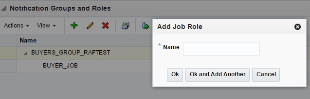

  6. Click Add Job Role in the Notification Groups table to add valid roles to the new notification group. Notifications of this type show up for users with these roles within the Notification Panels throughout Oracle Retail applications.
  7. Enter a valid role name (for example, BUYER_JOB) to issue the notifications to all users having that role.
    Add Job Role Window
Repeat these steps for as many POM notification types as you wish to receive.
