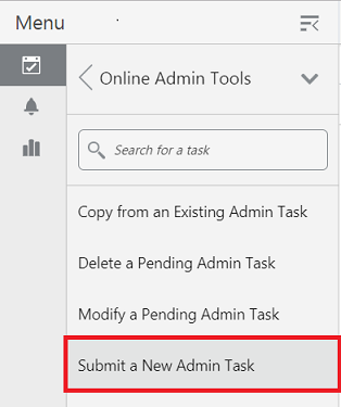

RPASCE Online Administration Tools support the scheduling of standard RPASCE utilities and, in addition, scheduling application-specific services. For a detailed understanding of the Online Administration Tools, see the Oracle Retail Predictive Application Server Cloud Edition Administration Guide.
JOS/POM is used to schedule pre-configured jobs from APCS. Any jobs scheduled using JOS/POM from planning applications, in turn will only schedule the jobs as an OAT task which can also be monitored using OAT dashboards like any other tasks scheduled directly within the application.

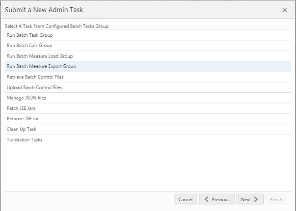

The following list shows the application-specific administration tasks that are pre-configured for AP Cloud Service under Configured Batch Tasks:
                        Run Batch Measure Load Group
                        Run Batch Measure Export Group
                        Run Batch Calc Group
                        Run Batch Task Group
These batch tasks are explained in detail in subsequent sections. There are some additional tasks available under Configured Batch Tasks which are generic RPASCE-specific tasks. Details about the RPASCE-specific tasks can be found in the Batch Administration section in the Oracle Retail Predictive Application Server Cloud Edition Administration Guide.

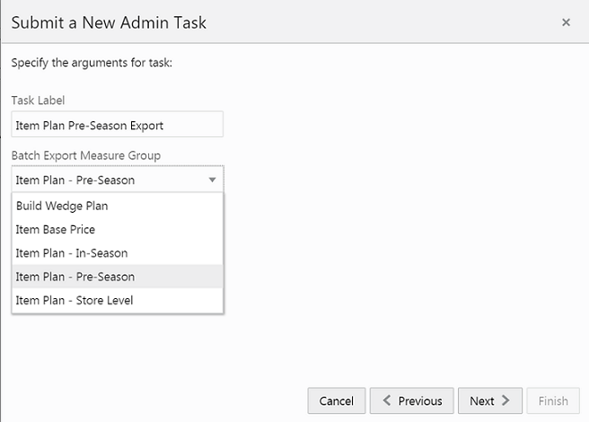

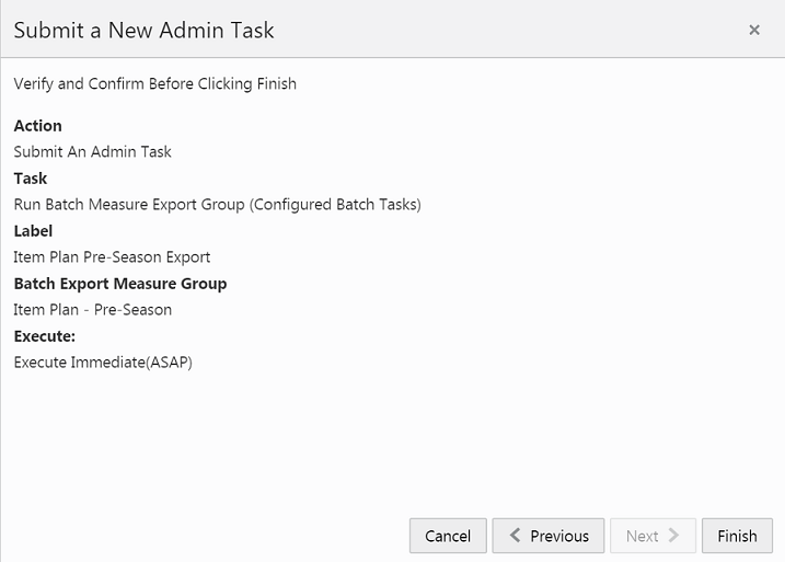

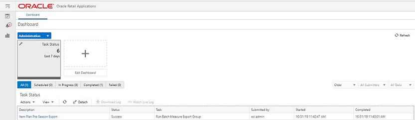

This task exports a predefined set of measure data into flat files. The predefined set of measures to be exported are defined in the batch control file batch_exportmeas_list.txt. This set of exported data can be used for integration with other applications. Typically, the data exported can be interfaced to an external database that can be used to create reports or queries by users who need Planning data. The Administrator needs to schedule the Set Export Flags under the Run Batch Calc Group task to set the required export flags before scheduling this task. Exported files for this task are put into the Object Storage location; the Administrator can download the files from this location.
The standard exports from APCS are available to the retailer to use by any downstream applications which need APCS plan data. Default approved plan standard exports are included as part of the daily and weekly batch.
The predefined options for these tasks are listed below:
                           Item Plan - Pre-Season (ip_ipop)
                           Item Plan - In-Season (ip_ipcp)
                           Item Plan - OTB (ip_otb)
                           Item Base Price (as_sprc)
For details about the different versions for export, the list of measures exported in each file, and the file name and format details, see the Oracle Retail Assortment Planning Cloud Service Implementation Guide.

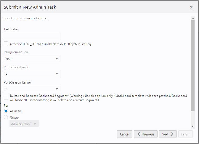

                           Rebuild Dashboard (batch_dash)

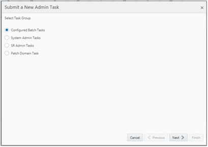

To schedule and monitor a Configured Batch Administration task:
                        Log in to the APCS application as an Administration user.

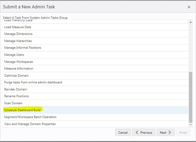

                        In the Tasks list, select Admin Tasks for AP CS Customer Domain and then select Online Admin Tools. Click Submit a New Admin Task. Figure 1-1 Administration Tasks
                        Select the Configured Batch Tasks for the Task Group and click Next. Figure 1-2 Select Task Group Window
                        In the task list, select Run Measure Export Group and click Next. Figure 1-3 Select Task Workbook Wizard Window
                        Enter the Task Label. This task has an additional parameter to choose the export measure group. In following figure, as an example, Item Plan - Pre-Season is selected. Click Next. Figure 1-4 Select Export Measure Group

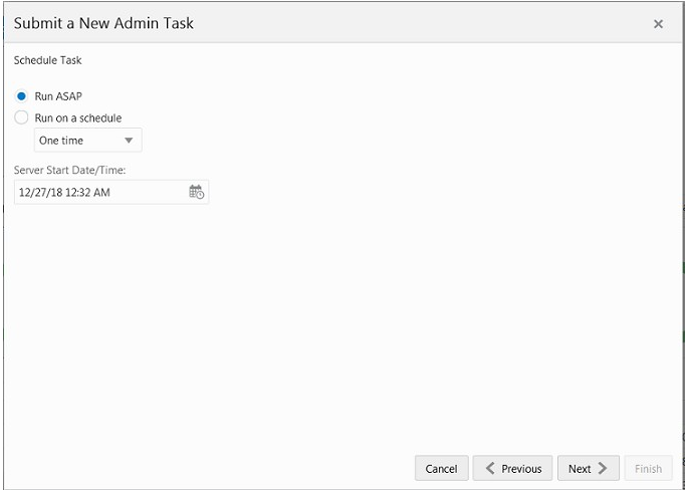

                        To schedule the task to run immediately, select Run ASAP and click Next. To run on a particular date and time, select Run on a Schedule (One time / Hourly /Daily/ Weekly/ Monthly). Provide the Server Start / Stop Date/Time and click Next. Figure 1-5 Schedule Task Workbook Wizard Window
                        In the Confirm Action window, review the task scheduling details. To confirm the scheduling and submit the task, click Finish. Figure 1-6 Confirm Action Window  The task submitted confirmation message appears. Figure 1-7 Task Submitted Confirmation Message

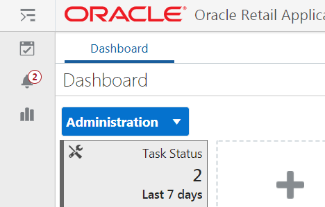

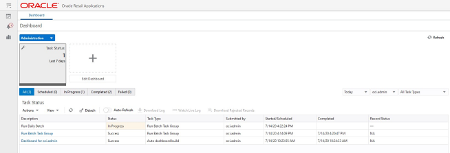

                        To check the status of all submitted tasks in the Dashboard, click Dashboard and select Administration from the list of Dashboard Profiles in the dropdown. Figure 1-8 Location of Administration Dashboard Selection  At the bottom of the dashboard, it contains the lists of tasks submitted and their status. Figure 1-9 List of Submitted Tasks  The Status column shows whether a job has completed successfully, failed, or is pending (Scheduled). For any completed (Success/Failed) tasks, click the job name to view the subtask details if any for that job. To view the log, select the task and click Download Log. For failed tasks, the logs show the error details. Following is an example of a log showing an error:  Following is an example of a log showing the cause of an error:  Note: The detailed log file will also be uploaded to Object Storage so the customer can download. The log file names are first appended with planning/outgoing/logs/ and with the text success/failure (with error code) along with the process name and control file entry set names and the time stamp for easy identification. For example: /planning/outgoing/logs/success.eebatch_calc.exp_set.20190614124917.tar.gz /planning/outgoing/logs/failure.13.eebatch_exec.setup.20190614043009.tar.gz
Dashboard

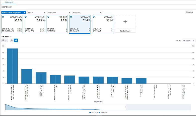

The Dashboard provides pre-configured dashboard profiles to the user once logged in to the application. If the user is logged in with administrator access, they will also see the Administration tasks status board as one of the profiles, which shows the scheduled batch job status.
Figure 1-10 Dashboard - Administration Tasks Status

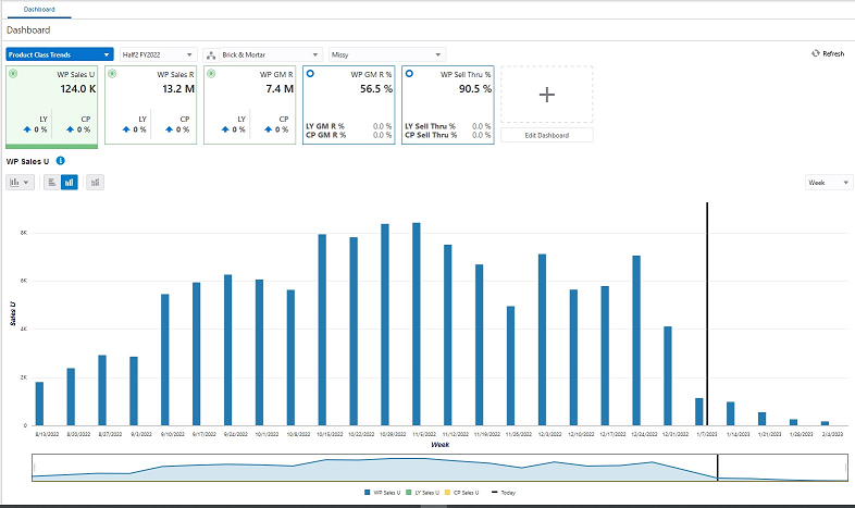

There are four additional dashboard profiles pre-configured for APCS as specified below. In APCS, users need to set the Key Item selection criteria for their classes in the Admin setup. The daily batch will rank and select the predefined set of items to be shown in the subsequent dashboard build. For more details about the dashboard, see the Oracle Retail Assortment Planning Cloud Service User Guide.

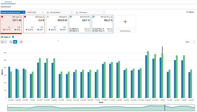

                        Weekly Trends (Key Items): This shows the performance of key items at the week level as different metric tiles. Figure 1-11 Dashboard - Weekly Trends (Key Items)
                        Product Trends (Key Items): This shows the same key items to view sorted based on Item Performance. Figure 1-12 Dashboard - Product Trends (Key Items)
                        Product Class Trends: This shows the class level performance of all items at the week level as different metric tiles. Figure 1-13 Dashboard - Product Class Trends

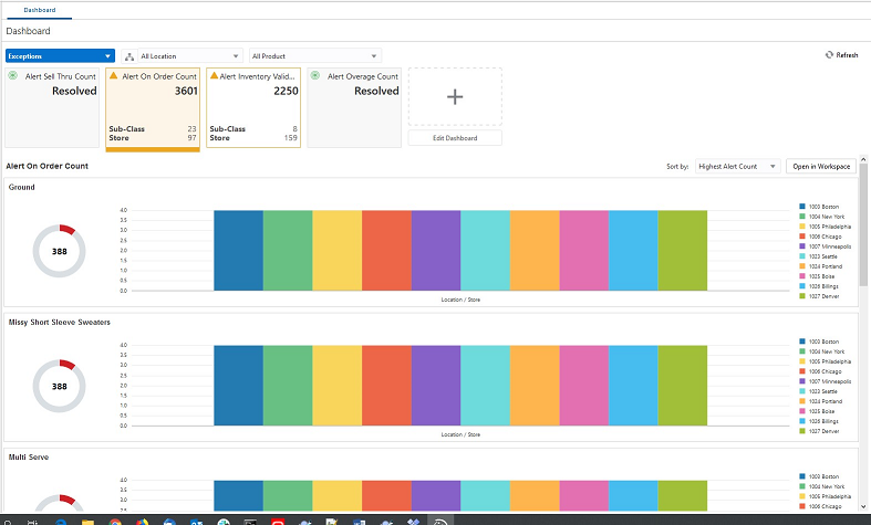

                        Exceptions: Pre-configured exception alert metric tiles based on the selected key items. Figure 1-14 Dashboard - Exceptions  The dashboard pulls the data from an admin workbook built from the Online Administration Tool. In order to view the dashboard, an Administrator must schedule the dashboard workbooks from the System Admin Tasks.
Figure 1-15 Schedule Dashboard Build Task
Figure 1-16 Specify Arguments for Schedule Dashboard Build Task
                        Task Label - Enter the name of the build task to review the status of build.
                        Select Override RPAS_TODAY - Check the box and then select a date, if you need to build the dashboard as of a day other than the current date.
                        Range dimension - Calendar dimension against which the dashboard will be pre-ranged.
                        Pre-Season Range - Number of periods of the Range dimension that need to be included before the Current period Range. Current Period Range will be always included.
                        Post-Season Range - Number of periods of the Range dimension that need to be included after RPAS_TODAY.
                        Select Delete and Recreate Dashboard Segment check box, only if there are any changes to the dashboard template selection after patching.
                        Users - Select All Users, Group, or Users that can access that dashboard.
For the pre-configured GA dashboard profiles, the preferred selections for Range dimension: Half, Pre-Season Range: 0, and Post-Season Range: 1.
