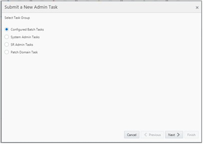

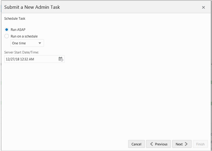

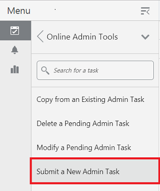

RPASCE Online Administration Tools support the scheduling of standard RPASCE utilities and, in addition, scheduling application-specific services. For a detailed understanding of the Online Administration Tools, see the Oracle Retail Predictive Application Server Cloud Edition Administration Guide.
JOS/POM is used to schedule pre-configured jobs from APCS. Any jobs scheduled using JOS/POM from planning applications, in turn will only schedule the jobs as an OAT task which can also be monitored using OAT dashboards like any other tasks scheduled directly within the application.
The following sections explain the application-specific administration tasks that are pre-configured for AP Cloud Service. These tasks are only applicable for Template implementations.
For non-Template type implementations, the Configured Batch Tasks can be fully configured by making changes to the batch control files. For information about changing the batch control files and how to upload them, see the Oracle Retail Predictive Application Server Cloud Edition Implementation Guide.
Customers using Template versions can also customize the tasks by changing the control files as part of the extensibility. For allowed changes, see the Oracle Retail Assortment Planning Cloud Service Implementation Guide.

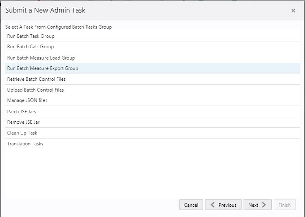

The following list shows the application-specific administration tasks that are pre-configured for AP Cloud Service under Configured Batch Tasks:
  • Run Batch Measure Load Group
  • Run Batch Measure Export Group
  • Run Batch Calc Group
  • Run Batch Task Group
These batch tasks are explained in detail in subsequent sections. There are some additional tasks available under Configured Batch Tasks which are generic RPASCE-specific tasks. Details about the RPASCE-specific tasks can be found in the Batch Administration section in the Oracle Retail Predictive Application Server Cloud Edition Administration Guide.

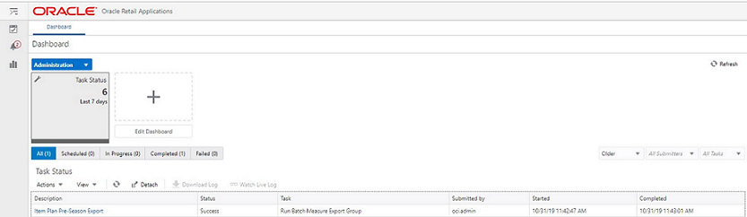

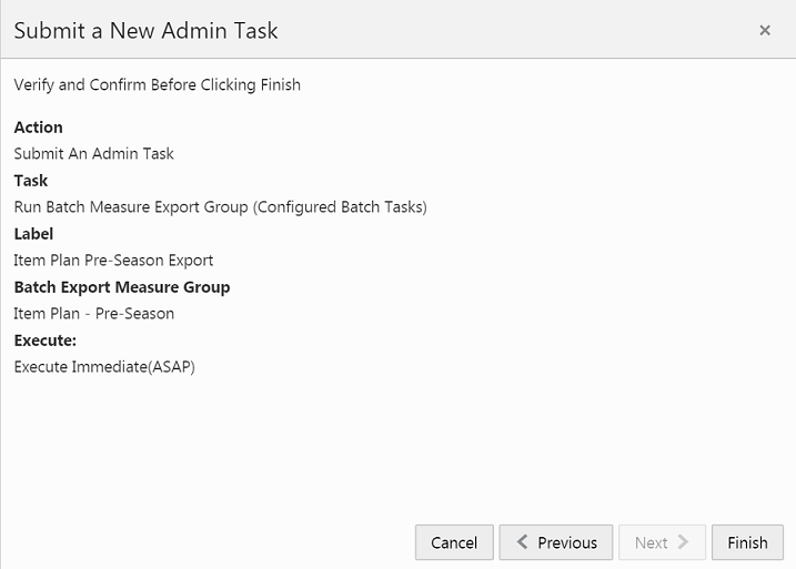

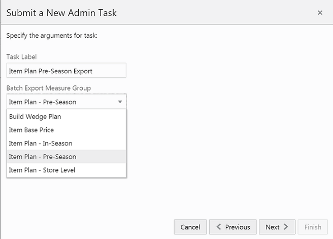

This task exports a predefined set of measure data into flat files. The predefined set of measures to be exported are defined in the batch control file batch_exportmeas_list.txt. This set of exported data can be used for integration with other applications. Typically, the data exported can be interfaced to an external database that can be used to create reports or queries by users who need Planning data. The Administrator needs to schedule the Set Export Flags under the Run Batch Calc Group task to set the required export flags before scheduling this task. Exported files for this task are put into the Object Storage location; the Administrator can download the files from this location.
The standard exports from APCS are available to the retailer to use by any downstream applications which need APCS plan data. Default approved plan standard exports are included as part of the daily and weekly batch.
The predefined options for these tasks are listed below:
  • Item Plan - Pre-Season (ip_ipop)
  • Item Plan - In-Season (ip_ipcp)
  • Item Plan - OTB (ip_otb)
  • Item Base Price (as_sprc)
For details about the different versions for export, the list of measures exported in each file, and the file name and format details, see the Oracle Retail Assortment Planning Cloud Service Implementation Guide.

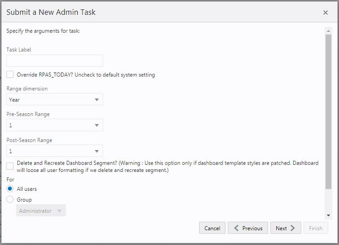

This task is used to schedule a predefined set of batch tasks such as load measure, batch calc, and batch exports in a sequential order. The batch control file batch_exec_list.txt defines the steps in specific order that will be executed during batch task execution. This task is used to schedule a typical daily or weekly APCS batch. If any task aborts, a log is created and the process terminates. This task has the option to restart from the last failed service rather than running all the completed services again.
Typically, the user must schedule this task within a time frame after a domain backup and when no users are logged into the domain, because this task runs in domain exclusive mode. The administrator must work with Oracle to find out the time of backups and any other jobs.
The following predefined batch sets are available. A few configured tasks below can call another configured batch task recursively:

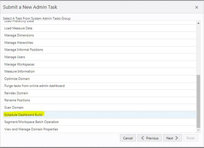

  • Formalize Hierarchies (form_hier)
  • Rebuild Dashboard (batch_dash)
  • Post Build Batch (postbuild)
  • Post Build Hierarchy (post_hier)
  • Post Build Patch (postpatch)
  • Export for Egress (exp_egr)

  1. Log in to the APCS application as an Administration user.
  2. In the Tasks list, select Admin Tasks for AP CS Customer Domain and then select Online Admin Tools. Click Submit a New Admin Task.
    Figure 1-1 Administration Tasks
    This figure shows the Administration tasks.
  3. Select the Configured Batch Tasks for the Task Group and click Next.
    Figure 1-2 Select Task Group Window
    This figure shows the Select Task Group window.
  4. In the task list, select Run Measure Export Group and click Next.
    Figure 1-3 Select Task Workbook Wizard Window
    This figure shows the Select A Task From Configured Batch Tasks Group.
  5. Enter the Task Label. This task has an additional parameter to choose the export measure group. In following figure, as an example, Item Plan - Pre-Season is selected. Click Next.
    Figure 1-4 Select Export Measure Group
    This figure shows the selection of an export measure group.
  6. To schedule the task to run immediately, select Run ASAP and click Next. To run on a particular date and time, select Run on a Schedule (One time / Hourly /Daily/ Weekly/ Monthly). Provide the Server Start / Stop Date/Time and click Next.
    Figure 1-5 Schedule Task Workbook Wizard Window
    This figure shows selecting Run ASAP.
  7. In the Confirm Action window, review the task scheduling details. To confirm the scheduling and submit the task, click Finish.
    Figure 1-6 Confirm Action Window
    This figure shows the Confirm Action window.
    The task submitted confirmation message appears.
    Figure 1-7 Task Submitted Confirmation Message
    This figure shows the confirmation message for a submitted task.

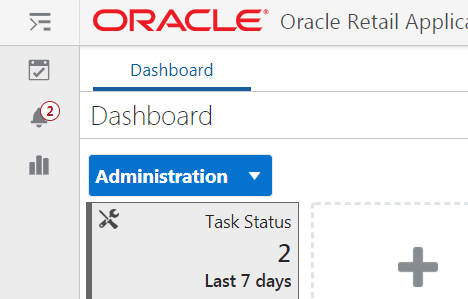

  8. To check the status of all submitted tasks in the Dashboard, click Dashboard and select Administration from the list of Dashboard Profiles in the dropdown.
    Figure 1-8 Location of Administration Dashboard Selection
    This figure shows the location of the Administration Dashboard selection.

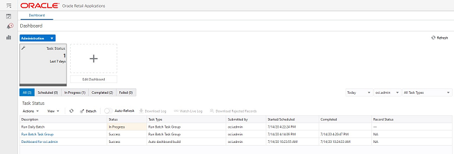

    At the bottom of the dashboard, it contains the lists of tasks submitted and their status.
    Figure 1-9 List of Submitted Tasks
    This figure shows the list of submitted tasks.
    The Status column shows whether a job has completed successfully, failed, or is pending (Scheduled). For any completed (Success/Failed) tasks, click the job name to view the subtask details if any for that job. To view the log, select the task and click Download Log. For failed tasks, the logs show the error details.

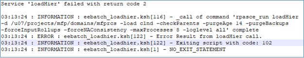

    Following is an example of a log showing an error:
    This image shows an example of a log showing an error.
    Following is an example of a log showing the cause of an error:
    This image shows an example of a log showing the cause of the error.
    The detailed log file will also be uploaded to Object Storage so the customer can download. The log file names are first appended with planning/outgoing/logs/ and with the text success/failure (with error code) along with the process name and control file entry set names and the time stamp for easy identification. For example:

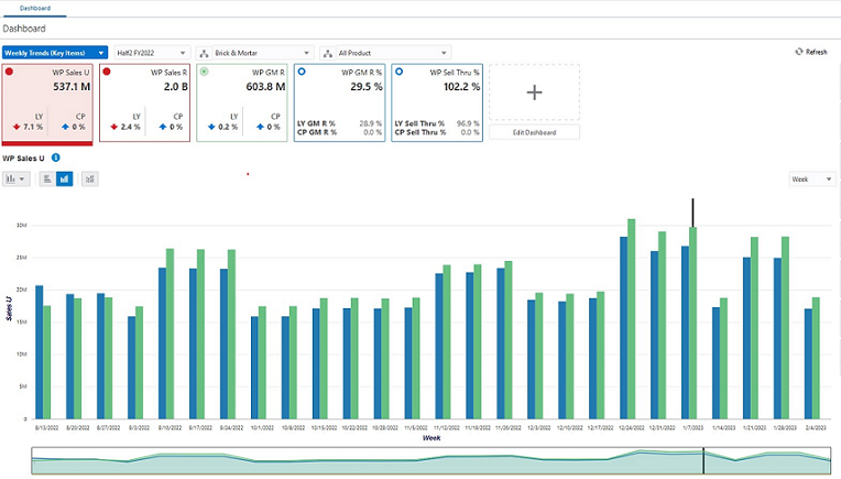

  1. Weekly Trends (Key Items): This shows the performance of key items at the week level as different metric tiles.
    Figure 1-11 Dashboard - Weekly Trends (Key Items)
    This figure shows weekly trends.

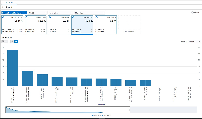

  2. Product Trends (Key Items): This shows the same key items to view sorted based on Item Performance.
    Figure 1-12 Dashboard - Product Trends (Key Items)
    This figures show product trends

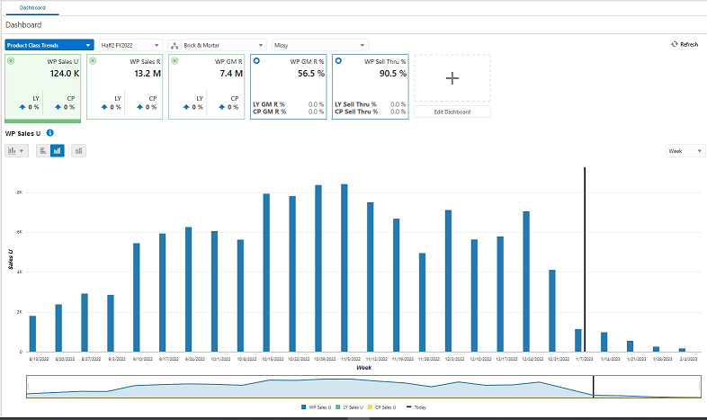

  3. Product Class Trends: This shows the class level performance of all items at the week level as different metric tiles.
    Figure 1-13 Dashboard - Product Class Trends
    This figure shows product class trends.

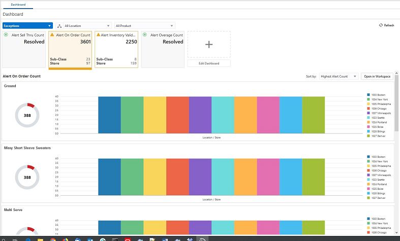

  4. Exceptions: Pre-configured exception alert metric tiles based on the selected key items.
    Figure 1-14 Dashboard - Exceptions
    This image shows exceptions.
    The dashboard pulls the data from an admin workbook built from the Online Administration Tool. In order to view the dashboard, an Administrator must schedule the dashboard workbooks from the System Admin Tasks.
Figure 1-15 Schedule Dashboard Build Task
This figure shows selecting the Schedule Dashboard Build task.
Figure 1-16 Specify Arguments for Schedule Dashboard Build Task
This figure shows specifying the arguments for the task.
  • Task Label - Enter the name of the build task to review the status of build.
  • Select Override RPAS_TODAY - Check the box and then select a date, if you need to build the dashboard as of a day other than the current date.
  • Range dimension - Calendar dimension against which the dashboard will be pre-ranged.
  • Pre-Season Range - Number of periods of the Range dimension that need to be included before the Current period Range. Current Period Range will be always included.
  • Post-Season Range - Number of periods of the Range dimension that need to be included after RPAS_TODAY.
  • Select Delete and Recreate Dashboard Segment check box, only if there are any changes to the dashboard template selection after patching.
  • Users - Select All Users, Group, or Users that can access that dashboard.
