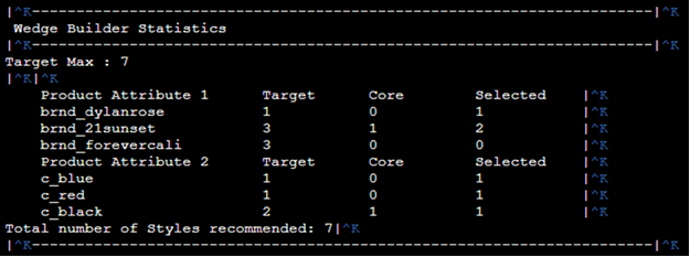

AssortmentFitExpr - Assortment Fit Wedge Builder Expression
The Wedge Builder special expression provides an assortment of styles, based on the Target Attribute mix, style status, style score, and attribute score. The algorithm only considers style colors that are present in the shopping list.
Interface:
WEDGE <- AssortmentFitExpr(MASK, SHOP_LIST, PROD_ATTR, PATR_ONE, PATR_TWO, PATR_THREE, PATR_FOUR, PATR_FIVE,TARGET_MAX, TARGET_PATR_MIX,PROD_SCORE, WEDGE_CORE)
Example:
WEDGE:TRDVAsrtSkupB <- AssortmentFitExpr(MASK:BWWPSdAFB, SHOP_LIST:TRDVOptnB, PROD_ATTR: TRDVPrdAttT, PATR_ONE: TRDVPAtt1T, PATR_TWO: TRDVPAtt2T, PATR_THREE: TRDVPAtt3T, PATR_FOUR: TRDVPAtt4T, PATR_FIVE: TRDVPAtt5T, TARGET_MAX: TRCAOptnMx, TARGET_PATR_MIX: TRCAOptnCt,PROD_SCORE: AIDVOptnRnkV,WEDGE_CORE: TRDVIntentB)
WEDGE: The populated styles in the Wedge based on the Target Attribute Mix. This is the output.
Inputs:
MASK: User-defined trigger for the algorithm to recommend the wedge per buying period/subclass/store cluster.
SHOP_LIST: The styles to be considered to be part of the wedge.
WEDGE_CORE: Mandatory item.
PROD_ATTR: Measure that stores the association of styles with their corresponding attributes.
PATR_ONE, PATR_TWO, PATR_THREE, PATR_FOUR, PATR_FIVE: Up to five product attributes can be selected to build the wedge.
TARGET_MAX: Total # of style-colors for assort period/subclass/store cluster.
TARGET_PATR_MIX: Measure that defines the Target Attribute mix.
PROD_SCORE: Each style color has a score. (Lower the better).
Intersections:
(skup/strc) - WEDGE, PROD_SCORE, SHOP_LIST, WEDGE_CORE
(patt/skup/strc) - PROD_ATTR
(scls/strc) - MASK, PATR_ONE, PATR_TWO, PATR_THREE.., TARGET_MAX
(scls/strc/patv)- TARGET_PATR_MIX

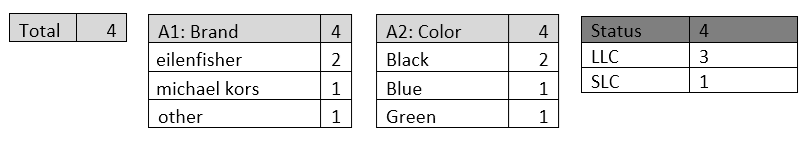

Following is the high-level process used in the above procedure:
- Based on Target attribute mix, the attribute values are ranked in descending order for each attribute.
- Find the common styles among all enabled attributes. (maximum of five).
- Among the common styles, select based on the item ranking.
Example:
- First, the individual attribute value mix is sorted in ascending order, so that all attributes are considered.
- Next, find the styles with common intersection among all five attributes in order of product attribute priority.
- If the available styles are more than the required, select styles based on the item ranking.
- When finding a common set, if the brand1 target is not reached, move it to brand2.
- If the target max has not been achieved, check the individual attribute values per attribute type.
- Once the target mix of brand is achieved but not the target max, check Color (Green).
- Once all the attributes have been gone through and the target max is still not reached, select based on the item ranking.

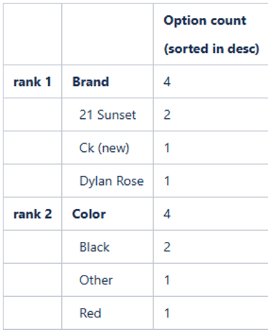

Based on the above example, the attributes will be sorted in this order:
Brand: CK, Dylan Rose, 21 Sunset
Color: Red, Black
The procedure will iterate in this order to find the common items.
