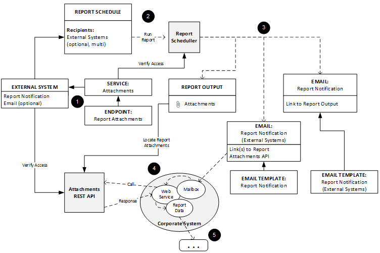

The following diagram describes the stages of the process for using the Report Attachment API to retrieve a report output.
Figure C-1 Process Flow for Using the Report Attachment API
To access the Report Attachment API, the external system must be registered in Brand Compliance as an External System with the ATTACHMENT service, the REPORT_ATTACHMENT_GET endpoint, and an email address assigned.
When a report is scheduled, the external system is selected as a recipient.
When the report runs, if the recipient is an external system, an email is sent containing a link to the report output attachment (may be more than one if multiple formats have been selected).
In order to prevent the URI to the Attachment record being predictable, a 32-character non-sequential globalId key is used.
The template of the REPORTNOTIFICATION email may be configured in the Brand Compliance Admin area; the default content is:
Subject:
Report [Report Name] is ready to view
Body:
The report [Report Name] has been created.
Use the following link(s) to retrieve the attachment data from the attachment API.
File name: [File Name].[File Type] [Link to Report Attachments API] File name: [File Name] File Type: [File Type] [Link to Report Attachments API]
The external system initiates the call to the Report Attachment API. This may be triggered automatically on receipt of the email, or could be triggered by another event, by a scheduled job, or by a manual user action.
The external system processes the returned messages and report attachment data according to its intended purpose. The data must first be decoded from Base64 encoding.
