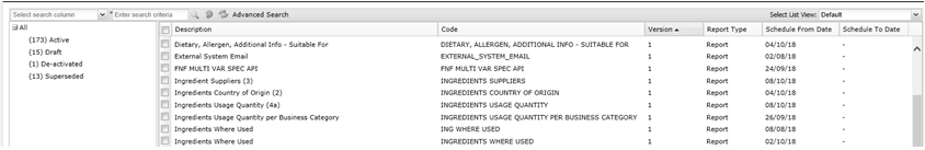

To access the Report Schedules, select the Report Schedules option in the Reports navigation menu.
The list of report schedules is displayed, grouped by status. A single Default list view is provided, plus My Report Schedules (those the user has scheduled) and Associated Report Schedules (those the user is a recipient of.) For each schedule, the code, version, description, report type, and scheduled from/to dates are shown.
Figure 5-1 Report Schedules Page
To see the details for a specific schedule, double-click the row. A tab opens with the details. You can also select the View or Edit actions.

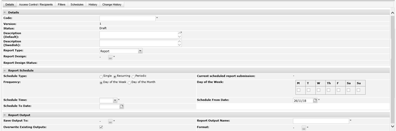

To create a new report schedule:
Select the New action. The New Report Schedule page appears.
Enter the details.
Save the changes and exit.

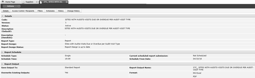

Report Schedule Details Tab
Figure 5-2 Report Schedule Details Page

Table 5-2 New Report Schedule Page - Report Schedule
| Details | Description |
Schedule Type |
Select whether the report is to run as a single instance, or on a recurring or periodic schedule. The default option is Single. If set to Single, the report will run once on the specified date and time. In this case, the recurring and periodic fields are hidden. If set to Recurring, the report will run repeatedly on a selected day of the week or day of the month (within a date range if one is specified) at a given time. In this case, the periodic fields are hidden. If set to Periodic, the report will run repeatedly every x weeks or months (within a date range if one is specified) at a given time. In this case, the recurring fields are hidden. |
Recurring Frequency |
If the schedule type is recurring, select the frequency the report is to be run. The options are to repeatedly schedule the report by days of the week, or by days of the month. The default option is day of the week. The field is hidden unless the schedule type is Recurring. |
Day of the Week |
If the schedule type is recurring and the recurring frequency is days of the week, select the days of the week on which the report is to run. Mandatory field. The field is hidden unless the schedule type is Recurring and the recurring frequency is days of the week. |
Day of the Month |
If the schedule type is recurring and the recurring frequency is days of the month, select the days of the month on which the report is to run. Mandatory field. The field is hidden unless the schedule type is Recurring and the recurring frequency is days of the month. |
Periodic Frequency |
If the schedule type is periodic, select whether the scheduling frequency is by a number of weeks or months. The field is hidden unless the schedule type is Periodic. |
Schedule From Date |
Pick the first date that the report is to run. If the schedule type is Single, it will only run on this date. The default is the current date. Mandatory field. |
Schedule To Date |
Optionally pick the last date that the report is to run. The field is hidden if the schedule type is Single. |
Schedule Time |
Set the time that the report is to run on its scheduled dates. The time may be selected from the picker in half hour intervals, or a precise time can be entered. |
Current scheduled report submission |
If the report has already been scheduled, this indicates the next time the report will run based on the schedule criteria. Read-only field. |

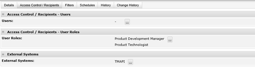

Access Control/Recipients Tab
This page controls which users have access to the report or KPI output and who will be sent an email with a link when the output is generated.
Figure 5-3 New Report Schedule Access Control/Recipients Page
Table 5-4 New Report Schedule Access Control/Recipients Page
Users |
Click the icon to select individual users to be recipients. Select the user's job role to locate them. The list is restricted to those that have access to the Reports module. |
User Roles |
Click the icon to select job roles for any users with the role to be a recipient. |
External Systems |
Click the icon to select any external systems that are to have access to a report output using the Report Attachment API. |

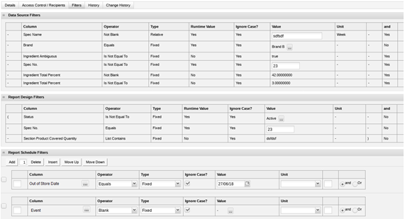

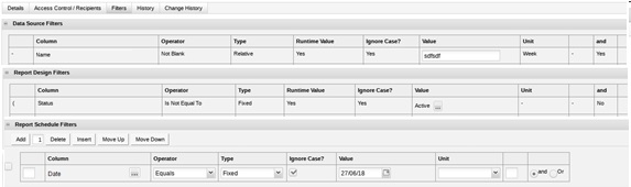

Filters Tab
Optionally add any filters to be applied to the report schedule. For information about adding filters, see Filters.
Figure 5-4 Report Schedule Filters Page
The Data Source Filters and Report Design/KPI Filters tables show any filters that have been applied to the data source or report design respectively.
If any have been specified as runtime filters, enter the value here, otherwise these tables show as read-only. The runtime filter option is not relevant for report schedule filters.
The filters are applied as any data source filters AND any report design filters AND any report schedule/KPI filters. For date filters, the time-zone of the user who scheduled the report is assumed.
A snapshot of any filters applied in the associated data source, KPI, or report design is held on the report schedule. If changes are made to the associated filters, a new version of the report schedule must be created.
When a new version of a report schedule is created, its filters are refreshed from the current filters in the associated glossary records (if any).
When at draft status, the Actions menus include a Refresh Report Filters option which will reset the filters that have been derived from the associated data source, KPI, or report design. A confirmation prompt is presented prior to the filters being reset. The values of any runtime filters will be cleared.

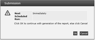

Select the Activate action. A submission confirmation prompt dialog box appears. It shows when the report will run, based on the schedule details.
Figure 5-6 Confirm Report Submission

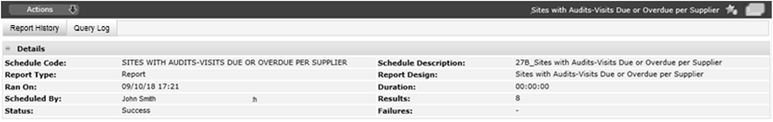

History Tab
When the report has run, details will appear in the schedule's History page.
Figure 5-7 Report Schedule History Page
The list shows the date and time of the run (most recent first), how long it took to run, the number of results in the report (reports only, not KPIs), who scheduled it, and the status of the job.
Double-click a row in the list to view the full details. The page is read-only.
Figure 5-8 Report Schedule History Details
Table 5-6 Report Schedule History Details
Schedule Code |
The code that uniquely identifies the report schedule. |
Schedule Description |
The name of the report schedule. |
Report Name |
The name of the generated data extract file. |
Report Type |
Whether a report, a KPI, or a Process & Activity Brief Extract. |
Report Design |
The report design that the report is based on. |
Ran On |
The date and time the report ran. |
Duration |
The length of time it took to generate the report. |
Scheduled By |
The name of the user who scheduled the report. |
Results |
The number of rows that appear in the report. This will be blank if the Report Type is KPI. |
Status |
The status of the schedule. If the status
shows the success If a report exceeds the maximum
number of permitted rows, the stop |
Failures |
In the event of a failure or stoppage, the exception message. |

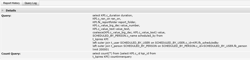

The Query Log page is available to the Report Administrator. It shows the data selection and record count SQL query statements that the report or KPI has applied.
Figure 5-9 Report Schedule History Details - Query Log
Reports that use an API as their data source rather than an SQL query will show the text Queries executed are not available for API-based Reports instead.

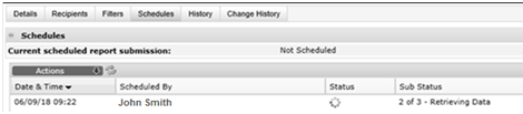

Monitoring Scheduled Reports
Once a report is submitted, the user who submitted it, and reporting administrators can monitor its progress, and may cancel the job if necessary.
Schedules Tab
To view the job progress of the scheduled report, open the Schedules page. The page shows the current status of the schedule and a list of any queued or running instances of the report.
There will typically not be more than one entry in this list, if a report is already scheduled and is resubmitted, the existing schedule will be updated with the new date and time.
The list has columns for the scheduled date and time, the name of the user who submitted it, its status, and a sub status. If the job is in progress, the sub status indicates the stage of process, such as:
Stage 1 of 3: Counting results
Stage 2 of 3: Processing data
Stage 3 of 3: Creating output
Figure 5-10 Report Schedule Schedules Page
