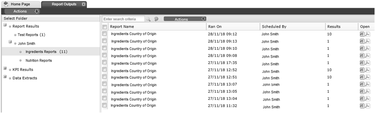

To access the Report Outputs, select the Report Outputs option in the Reports navigation menu.
The report outputs are stored in a library of folders, which can be nested within a hierarchy. The folder is specified when the report is scheduled to run. The folder structure has separate areas for reports, KPIs, and data extracts. The number of entries within each folder is indicated.
Figure 6-1 Report Outputs Page
Locate a report by navigating through the folder hierarchy, or using the search box. The columns can be sorted in ascending or descending sequence.
Selecting a folder in the left-hand pane shows its report outputs in the right-hand pane with columns for the report name, date and time the report ran, the name of the user who scheduled the report, the number of rows that appear in the report, and links to the actual reports.
The list is filtered to just show reports that the user is permitted to access.

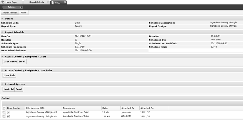

Viewing Report Outputs
To see the details for a report, double-click the row. A tab opens with the details. You can also open the actual report by clicking the icon in the Open column, then choosing to open or save the file. The page is read-only.

Report Output Details Tab
Figure 6-3 Report Outputs Details Page
Table 6-1 Report Output Details Page

Output |
A list of the actual report files, held as attachments, with columns showing an icon of the file format, the file name, the report description, the size of the file in bytes, the name of the user who scheduled the report, and the date it was created. |
Click the icon in the Download column to view the report, then choose to open or save the file.
The actual report can then be viewed using an application appropriate to the file type (such as Microsoft Excel or Adobe Acrobat PDF Reader).
If opening a report in Excel, it may be necessary to manually adjust the columns, rows, and wrapping to suit the layout.
Tabular reports are best viewed using Excel, form reports are less suited to the Excel format.
Form reports generated in Excel (xlsx) format will split page breaks across separate tabs, whereas the Excel (xls) format will just contain a single tab.

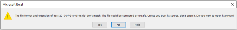

If opening a report in Excel issues a warning message as shown in Figure 6-4, it can be avoided by choosing the MS Excel (xslx) option.
