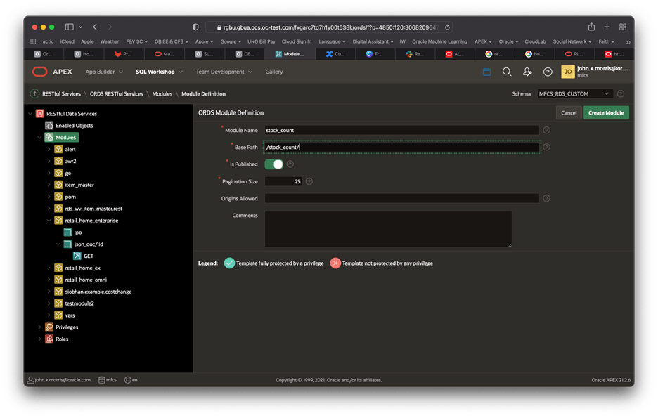

Create a Stock Count Module
The first step is to create a module. Module is a hierarchical organizing construct. The user may have multiple services associated with it or just one. The following screen shot illustrates what the create module screen looks like prior to creating the module. Note the module name is stock_count and the base path is /stock_count/.

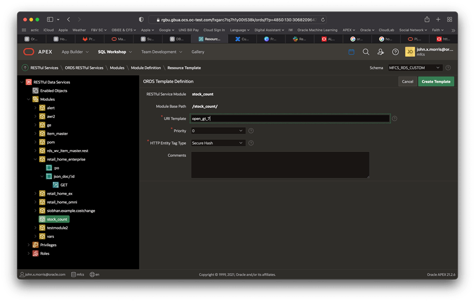

Create a URI Template
Once the module is created, create the URI template. Note the URI template is set to open_gt_7, i.e., stock counts open for more than seven days.
create URI template screen

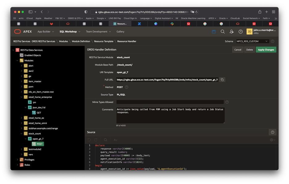

Create a POST Handler
The last step is to create a POST handler. Note the method is POST and the source type is PL/SQL.
create POST Handler
The source of the example alert service is in Listing 1. The body, a sample of which is shown in Listing 2, of the alert service invocation is accessed using the :body_text implicit parameter -- a bind variable. This variable can only be read once; so, retrieve it and store it in a variable. Unpacking the payload and crafting a response will be common tasks for most RESTful services. The example below illustrates some but not all that one might encounter. Bear in mind, the example below does not show any error handling. Experimentation and experience will determine what level of error handling is warranted. Listing 3 shows a response.
declare
    -- The :body_text bind variable is an implicit parameter.
    -- It can only be read once, so it is captured in a variable
    -- called payload.
    payload varchar2(4000) := :body_text;
    -- The result of the stock count query
    query_result number;
    -- Note that varchar2 is set to the maximum. If the response
    -- could exceed 4000 characters, a CLOB would be needed and
    -- one could not use htp.print directly.
    response varchar2(4000);
    -- The response will return the agentExecutionId in
    -- response as the executionId.
    agent_execution_id varchar2(32);
    -- The notification info destination.
    notificationInfo varchar2(1024);
begin
    -- Get the agent execution id from the payload (i.e., body text).
    agent_execution_id := json_value(payload, '$.agentExecutionId');
    -- Get a count of stock counts that have been open for more than
    -- 7 days and put it in query result.
    SELECT count(1)
        into query_result
        FROM rds_wv_stake_prod_loc spl,
            rds_wv_stake_head s
        WHERE s.stocktake_date BETWEEN sysdate - 7 AND sysdate
        AND s.delete_ind = 'N'
        AND spl.cycle_count = s.cycle_count
        AND s.stocktake_type = 'B'
        AND spl.processed != 'S'
        AND spl.cycle_count = s.cycle_count;
    -- Craft notificationInfo as a human readable string.
    notificationInfo := 'Number of stock counts that have been ' ||
        'open for more than 7 days is ' || to_char(query_result) || '.';
    -- Craft the required JSON response. There is no executionInfo.
    select json_object('status' value 'success',
            'executionInfo' value '',
            'executionId' value agent_execution_id,
            'notificationInfo' value notificationInfo) into response from dual;
    -- Output the response - note htp.print is used here. htp.print
    -- only supports varchar2 so another approach would be needed
    -- if the response is likely to exceed 4000 characters. This could
    -- if error handling (not shown) were to return a stack trace.
    htp.print(response);
end;
Listing 1: An Alert service conforming to POM Requirements

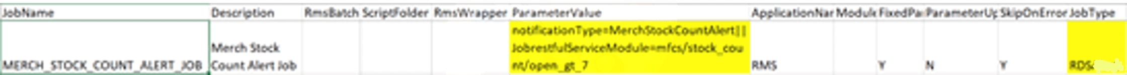

Figure 21-2 Job Tab
Job tab
  • JobName – Unique job name for each alert in upper case only with no spaces. Use an underscore if needed. It should end with XXX_JOB.
  • Description – Short description of the job without any special characters.
  • RmsBatch, ScriptFolder and RmsWrapper – Irrelevant for alerts and can be left empty.
  • ParameterValue – This holds the two parameters needed to identify the notification type and the RDS endpoint. For the example at hand, these are:
    • notificationType: This is the notification type setup in Retail Home as described in the Setting Up a Notification Type section at the top of this document: MerchStockCountAlert.
    • restPath : This points to the endpoint defined above: mfcs/stock_count/open_gt_7.
  • These need to be separated by a double pipe as depicted in the Job tab screen shot above.
  • ApplicationName – Mention the same application name entered in Process tab. Here, it’s RMS.
  • Modules – Job can be associated with a module of the application.
  • Job Type – The job type associated with RDS alerts is RDS.

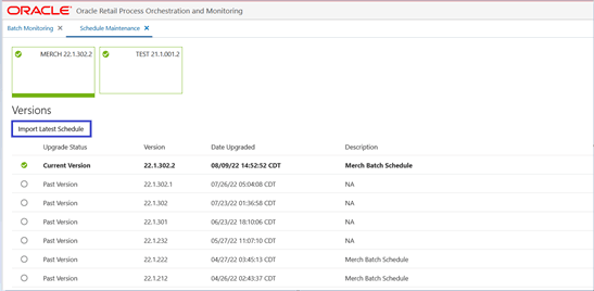

Uploading the Batch Schedule Spreadsheet in POM
  1. Log in to POM UI and navigate to Tasks -> Schedule Maintenance.
  2. Select the Application Scheduler tile and click ‘Import Latest Schedule’ button.
  3. Upload the spreadsheet containing the new Adhoc job for alert.
    Figure 21-5 Upload Batch Schedule

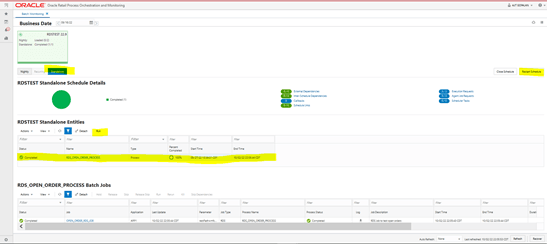

Direct Run
On the Batch Monitoring screen, select the Standalone tab below the tile area. Then select the previously added RDS Alert process in the Standalone Entities table and click on the run action button above the table.
Figure 21-7 Batch Monitoring

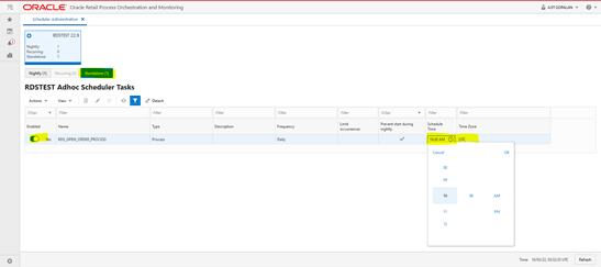

Schedule through the Scheduler Administration Screen
You can use the POM Scheduler Administration screen to schedule the newly added job to run as frequently as needed.
Figure 21-8 Scheduler Administration
