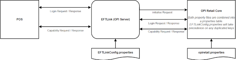

Figure 3-1 EFTLink and Core Initialized through the reading in of Property Files followed by Capability Request

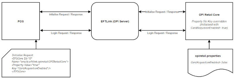

Figure 3-2 EFTLink and Core initialized via POS initialise Server Request
