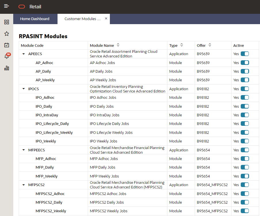

Customer Module Management
Customer Module Management is used by the AP module for controlling the enablement of POM batch configurations. Daily, weekly and ad-hoc configurations can be controlled independently. If there are multiple instances of AP, each instance will have its own separate POM schedule and batch configurations and is displayed separately in Retail Home.
customer modules
For more on controlling batch modules in Retail Home, see the Process Orchestration and Management section of this document. Customer modules are only used for batch configuration, access to the applications themselves is not managed from Retail Home.

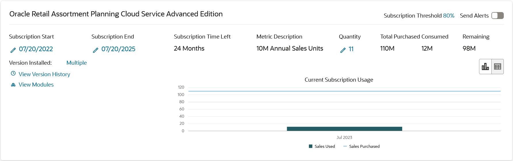

Subscription Metric Report
In version 23.x and higher, the Assortment Planning Cloud Service provides reporting on subscription usage metrics through Retail Home. For Assortment Planning Cloud Service, the Subscription Metric report provides information on annual sales under management of the system, which is the metric used for all Oracle Retail Planning Cloud Services. If the customer has additional instances of AP or MFP, they will show up as separate reports on the Application Dashboard.
This report is visible by navigating to Settings -> Application Administration -> Application Dashboard. Additional details for using the subscription metrics report, such as inputting or editing the subscription start/end dates and the subscription quantity, can be found in the Retail Home Administration Guide.
subscription metric report
Statistics for the report are gathered through an automated job that is set up automatically when the system is created.
