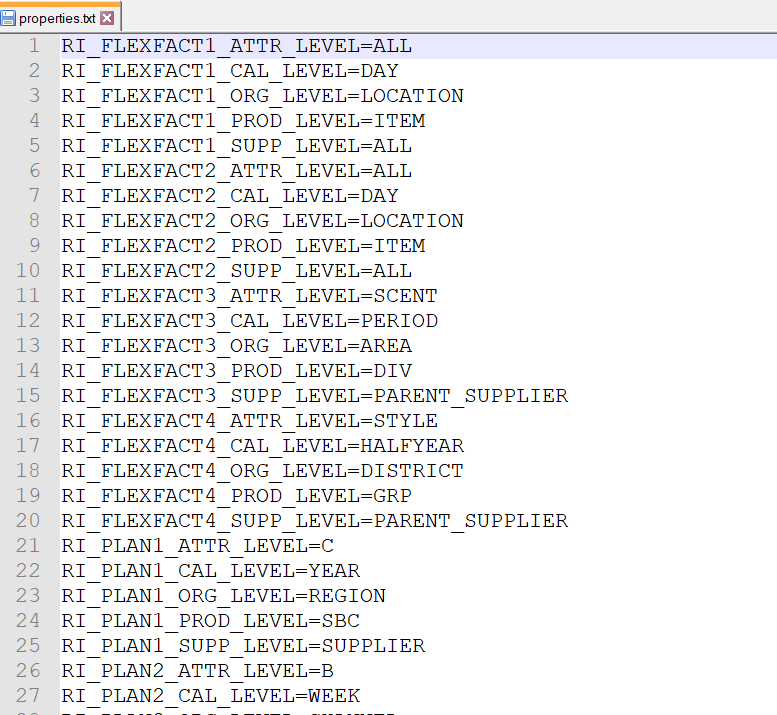

Database Mode (d)
In database mode user has to first set Planning levels in C_ODI_PARAM table then run PlanningConfigurationScript.sh script with MODE argument d. Configuration levels need to be set for below list of PARAM_NAME in the C_ODI_PARAM table.
File Mode (f)
In File Mode user has to first set Planning levels in the file proper-ties.txt in the path where OBIEE_BAR_FILE_DEP.zip is un-zipped, then run PlanningConfigurationScript.sh script with MODE argument f.
FLEX_FACT Configuration requires setting of only FLEX_ FACT levels in properties.txt and for planning only planning levels should be set. Similarly Planning RDF Forecast Integration requires setting only Planning RDF Forecast Integration levels in properties.txt.
Figure 3-1 Properties.txt File
Properties.txt File
While running in filemode, planning levels to be set in properties.txt should match the C_ODI_PARAM table planning level entries.
