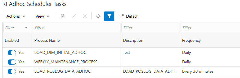

Click on the RI schedule. Make sure the LOAD_POSLOG_DATA_ADHOC process is present in the Standalone tab and enabled.

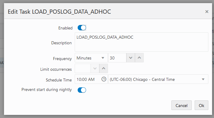

Highlight that row and click the Edit action icon.
Adjust the frequency to the desired interval, such as 30 minutes or 1 hour. Click OK to confirm the change.

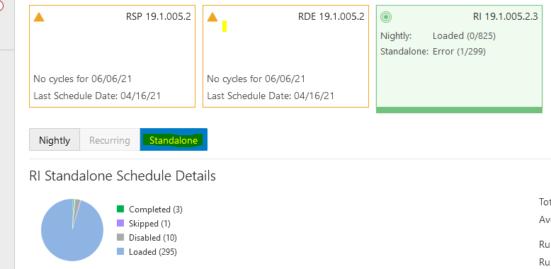

Navigate to the Batch Monitoring screen and Restart Schedule for the RI Standalone schedule.
Once restarted, the adhoc process will begin to run automatically on the specified interval.
