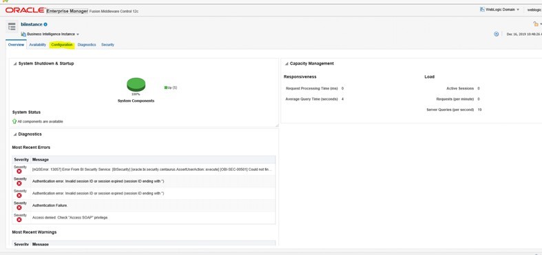

Expand the Business Intelligence menu item and click biinstance. The Overview tab appears.
Figure 9-2 Overview Tab

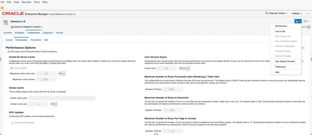

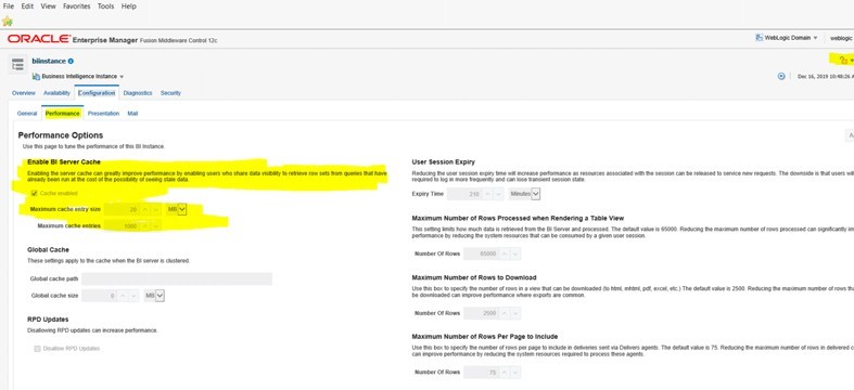

Click the Configuration tab.
Figure 9-3 Configuration Tab
Go to the top right hand corner, click Lock and Edit. Modify and then Activate after you complete editing.
Figure 9-4 Lock and Edit

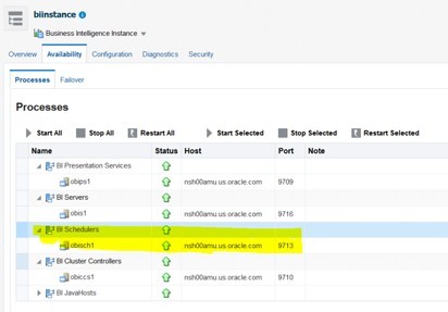

For Single Node/ Non-Clustered Environment
input.obiee.pri.sch.server= Node-1-Host name
input.obiee.sec.sch.server=
input.obiee.pri.sch.port= 9713 (obisch1service name)
input.obiee.sec.sch.port=
To find out the port Numbers Log into the Enterprise Manager in WLS Example of the link is:
http://nsh00amu.us.oracle.com:7001/em
Click the Availability tab.
Figure 9-6 Availability Tab - Non-Clustered Environment

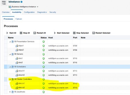

For Clustered Environments
input.obiee.sec.sch.server= Node-2-Host name
input.obiee.pri.sch.port= 9710 (obiccs1 service port)
input.obiee.sec.sch.port= 9710 (obiccs2 service port)
Figure 9-7 Availability Tab - Clustered Environment

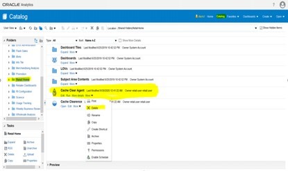

Navigate to Analytics URL -> go to Catalog -> Retail Home. Click the More menu and select Delete to delete the agent.
Figure 9-8 Delete the Agent

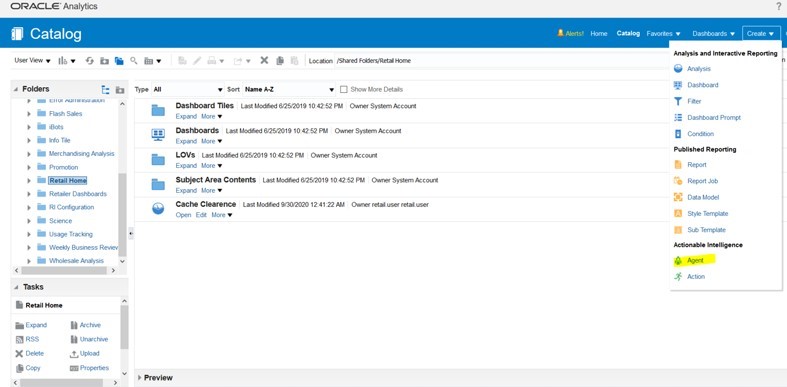

In the upper right of the page, click the Create menu and select Agent.
Figure 9-9 Create Agent

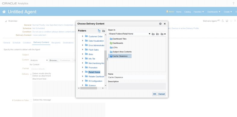

From the Choose Delivery Content pop-up, select Cache Clearance.
Figure 9-10 Choose Delivery Content

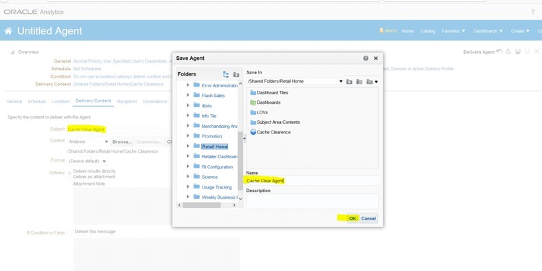

Save as Cache Clear Agent in the Shared/Retail Home Folder.
Figure 9-11 Save as Cache Clear Agent
