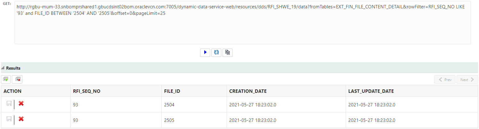

IN Statement

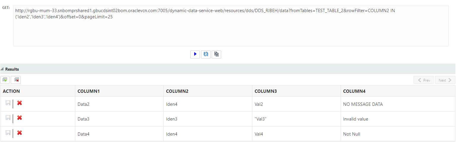

The IN statement can be added separately to the query request to only view results containing one of a set of possible values. A simple GET request and result with IN statement can be like the following:
http://<dds_host>:<port>/dynamic-data-service-web/resources/dds/<selected_schema>/data?fromTables=<selected_table>&rowFilter=<COULMN_NAME> LIKE '<data_to_search>'&offset=0&pageLimit=25
A curl equivalent of the above example:
Curl -i -H "Authorization: Bearer $AccessToken" -H "Content-Type: application/json;charset=UTF-8" --request GET  "http://<dds_host>:<port>/dynamic-data-service-web/resources/dds/<selected_schema>/data?fromTables=<selected_table>&rowFilter=<COULMN_NAME>%20IN%20('<value1>','<value2>','<value3>', …)&offset=0&pageLimit=25" -o filename.txt
The IN Statement supports searching using comma-separated values in parentheses. Sub-queries are NOT supported by the DDS design.
IN Statement

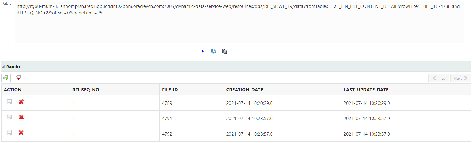

Comparative Operators
Comparative operators (like < and >) can be used to filter data for a particular range. A GET request and result with these operators can be like the following:
http://<dds_host>:<port>/dynamic-data-service-web/resources/dds/<selected_schema>/data?fromTables=<selected_table>&rowFilter=COULMN_NAME<'data_to_search'&offset=0&pageLimit=25
Curl -i -H "Authorization: Bearer $AccessToken" -H "Content-Type: application/json;charset=UTF-8" --request GET  "http://<dds_host>:<port>/dynamic-data-service-web/resources/dds/<selected_schema>/data?fromTables=<selected_table>&rowFilter=COULMN_NAME<'data_to_search'&offset=0&pageLimit=25" -o filename.txt
comparative operators

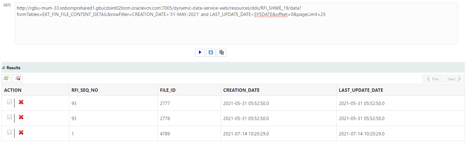

Filtering DATE Column
Date columns can be filtered using the 'DD-MMM-YYYY' date format. Additionally, SYSDATE±N can also be used to query date columns.
Filtering the DATE Column
Example with the SYSDATE keyword:
http://<dds_host>:<port>/dynamic-data-service-web/resources/dds/<selected_schema>/data?fromTables=<selected_table>&rowFilter=CREATION_DATE<SYSDATE-1&offset=0&pageLimit=25
Curl -i -H "Authorization: Bearer $AccessToken" -H "Content-Type: application/json;charset=UTF-8" --request GET  "http://<dds_host>:<port>/dynamic-data-service-web/resources/dds/<selected_schema>/data?fromTables=<selected_table>&rowFilter=CREATION_DATE<SYSDATE-1&offset=0&pageLimit=25" -o file-name.txt
Example with 'DD-MMM-YYYY' date format:
http://<dds_host>:<port>/dynamic-data-service-web/resources/dds/<selected_schema>/data?fromTables=<selected_table>&rowFilter=CREATION_DATE>'01-JAN-1976'&offset=0&pageLimit=25
Curl -i -H "Authorization: Bearer $AccessToken" -H "Content-Type: application/json;charset=UTF-8" --request GET  "http://<dds_host>:<port>/dynamic-data-service-web/resources/dds/<selected_schema>/data?fromTables=<selected_table>&rowFilter=CREATION_DATE>'01-JAN-1976'&offset=0&pageLimit=25" -o file-name.txt

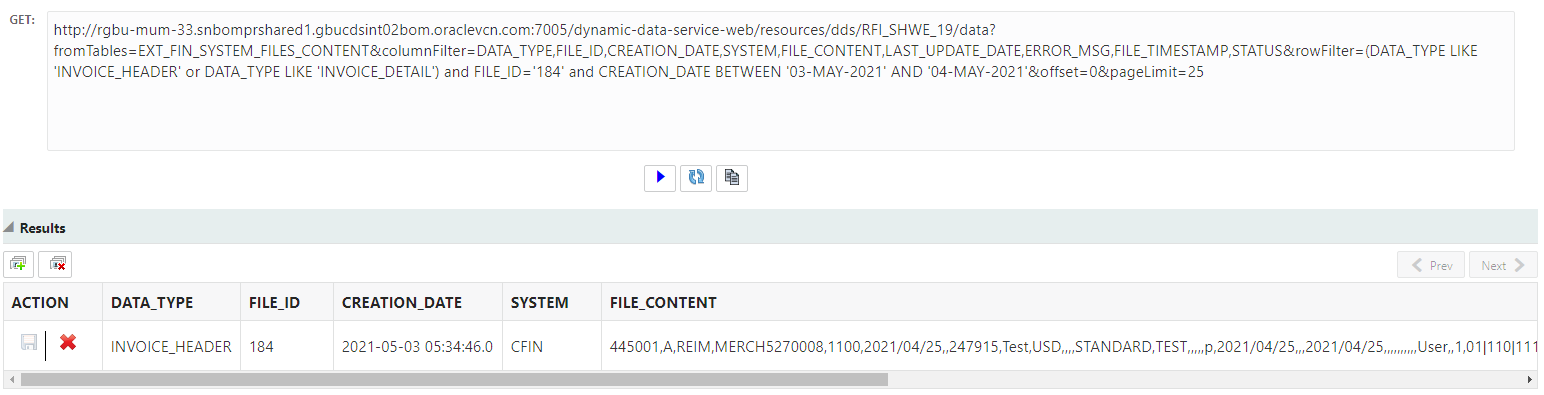

Combinations of OR, AND & BETWEEN Statements
The conditional statements OR, AND & BETWEEN can be used in combination with each other using parentheses to further filter results based on required conditions. The Filter DDS row in the UI can be used to add a single conditional statement, upon which more conditions can be added manually by typing them in the GET box. A simple GET request with result can look like this:
http://<dds_host>:<port>/dynamic-data-service-web/resources/dds/<selected_schema>/data?fromTables=<selected_table>&rowFilter=(DATA_TYPE LIKE 'INVOICE_HEADER' or DATA_TYPE LIKE 'INVOICE_DETAIL') and FILE_ID='184' and CREATION_DATE BETWEEN '03-MAY-2021' AND '04-MAY-2021'&offset=0&pageLimit=25
Combinations of Statements
Curl -i -H "Authorization: Bearer $AccessToken" -H "Content-Type: application/json;charset=UTF-8" --request GET  "http://<dds_host>:<port>/dynamic-data-service-web/resources/dds/<selected_schema>/data?fromTables=<selected_table>&rowFilter=(DATA_TYPE%20LIKE%20'INVOICE_HEADER'%20or%20DATA_TYPE%20LIKE%20'INVOICE_DETAIL')%20and%20FILE_ID='184'%20and%20CREATION_DATE%20BETWEEN%20'03-MAY-2021'%20AND%20'04-MAY-2021'&offset=0&pageLimit=25" -o filename.txt

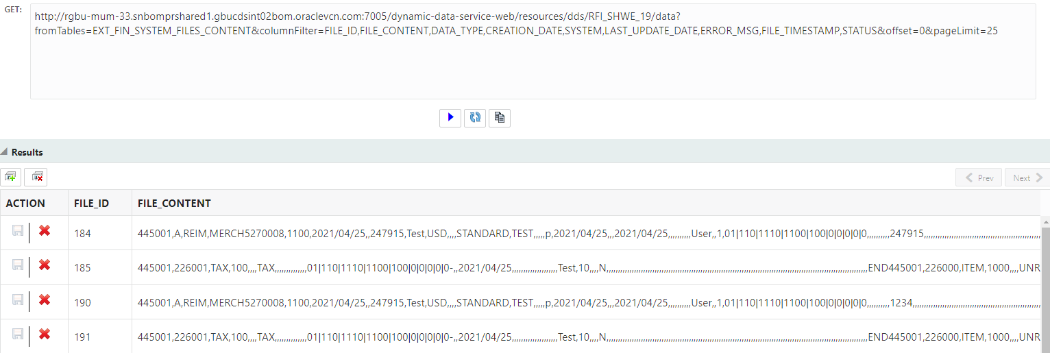

Viewing Clob Data
view clob data
Sometimes the data in a table field can of the type CLOB and have large data in it. DDS supports these fields and can display the data in the UI. However, these fields can also be viewed through a cURL command, and saving the output to a file.
Ensure that the required DDS application username/password is supplied.
Curl -i -H "Authorization: Bearer $AccessToken" -H "Content-Type: application/json;charset=UTF-8" --request GET  "http://<server_host>:<server_port>/dynamic-data-service-web/resources/dds/<selected_schema>/data?fromTables=<selected_table>&columnFilter=MESSAGE_DATA&offset=0&pageLimit=25" -o file_name.txt
The above queries can also be combined with the functions listed above in this chapter to get more filtered results.

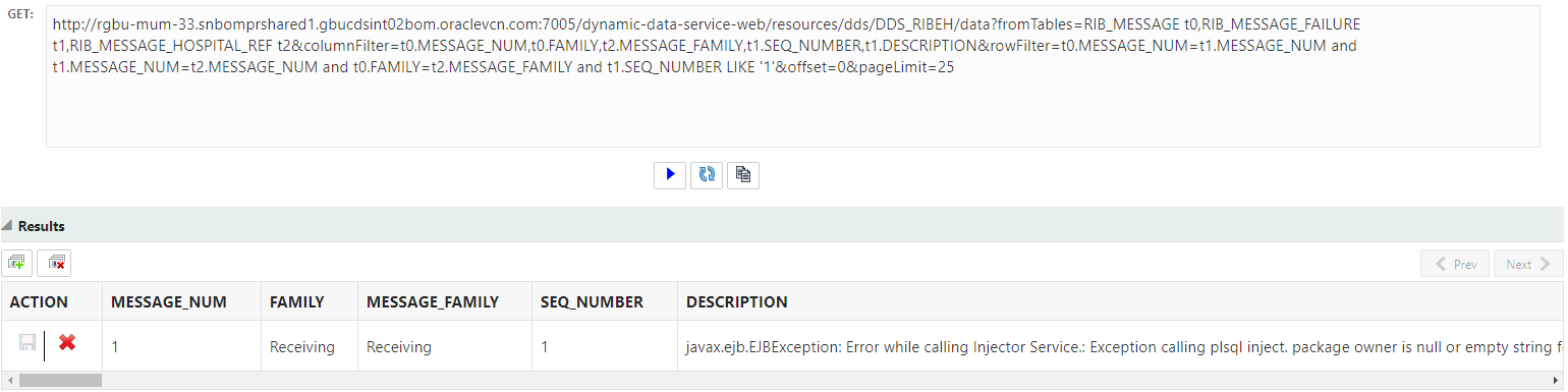

The row filter must be added to this, which can either be done by using the Row Filter in the UI or adding your own rowFilter by typing the required conditions in the GET query box. You must also ensure that all required columns are selected in the column filter, otherwise an error will display when you try to run the query.
Join Tables
A sample GET query with result is as follows:
http://<dds_host>:<dds_port>/dynamic-data-service-web/resources/dds/<SELECTED_TABLE>/data?fromTables=TABLE1 t0,TABLE2 t1,TABLE3 t2&columnFilter=t0.COLUMN1,t1.COLUMN1,t2.COLUMN1,t0.COLUMN2,t1.COLUMN2,t2.COLUMN2,t0.COLUMN3,t1.COLUMN3,t2.COLUMN3&rowFilter=t0.COLUMN1=t1.COLUMN1 and t1.COLUMN1=t2.COLUMN1 and t1.COLUMN2=t2.COLUMN3 and t1.COLUMN3 LIKE '1'&offset=0&pageLimit=25
Curl -i -H "Authorization: Bearer $AccessToken" -H "Content-Type: application/json;charset=UTF-8" --request GET  "http://<dds_host>:<dds_port>/dynamic-data-service-web/resources/dds/<SELECTED_TABLE>/data?fromTables=TABLE1%20t0,TABLE2%20t1,TABLE3%20t2&columnFilter=t0.COLUMN1,t1.COLUMN1,t2.COLUMN1,t0.COLUMN2,t1.COLUMN2,t2.COLUMN2,t0.COLUMN3,t1.COLUMN3,t2.COLUMN3&rowFilter=t0.COLUMN1=t1.COLUMN1%20and%20t1.COLUMN1=t2.COLUMN1%20and%20t1.COLUMN2=t2.COLUMN3%20and%20t1.COLUMN3%20LIKE%20'1'&offset=0&pageLimit=25" -o filename.txt

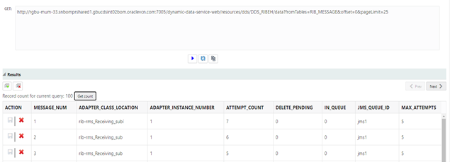

Count of Records
DDS has the ability to fetch the count of records for a particular query. This can be used to fetch count of all records or a limited set of records based on conditions and parameters as required.
Count of Records
http://<dds_host>:<dds_port>/dynamic-data-service-web/resources/dds/<SELECTED_SCHEMA>/data?fromTables=TABLE1&offset=0&pageLimit=25
The count query that is actually being run is slightly different to the one displayed in GET box. The correct one is given below in the curl command equivalent.
Curl -i -H "Authorization: Bearer $AccessToken" -H "Content-Type: application/json;charset=UTF-8" --request GET "http://<dds_host>:<dds_port>/dynamic-data-service-web/resources/dds/<SELECTED_SCHEMA>/data/count?fromTables=TABLE1&rowFilter=<CONDITIONS_AS_REQUIRED>" -o filename.txt
