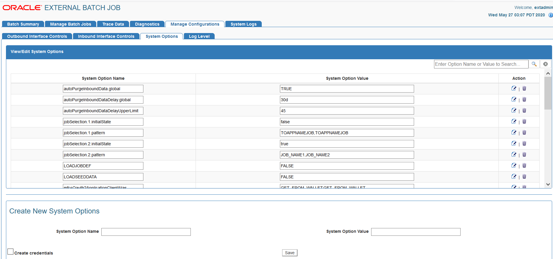

}Auto Purge Inbound Data
A thread runs every hour to identify data sets to be purged based on flags in system options table and purges the data from inbound tables.
Eligible data sets are purged every hour from inbound table. Data set is said to be eligible for purge, if either transaction completion date has crossed predefined time interval or data set ready time has crossed predefined time interval.
Below are steps followed to identify data sets to be purged and purge records from inbound data tables automatically.
Auto purge delay can be allowed/restricted for any specific interface by adding autoPurgeInboundData.{interface_ModuleName} flag in SYSTEM_OPTIONS table with value TRUE/FALSE respetively.
Example: autoPurgeInboundData.Diff_Fnd
If interface level entry is missing in SYSTEM_OPTIONS table, then value of global flag autoPurgeInboundData.global is used to decide whether to purge data for interface module or not.
For each ACTIVE interface modules, check if auto purge flag is set at global level (autoPurgeInboundData.global) or interface module level (autoPurgeInboundData.{interface_ModuleName}) from SYSTEM_OPTIONS table. If flag is TRUE either at global level or at any interface module level, continue with the next steps.
If an entry for auto purge flag is missing in SYSTEM_OPTIONS table, then value of flag at global level (autoPurgeInboundData.global) is defaulted to TRUE.

Steps to update values in System Options
Approach 1: Update via UI
Login to the job admin web page with valid credentials.
Click the Manage Configurations tab.
Click the System options tab.
Search for the system option to update. Example: autoPurgeInboundData.global, autoPurgeInboundDataDelay.global, autoPurgeInboundDataDelayUpperLimit etc.
Click the Edit icon to update the value and click the Save icon to save changes.

Follow below steps to update auto purge configurations.
Turn OFF/ON auto purge:
Login to BDI batch job admin UI with valid Credentials.
Navigate to "Manage Configurations" tab. Select "System Options".
Update value of "autoPurgeBatchInfraData" to true/false to turn off/on auto purge
If "autoPurgeBatchInfraData" is not available add it using "Create New System Options" option.
