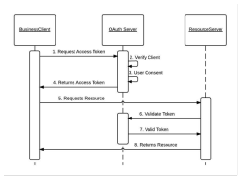

Business to Business (2-legged flow)
It usually represents an application that calls another application or service without end user intervention.
A client (Business Client application) will make a call to a service, business service (in OAuth spec, a resource server), and request some business information, passing the access token.
Since there is no end user intervention, the client is pre-authorized to have access to the resource.

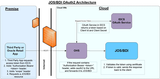

BDI OAuth 2.0 Architecture
BDI/JOS uses OAuth 2-legged flow i.e. business to business flow. IDCS provides OAuth services. OHS is Oracle HTTP server that acts as a listener to incoming requests and route them to appropriate service.
Figure 9-3 BDI/JOS OAuth 2.0 Architecture
