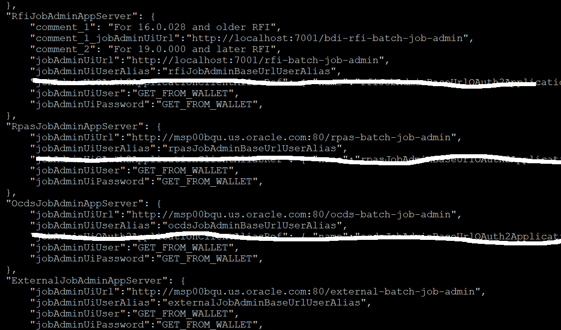

  4. Provide the following values in the JSON file.
    Configuration Property Description
    RmsJobAdminDataSource -> jdbcUrl
    The JDBC URL for the Oracle database where the RMS integration schema resides.
    RmsReceiverServiceDataSource -> jdbcUrl
    The JDBC URL for the Oracle database where the RMS Receiver integration schema resides. BdiRmsJobAdminDataSource and BdiRmsReceiverServiceDataSource can use the same jdbcUrl.
    BatchInfraDataSource -> jdbcUrl
    The JDBC URL for the schema created using RCU. The schema user is <prefix>_wls (e.g. INT_WLS). The value of prefix that you provided in schema creation using RCU.
    JobXmlDataSource -> jdbcUrl
    The JDBC URL for the Oracle database where the all job xmls gets created in rms schema.
    JobAdminAppServer -> weblogicDomainName
    The domain name where BDI RMS Admin app is deployed.
    JobAdminAppServer->weblogicDomainHome
    The domain path where BDIRMS Admin app is deployed
    JobAdminAppServer -> weblogicDomainAdminServerUrl
    Admin Server URL of the BDI RMS Admin App - http://<Admin host>:<Admin port>
    JobAdminAppServer->weblogicDomainAdminServerProtocol
    Admin Server protocol, which is by default t3, For SSL deployment update to t3s.
    JobAdminAppServer -> weblogicDomainAdminServerHost
    Host Name of the BDI RMS Admin Server
    JobAdminAppServer -> weblogicDomainAdminServerPort
    BDI RMS Admin Server Port
    JobAdminAppServer -> weblogicDomainTargetManagedServerName
    Managed Server Name where BDI RMS Admin App is installed (e.g. bdi-rms-server)
    JobAdminAppServer -> jobAdminUiUrl
    Job Admin URL of BDI RMS
    http://<host>:<managed server port>/bdi-rms-batch-job-admin
    dataSourceProperties
    DataSource configurations contributes to the performance
    of the applications at the runtime.
    Ex: "connectionPool_MaxCapacity":"100"
    "general_RowPreferfetchSize":"100"
    RpasJobAdminAppServer -> jobAdminUiUrl
    Job Admin URL of BDI RPAS
    http://<host>:<rpas managed server port>/rpas-batch-job-admin
    SimJobAdminAppServer -> jobAdminUiUrl
    Job Admin URL of BDI SIM
    http://<host>:<sim managed server port>/sim-batch-job-admin
    RfiJobAdminAppServer-> jobAdminUiUrl
    Job Admin URL of BDI RFI
    http://<host>:<sim managed server port>/bdi-rfi-batch-job-admin
    ExternalJobAdminAppServer ->
    jobAdminUiUrl
    http://<host>:<external managed server port>/external-batch-job-admin
    oauth2AuthorizationServerUrl
    Provide the IDCS url
    For example - https://idcs-4ff493196128425c80ce4ecbfc8352e5.identity.c9dev1.oc9qadev.com/oauth2/v1/token
    jobAdminUiOAuth2ApplicationClientAliasRef
    ICDS Client secret ID and password
    "name":"simJobAdminBaseUrlOAuth2ApplicationClientAlias", "value": "*simOauth2ApplicationClientAlias"
    "name":"rfiJobAdminBaseUrlOAuth2ApplicationClientAlias", "value": "*ricsOauth2ApplicationClientAlias"
    "name":"rpasJobAdminBaseUrlOAuth2ApplicationClientAlias", "value": "*rpasOauth2ApplicationClientAlias"
    SystemOptions
    Optional. Allows to provide system options as name value pairs
    The alias names in the configuration files should not be changed.

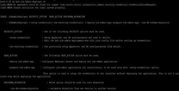

  5. Run the deployer script to create the data sources and deploy BDI RMS Batch Job Admin. While deploying, the user needs to provide the IDCS client secret ID & password for ricsOauth2ApplicationClientAlias, mfcsOauth2ApplicationClientAlias, rpasOauth2ApplicationClientAlias
    cd bdi-edge-rms-job-home/bin
    bdi-job-admin-deployer.sh -setup-credentials -deploy-job-admin-app
    BDI deploy

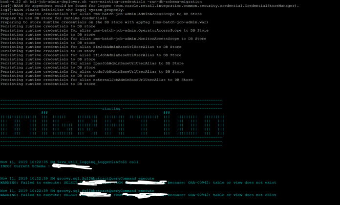

    If you have already configured the credentials and can use the same credentials (typically when redeploying the app), you can run the deployer with the -use-existing-credentials option as follows, and you will not be prompted for the credentials again for the deployment.
    bdi-job-admin-deployer.sh -use-existing-credentials -deploy-job-admin-app

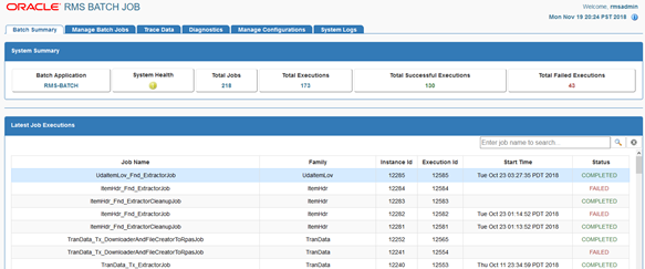

Testing the Deployment
After you deploy to the server successfully, BDI RMS Batch Job Admin can be accessed using the following URL:
http://<server>:<port>/rms-batch-job-admin
Log in using credentials provided during the installation and verify that jobs are displayed in the Manage Batch Jobs tab and configuration is displayed in the Manage Configurations tab.

  3. Edit bdi-job-admin-deployment-env-info.json as follows:
    cd bdi-edge-sim-job-home/confvi  bdi-job-admin-deployment-env-info.json
    SimJobAdminDataSource ->jdbcUrl
    The JDBC URL for the Oracle database where the SIM integration schema resides.
    SimReceiverServiceDataSource -> jdbcUrl
    The JDBC URL for the Oracle database where the SIM integration schema resides. Can use the same jdbcUrl.
    The domain name where BDI SIM Admin app is deployed
    JobAdminAppServer -> weblogicDomainHome
    The domain home directory of WebLogic where BDI SIM Admin app is deployed
    Admin Server URL of the BDI SIM Admin App - http://<Admin host>:<Admin port>
    AdminServer protocol which is by default t3, For SSL deployment update to t3s.
    Host Name of the BDI SIM Admin Server
    BDI SIM Admin Server Port
    Managed Server Name where BDI SIM Admin App is installed (e.g. bdi-sim-server)
    http://<host>:<bdi SIM managed server port>/sim-batch-job-admin
    ExternalJobAdminAppServer -> jobAdminUiUrl
    Job Admin URL of BDI EXTERNAL
    http://<host>:<bdi rms managed server port>/rms-batch-job-admin
    SystemOptions
    RmsJobAdminAppServer -> jobAdminUiUrl
    Optional - Users can configure system options in the deployment env info json file. Users have to add the system options as part of the configuration in the json file with name value pairs. After the application starts, the system option tables should have system options provided in the json file a=b and c=d values in the system options table. After deploying job Admin, verify that values are getting added to the system option table properly.

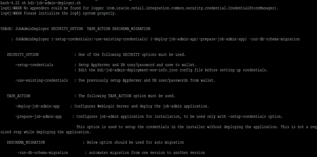

  5. Run the deployer script to create the data sources and deploy BDI SIM Batch Job Admin.
    cd bdi-edge-sim-job-home/bin
    deployer

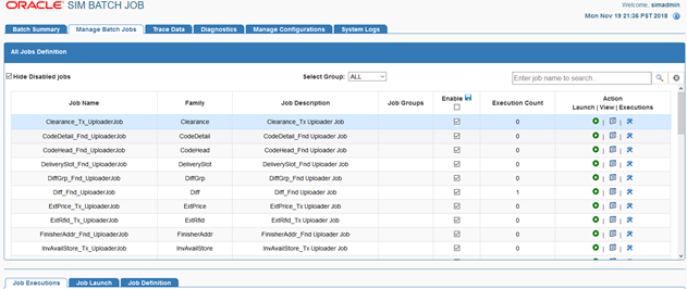

After you deploy to the server successfully, the BDI SIM Batch Job Admin can be accessed using the following URL:
http://<server>:<port>/sim-batch-job-admin

  9. Deploy the BDI Edge job app using -setup-credential option (Follow BDI Installation Guide). -use-existing-credential option will not work the first time, since there is a new entry (IDCS client credentials) now. While deploying user needs to provide the IDCS client secret ID & password for ricsOauth2ApplicationClientAlias, mfcsOauth2ApplicationClientAlias, rpasOauth2ApplicationClientAlias. Cd to <appName>-job-home/bin and run the below command to upgrade and deploy the bdi job app.
    sh bdi-job-admin-deployer.sh -use-existing-credentials } -run-db-schema-migration -deploy-job-admin-app
    Database schema auto migration feature should be used from >=16.0.028 version.

  1. To deploy without OAuth, we need to rename or remove the OAuth2 aliases for example:- jobAdminUiOAuth2ApplicationClientAliasRef from bdi-job-admin-deployment-env-info.json, and then deploy. No other extra steps needed for deployment.
    json snippet
    "SimJobAdminAppServer": {
                    "jobAdminUiUrl":"http://localhost:7001/sim-batch-job-admin",
                    "jobAdminUiUserAlias":"simJobAdminBaseUrlUserAlias",
                    "jobAdminUiUser":"GET_FROM_WALLET",
                    "jobAdminUiPassword":"GET_FROM_WALLET",
                "RfiJobAdminAppServer": {
                    "comment_1": "For 16.0.028 and older RFI",
                    "comment_1_jobAdminUiUrl":"http://localhost:7001/bdi-rfi-batch-job-admin",
                    "comment_2": "For 19.0.000 and later RFI",
                    "jobAdminUiUrl":"http://localhost:7001/rfi-batch-job-admin",
                    "jobAdminUiUserAlias":"rfiJobAdminBaseUrlUserAlias",
                "RpasJobAdminAppServer": {
                    "jobAdminUiUrl":"http://localhost:7001/rpas-batch-job-admin",
                    "jobAdminUiUserAlias":"rpasJobAdminBaseUrlUserAlias",
                "ExternalJobAdminAppServer": {
                    "jobAdminUiUrl":"http://localhost:7001/external-batch-job-admin",
                    "jobAdminUiUserAlias":"externalJobAdminBaseUrlUserAlias",
            "CentralAuthenticationSystem":{
                "IdcsAuthenticationProvider":{
                    "oauth2AuthorizationServerUrl":"https://idcs-4ff493196128425c80ce4ecbfc8352e5.identity.c9dev1.oc9qadev.com/oauth2/v1/token",
                    "oauth2Application":[
                             "oauth2ApplicationName" : "RICS",
                             "oauth2ApplicationScopeOfAccess" : {"name":"oauth2.default.scopeOfAccess.*", "value":"urn:opc:idm:__myscopes__"},
                             "oauth2ApplicationClientAlias" : "ricsOauth2ApplicationClientAlias",
                             "oauth2ApplicationClientId" : "GET_FROM_WALLET",
                             "oauth2ApplicationClientSecret" : "GET_FROM_WALLET"
                             "oauth2ApplicationName" : "MFCS",
                             "oauth2ApplicationClientAlias" : "mfcsOauth2ApplicationClientAlias",
  2. Continue with regular installation
In case any similar errors like ORA-00942: table or view does not exist Verify if the corresponding tables present in the schema or not, as there are cases where Bdi<App>ReceiverServiceDataSource and Bdi<App>JobAdminDataSource might have configured to different schemas.RTG maintains only one migration script for upgrades. Please ignore those errors.
