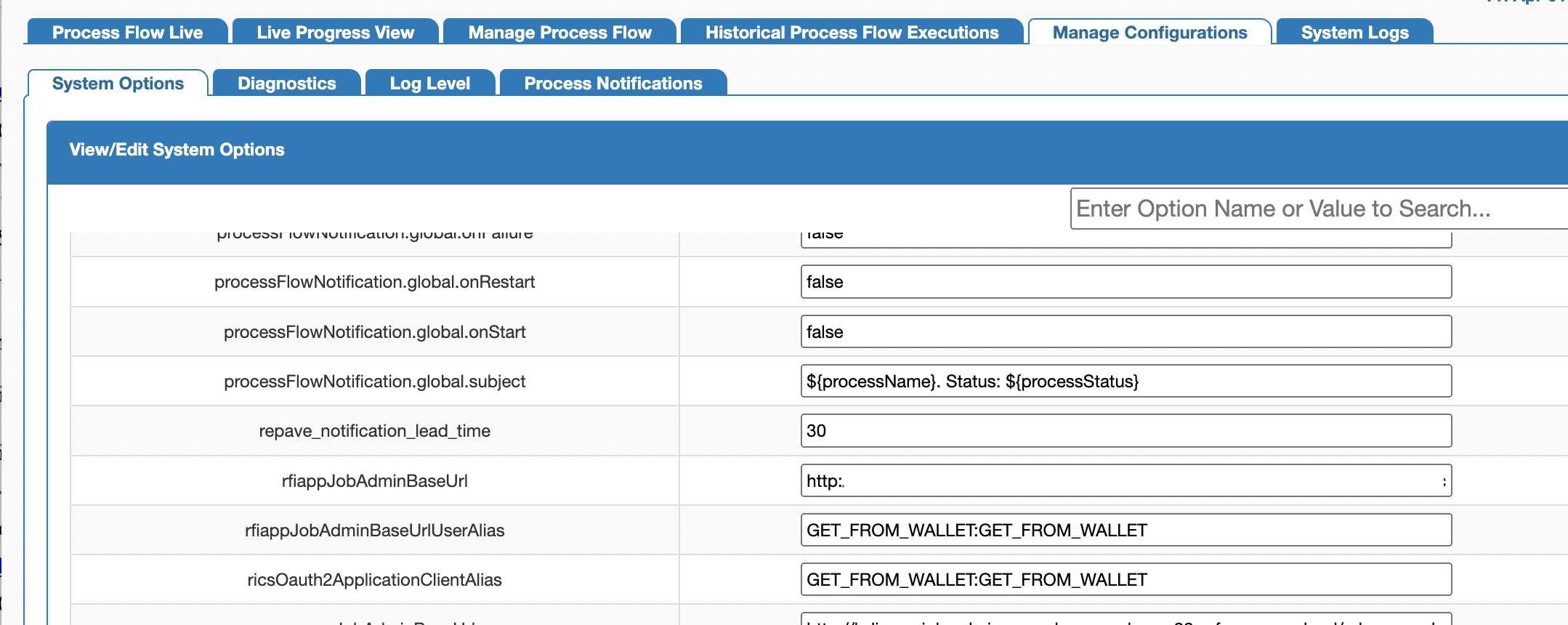

    SystemOptions
    allAvailableDestinationApps mentions all the apps available as destination
    appsInScope - mentions the apps that are in scope.

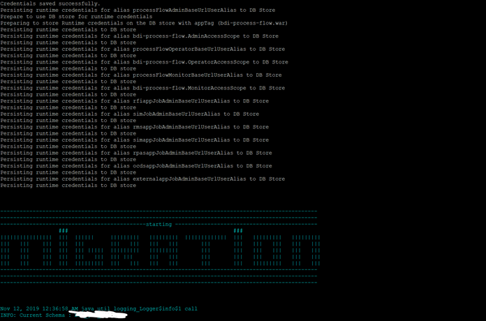

  6. Run the deployer. Make sure that the WebLogic server is running before issuing the following command.
    cd bin
    bdi-process-flow-admin-deployer.sh -setup-credentials -deploy-process-flow-admin-app
    The process flow deployer will prompt for username and password for the following credential aliases:

    If you have already configured various credentials required for process flow, you can run the deployer with the following syntax. It will not ask the credentials again for the deployment. Make sure you set the LOADPROCESSDEF = true, LOADSEEDDATA = true.
    bdi-process-flow-admin-deployer.sh -use-existing-credentials -deploy-process-flow-admin-app
  7. Make sure the deployment step shows deployment success message at the end.

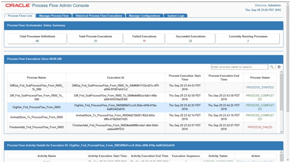

Verify Installation
If the process flow app is successfully deployed, you should be able to access the application at the URL http://<host>:<port>/bdi-process-flow/. The following is a sample screenshot of the process flow application. Make sure all the tabs of the application are properly displayed.
Process Flow Application Example
See the Oracle Retail Bulk Data Integration Implementation Guide for the operation details of the Process Flow application.

Repave lead time by default is 30. The user can modify the value through System Options repave_notification_lead_time.
System Options Repave Setting
