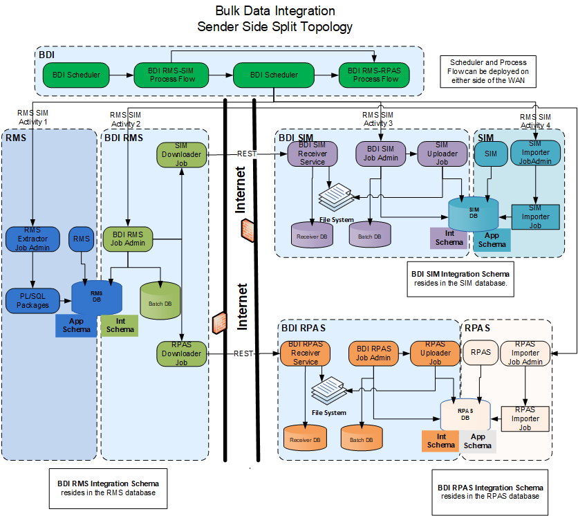

Oracle Retail Bulk Data Integration (BDI) provides the ability to transfer bulk data between Oracle Retail applications. BDI contains the following components:
BDI Batch Job Admin – Helps management of batch jobs
BDI Process Flow - Provides a mechanism to run multiple dependent batch jobs
A BDI installation contains the following components:
An installation of BDI RMS Batch Job Admin
An installation of BDI Process Flow
