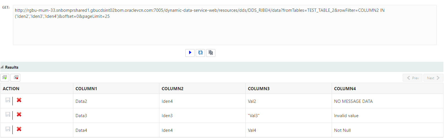

IN Statement
The IN statement can be added separately to the query request to only view results containing one of a set of possible values. A simple GET request and result with IN statement can be like the following:
http://<dds_host>:<port>/dynamic-data-service-web/resources/dds/<selected_schema>/data?fromTables=<selected_table>&rowFilter=<COULMN_NAME> LIKE '<data_to_search>'&offset=0&pageLimit=25
A curl equivalent of the above example:
Curl -i -H "Authorization: Bearer $AccessToken" -H "Content-Type: application/json;charset=UTF-8" --request GET "http://<dds_host>:<port>/dynamic-data-service-web/resources/dds/<selected_schema>/data?fromTables=<selected_table>&rowFilter=<COULMN_NAME>%20IN%20('<value1>','<value2>','<value3>', …)&offset=0&pageLimit=25" -o filename.txt
The IN Statement supports searching using comma-separated values in parentheses. Sub-queries are NOT supported by the DDS design.

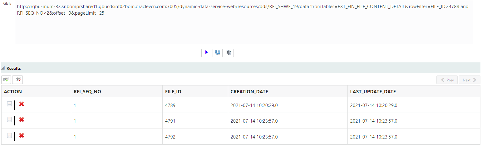

Comparative operators (like < and >) can be used to filter data for a particular range. A GET request and result with these operators can be like the following:
http://<dds_host>:<port>/dynamic-data-service-web/resources/dds/<selected_schema>/data?fromTables=<selected_table>&rowFilter=COULMN_NAME<'data_to_search'&offset=0&pageLimit=25
Curl -i -H "Authorization: Bearer $AccessToken" -H "Content-Type: application/json;charset=UTF-8" --request GET "http://<dds_host>:<port>/dynamic-data-service-web/resources/dds/<selected_schema>/data?fromTables=<selected_table>&rowFilter=COULMN_NAME<'data_to_search'&offset=0&pageLimit=25" -o filename.txt

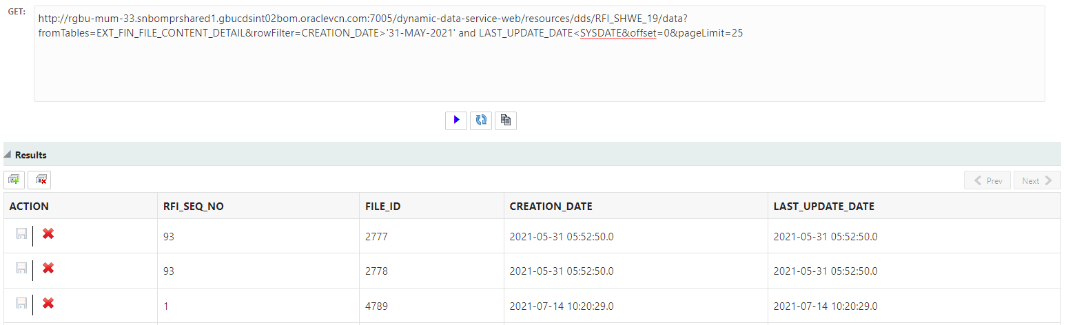

Filtering DATE Column
Date columns can be filtered using the 'DD-MMM-YYYY' date format. Additionally, SYSDATE±N can also be used to query date columns.
Example with the SYSDATE keyword:
http://<dds_host>:<port>/dynamic-data-service-web/resources/dds/<selected_schema>/data?fromTables=<selected_table>&rowFilter=CREATION_DATE<SYSDATE-1&offset=0&pageLimit=25
Curl -i -H "Authorization: Bearer $AccessToken" -H "Content-Type: application/json;charset=UTF-8" --request GET "http://<dds_host>:<port>/dynamic-data-service-web/resources/dds/<selected_schema>/data?fromTables=<selected_table>&rowFilter=CREATION_DATE<SYSDATE-1&offset=0&pageLimit=25" -o file-name.txt
Example with 'DD-MMM-YYYY' date format:
http://<dds_host>:<port>/dynamic-data-service-web/resources/dds/<selected_schema>/data?fromTables=<selected_table>&rowFilter=CREATION_DATE>'01-JAN-1976'&offset=0&pageLimit=25
Curl -i -H "Authorization: Bearer $AccessToken" -H "Content-Type: application/json;charset=UTF-8" --request GET "http://<dds_host>:<port>/dynamic-data-service-web/resources/dds/<selected_schema>/data?fromTables=<selected_table>&rowFilter=CREATION_DATE>'01-JAN-1976'&offset=0&pageLimit=25" -o file-name.txt

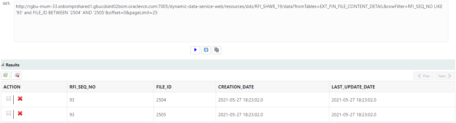

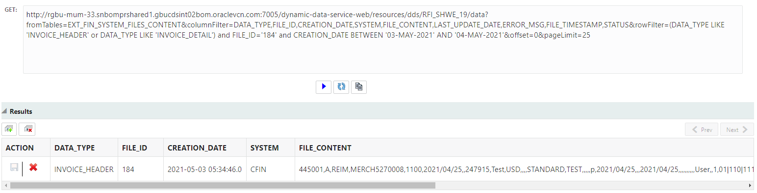

Combinations of OR, AND & BETWEEN Statements
The conditional statements OR, AND & BETWEEN can be used in combination with each other using parentheses to further filter results based on required conditions. The Filter DDS row in the UI can be used to add a single conditional statement, upon which more conditions can be added manually by typing them in the GET box. A simple GET request with result can look like this:
http://<dds_host>:<port>/dynamic-data-service-web/resources/dds/<selected_schema>/data?fromTables=<selected_table>&rowFilter=(DATA_TYPE LIKE 'INVOICE_HEADER' or DATA_TYPE LIKE 'INVOICE_DETAIL') and FILE_ID='184' and CREATION_DATE BETWEEN '03-MAY-2021' AND '04-MAY-2021'&offset=0&pageLimit=25

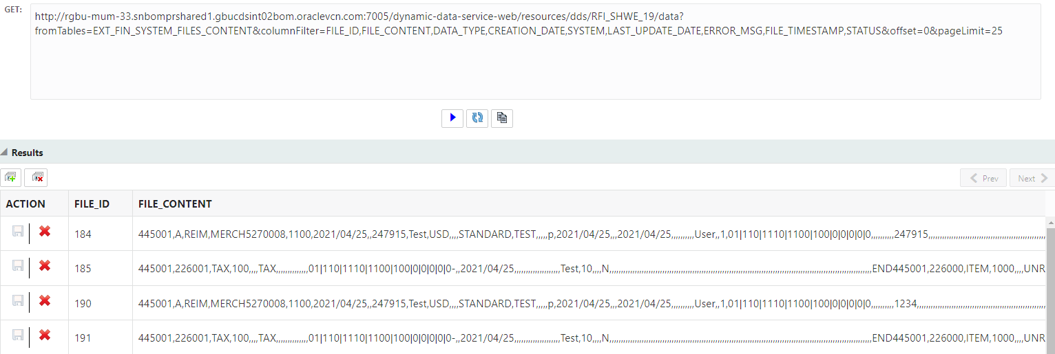

Curl -i -H "Authorization: Bearer $AccessToken" -H "Content-Type: application/json;charset=UTF-8" --request GET "http://<dds_host>:<port>/dynamic-data-service-web/resources/dds/<selected_schema>/data?fromTables=<selected_table>&rowFilter=(DATA_TYPE%20LIKE%20'INVOICE_HEADER'%20or%20DATA_TYPE%20LIKE%20'INVOICE_DETAIL')%20and%20FILE_ID='184'%20and%20CREATION_DATE%20BETWEEN%20'03-MAY-2021'%20AND%20'04-MAY-2021'&offset=0&pageLimit=25" -o filename.txtViewing Clob Data
Sometimes the data in a table field can of the type CLOB and have large data in it. DDS supports these fields and can display the data in the UI. However, these fields can also be viewed through a cURL command, and saving the output to a file.
Ensure that the required DDS application username/password is supplied.
Curl -i -H "Authorization: Bearer $AccessToken" -H "Content-Type: application/json;charset=UTF-8" --request GET "http://<server_host>:<server_port>/dynamic-data-service-web/resources/dds/<selected_schema>/data?fromTables=<selected_table>&columnFilter=MESSAGE_DATA&offset=0&pageLimit=25" -o file_name.txt

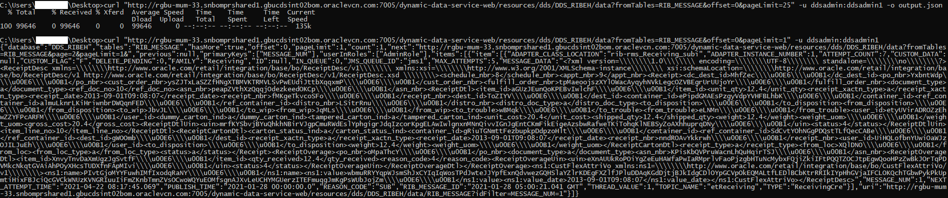

Viewing Query Response as JSON Data
The DDS backend supports sending data as either JSON or XML.
To view the data as XML, run the query in a curl command by adding the -H switch set like the following:
curl "http://<dds_host>:<dds_port>/dynamic-data-service-web/resources/dds/<selected_schema>/data?fromTables=<selected_table>&offset=0&pageLimit=25" -H "Accept:application/xml" -u <dds_user>:<dds_pass> -o file_name.txt
JSON is the default response format. To return a JSON object, do not include the -H switch in the cURL command.
Or, you can set the cURL command with the -H switch setting Accept to application/json in the header. The cURL with output is as follows:
Curl -i -H "Authorization: Bearer $AccessToken" -H "Content-Type: application/json;charset=UTF-8" --request GET "http://<dds_host>:<dds_port>/dynamic-data-service-web/resources/dds/<selected_schema>/data?fromTables=<selected_table>&offset=0&pageLimit=25" -H "Accept:application/json" -o file_name.txt

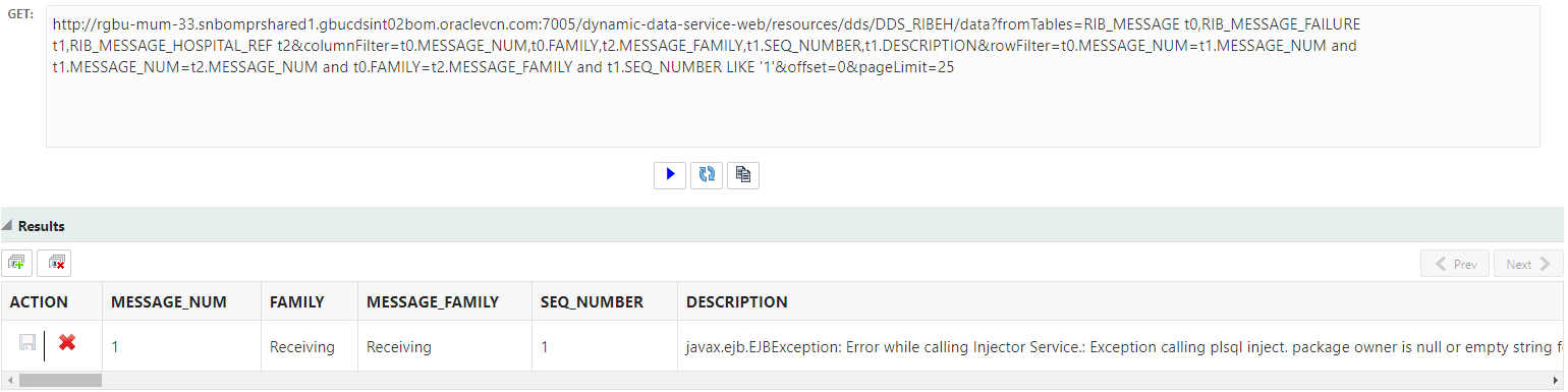

JOINing Two or More Tables
DDS has the ability to join two or more tables. This is done using the JOIN element in the Query Builder Tab under the Designer section.
Use the check box to enable table joins. Once enabled, click inside the visible text field to view a list of tables. Select one or more tables as required.
The row filter must be added to this, which can either be done by using the Row Filter in the UI or adding your own rowFilter by typing the required conditions in the GET query box. You must also ensure that all required columns are selected in the column filter, otherwise an error will display when you try to run the query.
A sample GET query with result is as follows:
http://<dds_host>:<dds_port>/dynamic-data-service-web/resources/dds/<SELECTED_TABLE>/data?fromTables=TABLE1 t0,TABLE2 t1,TABLE3 t2&columnFilter=t0.COLUMN1,t1.COLUMN1,t2.COLUMN1,t0.COLUMN2,t1.COLUMN2,t2.COLUMN2,t0.COLUMN3,t1.COLUMN3,t2.COLUMN3&rowFilter=t0.COLUMN1=t1.COLUMN1 and t1.COLUMN1=t2.COLUMN1 and t1.COLUMN2=t2.COLUMN3 and t1.COLUMN3 LIKE '1'&offset=0&pageLimit=25
Curl -i -H "Authorization: Bearer $AccessToken" -H "Content-Type: application/json;charset=UTF-8" --request GET "http://<dds_host>:<dds_port>/dynamic-data-service-web/resources/dds/<SELECTED_TABLE>/data?fromTables=TABLE1%20t0,TABLE2%20t1,TABLE3%20t2&columnFilter=t0.COLUMN1,t1.COLUMN1,t2.COLUMN1,t0.COLUMN2,t1.COLUMN2,t2.COLUMN2,t0.COLUMN3,t1.COLUMN3,t2.COLUMN3&rowFilter=t0.COLUMN1=t1.COLUMN1%20and%20t1.COLUMN1=t2.COLUMN1%20and%20t1.COLUMN2=t2.COLUMN3%20and%20t1.COLUMN3%20LIKE%20'1'&offset=0&pageLimit=25" -o filename.txtCount of Records

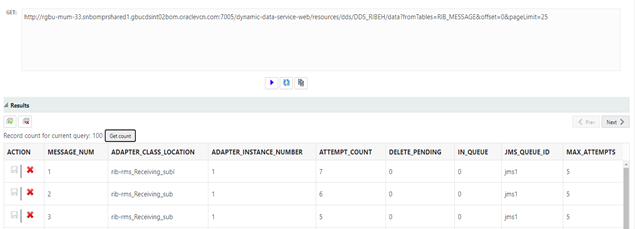

DDS has the ability to fetch the count of records for a particular query. This can be used to fetch count of all records or a limited set of records based on conditions and parameters as required.
http://<dds_host>:<dds_port>/dynamic-data-service-web/resources/dds/<SELECTED_SCHEMA>/data?fromTables=TABLE1&offset=0&pageLimit=25
The count query that is actually being run is slightly different to the one displayed in GET box. The correct one is given below in the curl command equivalent.
Curl -i -H "Authorization: Bearer $AccessToken" -H "Content-Type: application/json;charset=UTF-8" --request GET "http://<dds_host>:<dds_port>/dynamic-data-service-web/resources/dds/<SELECTED_SCHEMA>/data/count?fromTables=TABLE1&rowFilter=<CONDITIONS_AS_REQUIRED>" -o filename.txt
