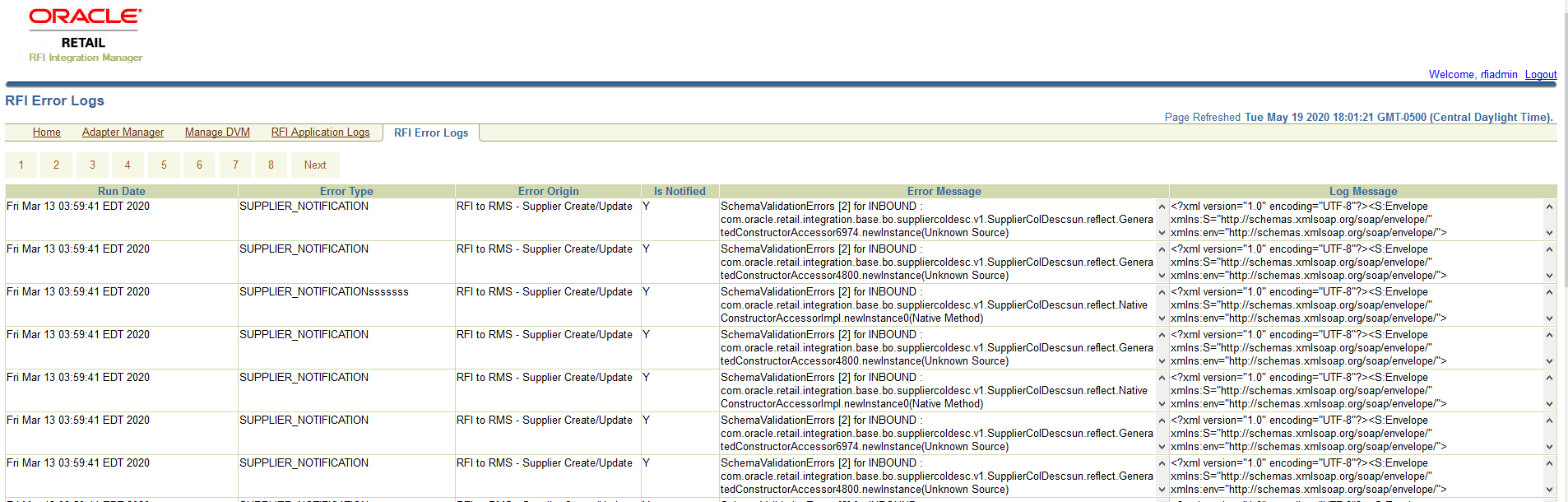

Handling errors

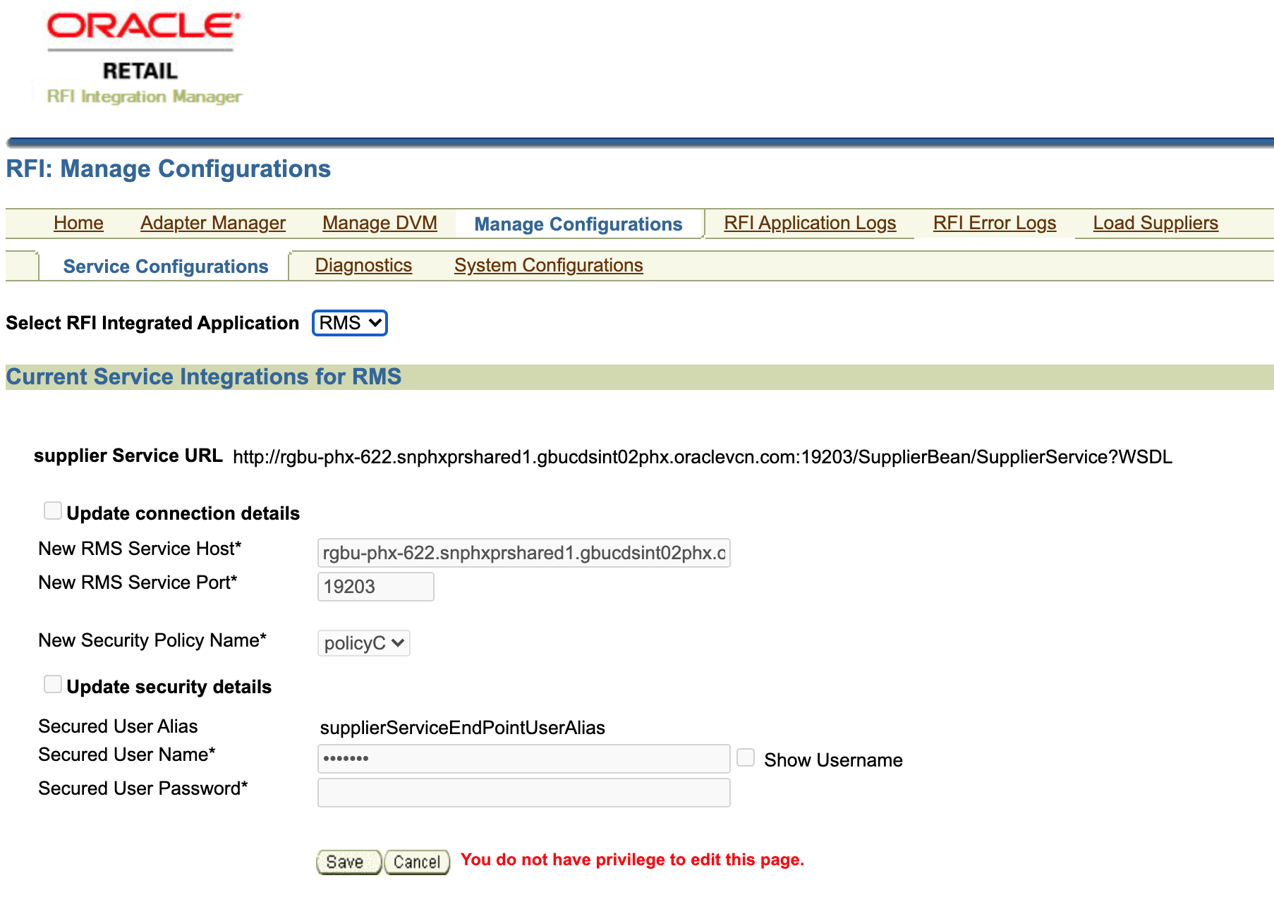

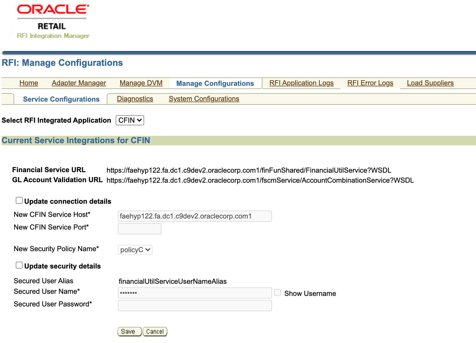

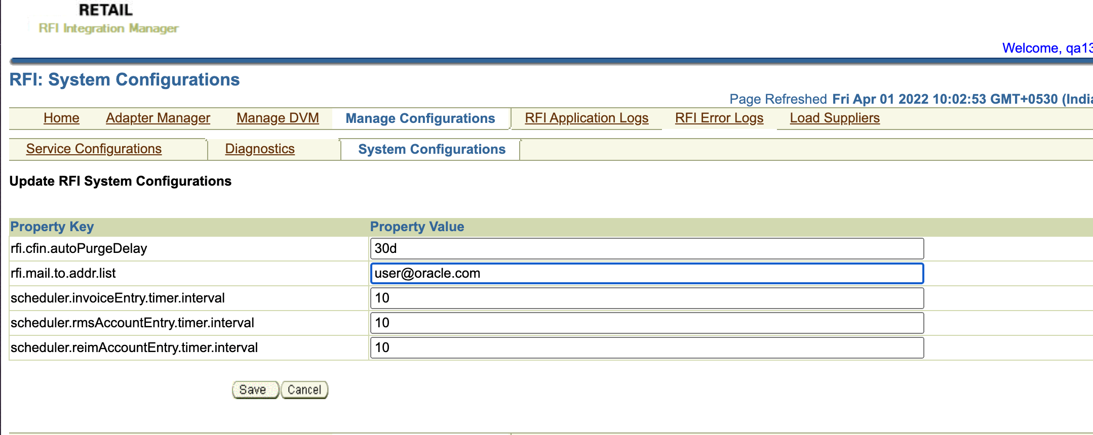

Setting configuration properties

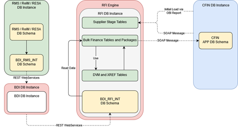

RFI Database Schema Topology
The diagrams below illustrates the Database schema topology for CFIN integration:-
Figure 6-1 RFI Database Schema Topology for Cloud Financials Integration

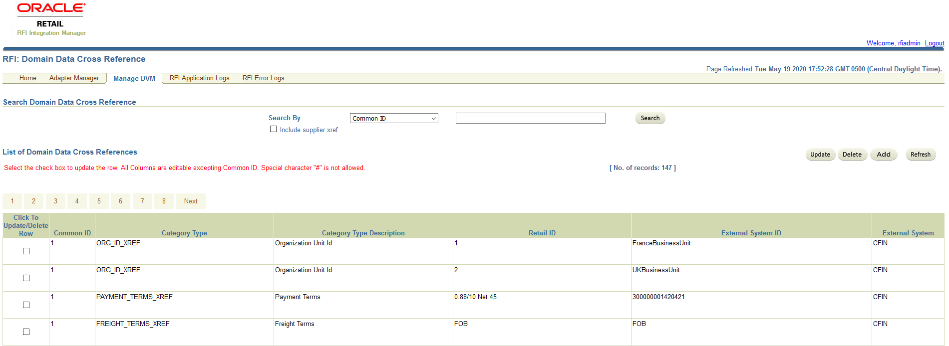

Working with Cross-References
Cross-references maps and connects the records within the application network, and they enable these applications to communicate in the same language. The RFI application stores the relationship between applications in a persistent way so that others can refer to it. The following table lists the Oracle Retail to Oracle Financials RFI cross-references:
Table 6-2 Oracle Retail to Oracle Financials RFI cross-references
| Cross Reference Table - RFI_XREF_DVMColumn: Category_Type | Retail Column Name RETL_ID | EBS Column Name - EXT_SYSTEM_ID | Description | Usage |
PAYMENT_TERMS_XREF (manual sync) |
Payment Term Value in Retail |
Payment Term Value in CFIN |
Payment Term Id |
Manual Sync for CFIN Integration |
FREIGHT_TERMS_XREF (manual sync) |
Freight Term Value in Retail |
Freight Term Value in CFIN |
Freight Term Id |
Manual Sync |
ORG_ID_XREF |
ORG_UNIT_ID in Retail |
ORGANIZATION_ID value in CFIN |
Organization Unit |
Manual Sync. |
SUPPLIER_XREF |
Supplier Id in Retail |
Vendor id in Oracle Financials (CFIN) |
Supplier Id |
Xref value for Retail is Supplier. The value for Oracle Financials will be Vendor ID. Populated during the supplier integration. |
SUPPLIER_SITE_XREF |
Supplier Site Id in Retail |
Vendor Site id in Oracle Financials (CFIN) |
Supplier Site Id |
Xref value for Retail is Supplier Site id. The value for Oracle Financials will be the VendorSiteID .Populated during the supplier integration. |
SUPPLIER_SITE_NAME_XREF |
Supplier Site id in retail plus the supplier site description (common for retail and cfin) |
Supplier Site name |
Xref value for Retail is Supplier site id. The value for EXT_ID will be the SupplierSiteID SupplierSiteName .Populated during the supplier integration. |

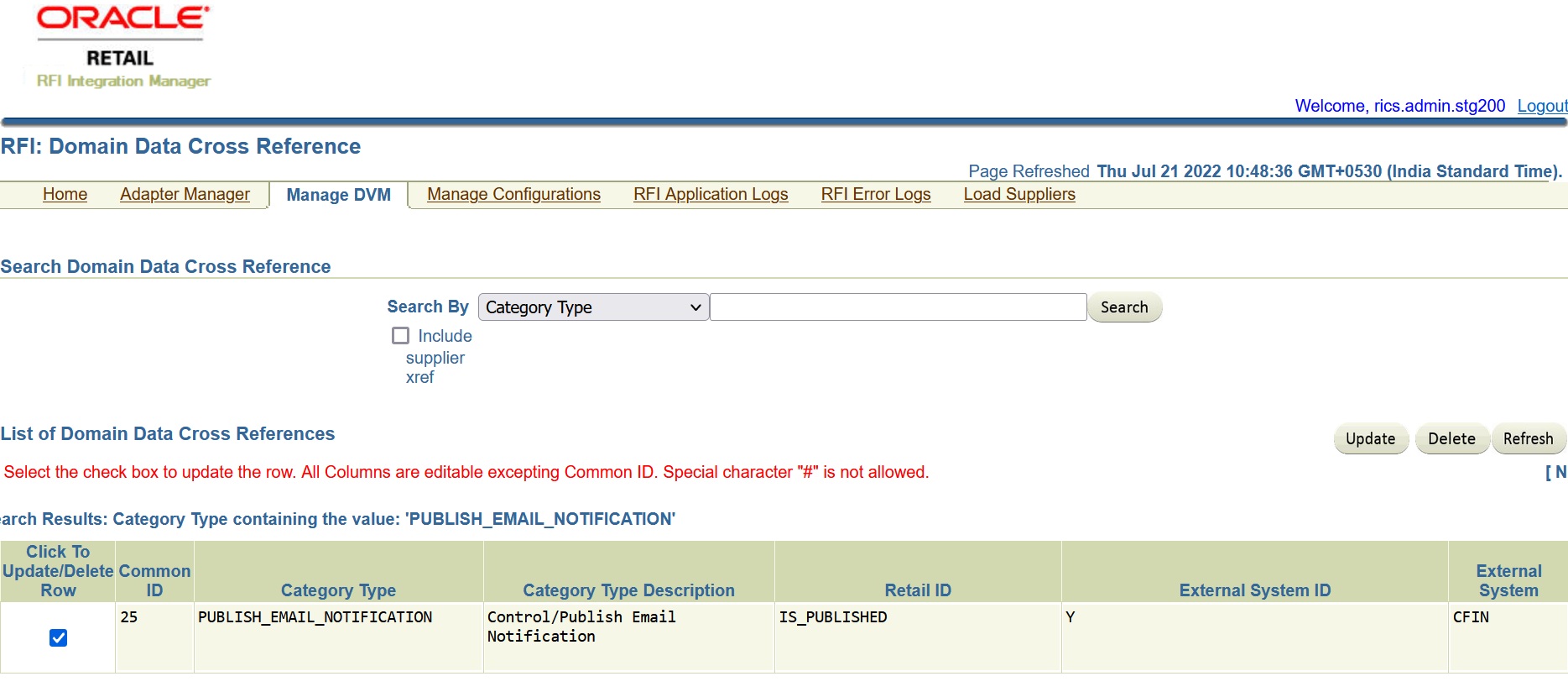

Working with Domain Value Maps (DVM)
DVM's are tables containing mapping between related information in the participating applications. They enable you to equate lookup codes and other static values across applications, for example, FOOT and FT or US and USA. These DVM tables are maintained in the RFI layer. The RFI layer uses these DVM tables in transforming the messages from one system in the expected format of the other system.
DVM types are seeded for the Oracle Retail to Oracle Financials flows, and administrators can extend the list of mapped values by adding more maps. The DVM data should be synchronized with what the participating applications use. This synchronization should occur before any initial loads are run or any incremental transactional flows are initiated.
RFI uses the same table RFI_XREF_DVM to store XREF and DVM information, the differentiator is the CATEGORY_TYPE column.
DVM and Xref (Manual Sync) is not pre-seeded, the values have to be entered manually as give in the sections below.
The following table lists the DVMs for the Oracle Retail to Oracle Financials RFI:

RFI - Manage DVM Graphical User Interface
The RFI UI includes a page "Manage DVM" for viewing, searching, browsing and editing the Cross References (XREF) and DVM records setup in RFI.
Figure 6-2 RFI - Manage DVM Graphical User Interface
When user navigates to the Manage DVM page, it displays the list of all XREF and DVM records in RFI. User can search for specific records based on a field value using the Search By form in the page. In order to search for records, select corresponding field name in the 'Search By' list based on which the search needs to done. And enter the value to search for in the adjacent text box.
The search will query and display records that match the search string entered. The search is also case-insensitive and has wild card searches.
Example: select Search By 'Category Type' and enter 'dvm' (without quotes) in the search text box, and click 'Search', the page will display all the records with Category Type containing 'dvm' string, say, records with Category Type such as, 'COA_STATUS_DVM', 'SUPPLIER_ADDRESS_TYPE_DVM', 'CURR_CODE_DVM', 'DVM_STATE' , 'RFI_DVM_FOR_BUSINESS_UNIT' and so on.
Clicking 'Refresh' button in the page will refresh the page with list of all records. The page will also highlight the record count statistics i.e., 'No. Of Records' fetched / displayed.
In cases when the search string is not found or in the DVM table with matching criteria, error message is displayed indicating no record matching i.e 'No data found for the specified search criteria'.
User can also Update, Delete or Add the DVM/xref data using this screen. User needs to select the record by clicking on row level checkbox in order to make any modification to any record.
By default the supplier related xrefs (SUPPLIER_XREF, SUPPLIER_SITE_XREF, SUPPLIER SITE_NAME_XREF) will not be loaded in initial load of page as well as on search to improve the performance of search. A checkbox is present to enforce the supplier related xref inclusion in search. This check box will auto unchecked after page gets refreshed.

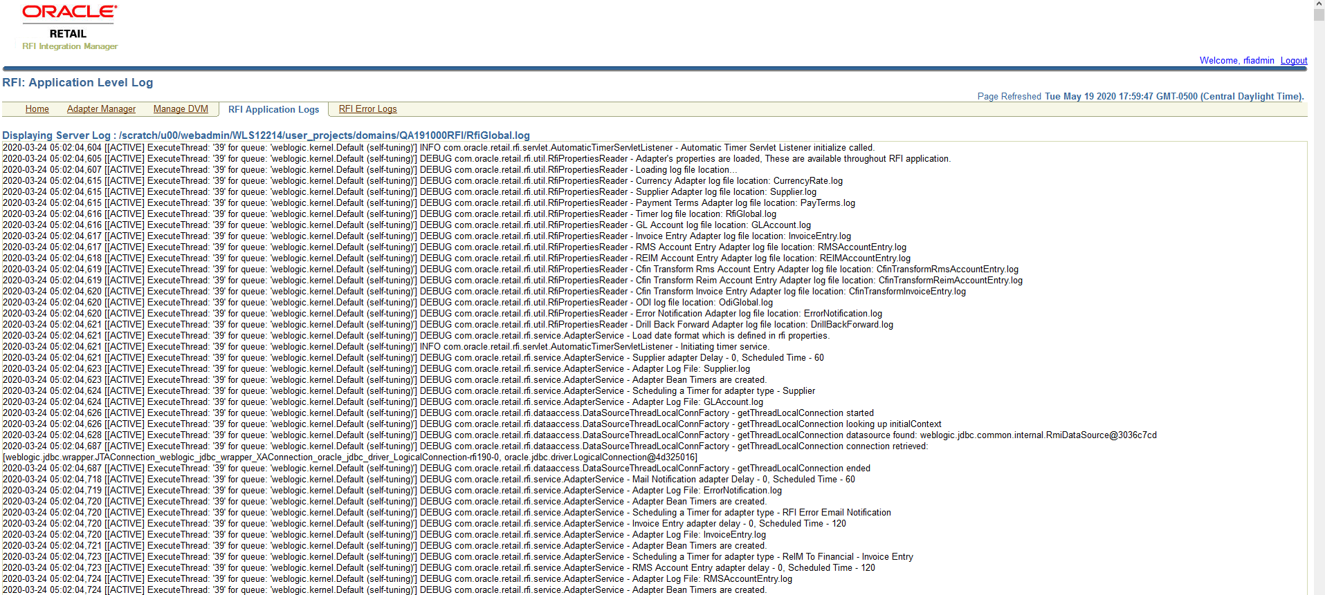

Supplier Information and GL Account Validation Integration Flows
The errors are logged in Supplier.log and GLAccount.log log files respectively. These log files are created in the Application Server where RFI application is deployed.
The logs can be viewed from the RFI Adapter Manager Screens. The RFI Adapter Manager can be accessed using the URL:
http://<Application Server Name>:<Port>/<RFI Application Deployed Name>
The following information is available in the logs
DVM/XREF mapping not available
Any error returned by Web service
Any RFI application errors
Any other ODI errors during execution are logged in the RFI_ODI_LOGS table.
If there are any interface errors or transformation error records, an error notification is sent from RFI Adapter Manager to the To Email Address list specified during RFI deployment. The adapter logs can be viewed from the RFI Adapter Manager Screens. The RFI Adapter Manager screens can be accessed using the URL:

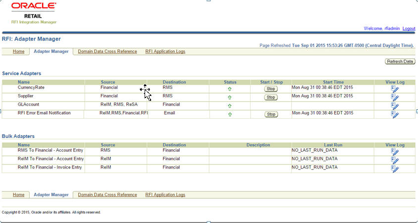

Understanding the RFI Administration User Interface
RFI provides an Administration UI where the Integration adapter timers could be started/stopped and also the logs can be viewed for the individual adapters. The RFI Administration user interface can be accessed using the URL:
Scheduling Adapters
Schedulers are created for the RFI Integration Adapters at the time of RFI Application deployment. The following adapter schedule can be updated by changing values of below mentioned properties configured at the time of deployment:

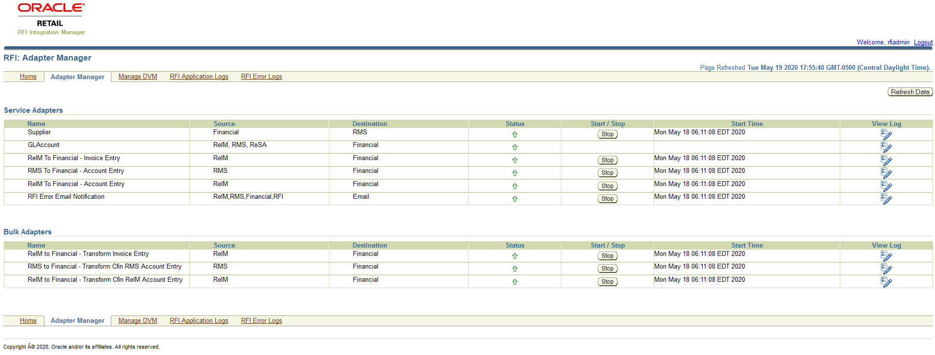

The adapters can be stopped/started from the RFI Adapter Manager Screens Logs. (The errors are logged in Supplier.log and GLAccount.log log.) These log files are created in the Application Server where the RFI application is deployed. The logs can be viewed from the RFI Adapter Manager Screens.
RFI Error email notifications are turned off by default. Users can turn it ON anytime by updating the value of DVM 'PUBLISH_EMAIL_NOTIFICATION'.
Follow the steps below to enable error email notification.
Login to the RFI application with valid credentials.
Navigate to the Manage DVM tab.
Search for Category Type 'PUBLISH_EMAIL_NOTIFICATION'.
Update the value of the EXT_SYSTEM_ID column to N and save changes.
Figure 6-4 Enable Email Notification
Global Logs
Global Logs for Adapter Timers are logged in RfiGlobal.log file and can be viewed from the RFI Adapter Manager screens.
Figure 6-5 RFI Application Logs Screen
Figure 6-6 RFI Adapter Manager Screen - RSFT/EBS
Figure 6-7 RFI Adapter Manager Screen - CFIN
In the above screens, the option of Payterms Service Adapter would be available only if PeopleSoft is the Oracle Financials system.

Runtime System Configurations
User can update configurations at RFI using various UI options available at RFI web page. But there are possibilities that these configurations may be overwritten while upgrading RFI from one version to other. RFI runtime configuration framework is developed as solution to these problems which preserves configurations updated via UI in database.
The runtime configurations help to preserve the customer specific configurations between the patches. These properties are preserved and restored from DB table RFI_RUNTIME_CONFIG_OVERRIDE and merged into rfi.properties. Any updates to these parameters are persisted in database. These properties are Adapter specific and for new configuration property a support ticket is required.
Below are some of the parameters which can be updated through the UI screens:
autoPurgeDelay. – Default 30
rfi.mail.to.addr.list
Adapter Timers – Interval default 10
Figure 6-8 RFI Manage System Configurations Screen
Service Configurations
The Service configurations UI Screen helps to provision to update the connection details for external application/services URLs. For example, to update hostname and port. Also, for provisioning updating of the security details for external application/services. For example, to update username and password for an alias of other Integrated RFI services like RMS, CFIN. This is useful during the password rotation scenarios i.e., when the other applications have their passwords rotated.
Figure 6-9 RFI Manage Service Configurations Screen
Figure 6-10 RFI Manage Service Configurations Screen
Users will be provided option either update connection details or security details or both. Update of connection and security details will apply to all the services in scope.
Updating connection details will update the service/URLs in the UI and the properties file
Updating security details will update the credentials in the UI and the corresponding wallet

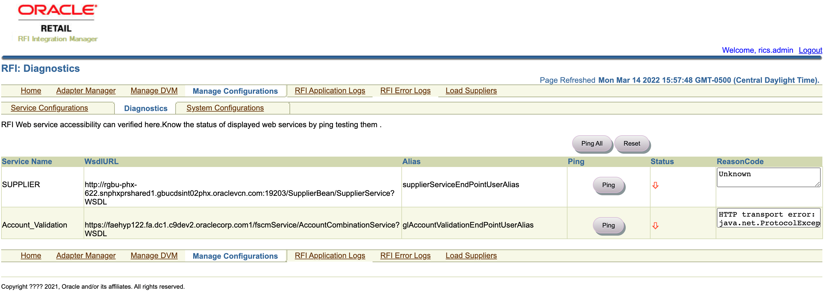

Diagnostics Configurations
The diagnostics screen is added in RFI under Manage Configurations which will list all the web services consumed by RFI. This ping features checks connectivity from RFI to other Integrated systems. As depicted in the screenshot, the table shows the Service Name, WSDL URL, Alias and Ping button and status for each web service.
Ping All and reset button are also available to ping all listed services and to reset to default ping statuses.
The ping feature internally uses the rfi.properties to get the services list.
Supplier service: Supplier service from RMS offers ping operations. RFI supplier service includes method to invoke ping operation for supplier service from RMS.
Account Combination service: Account Combination service from CFIN does not offer any ping operations. RFI invokes account combination service offered by CFIN with default values. Successful response (status field of response is set to "invalid" as request has default combination.) from CFIN will confirm connectivity to CFIN from RFI.
If deep ping in step #2 is successful, it ensures that even credentials set up in RFI for CFIN web services are valid.
Figure 6-11 RFI Diagnostics Screen
Click the Ping button to check connectivity of listed service. Red in the Status column indicates an error in connectivity. Green in the Status column indicates successful connectivity.
Click the Ping All button to ping all listed web services. Check the Status column to know status of ping.
Click the Reset button to reset previous ping status.
