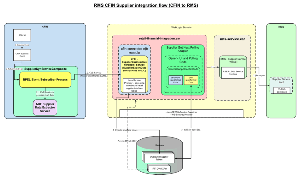

Financials Cloud:-Supplier Integration Details
This diagram illustrates the supplier integration flow with Financials Cloud:
Figure 2-1 RMS CFIN Supplier Integration Flow
cfin rms integration
These services are specific to sync supplier integration flows:
  • SUPPLIEREXPORTOUTBOUNDSERVICE - Supplier Export Outbound Service
  • Supplier EJB Service
  • RMS Supplier Service
  • RIBforRMS Vendor Subscriber
Supplier Sequence Incremental Load
When you initiate the process:
  1. Oracle Payables invokes the "SUPPLIEREXPORTOUTBOUNDSERVICE" Business Event service with Supplier payload message whenever a supplier is created or updated (by passing complete supplier extract for updated/new supplier). Any errors during service call could be found on notification section on CFIN UI. This RFI Export Service URL needs to be configured in CFIN side so that CFIN can invoke it.
  2. The export outbound service extracts all the supplier, supplier sites and supplier contacts from incoming Cloud Financials message and moves the supplier, supplier sites and supplier contacts into RFI Database Staging tables RFI_SUPP_STAGE, RFI_ SUPP_SITES_STAGE, RFI_SUPP_CONTACTS_STAGE respectively. Any error during stage data load could be found on RFI_ODI_LOGS table (rfi app schema).
  3. A Configured Timer for RFI Supplier service invokes the Supplier EJB service. By Default this service runs at every 10 mins.
  4. The Supplier EJB service picks up the records from the RFI Database Staging tables RFI_SUPP_STAGE, RFI_SUPP_SITES_STAGE, RFI_SUPP_CONTACTS_STAGE and transforms the Organization id using ORG_ID_XREF, Currency Code using CURR_CODE_DVM, Language using LANGUAGE_DVM, Payment terms and Freight terms using PAYMENT_TERMS_XREF and FREIGHT_TERMS_XREF respectively. Any error for missing DVM/XREF will be reported in RFI supplier.log. Check Adapter log for such details. Only when Supplier fails with any data error then 'is_data_processed ind' of that supplier turns to 'E'.
    For valid data, RFI then invokes the RMS Supplier Service is invoked -with the transformed supplier records. This RMS service creates the actual supplier in RMS. If there are any errors in Supplier EJB service, the errors are added to the logs file and also to the RFI_ODI_LOGS table. The Supplier logs can be viewed using the RFI Adapter Manager screens in RFI Administration GUI and Logs table can be viewed from View Logs screen.
  5. If the transaction from RMS is successful, Retail Id cross references for supplier, supplier site and supplier site name are stored in the cross reference table RFI_XREF_DVM. The cross references updated is SUPPLIER_XREF, SUPPLIER_SITE_XREF and SUPPLIER_SITE_NAME_XREF respectively.
    Transformation applies the DVM and invokes create or update web service from RMS. It also updates the cross-reference table after the Retail web service call. This RMS service URL needs to be configured in RFI side.

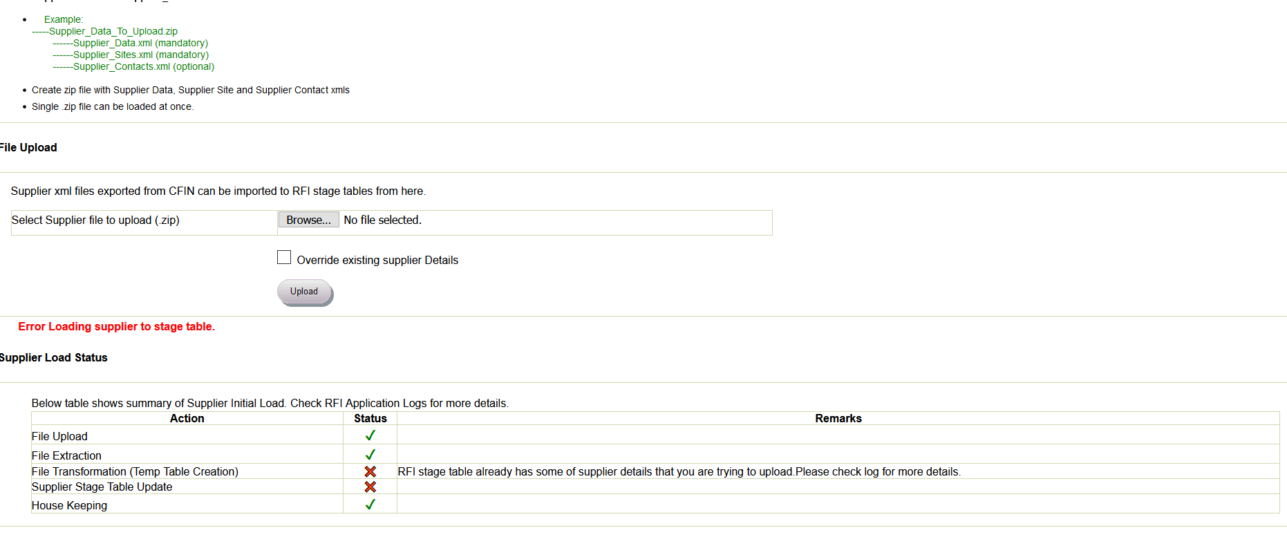

RFI then process the staged records via supplier adapter. Any error found during the conversion of stage record to payload creation for RMS will be logged into RFI logs (supplier.log). There are two types of validation in RFI while processing stage supplier data:
  1. Data compatibility validation (If any of purchasingSiteFlag & paySiteFlag values are not set for any of the sites for that supplier it will be errored out, not a fit for RMS).
  2. DVM xref validation for data (If any of the required DVMs are missing then RMS supplier service will not be called until that missing DVM is fixed).
Assumptions/Conditions:
If any stage supplier data fails at data compatibility validation then it means data needs to be corrected manually or sent again to RFI STAGE table through financial systems. IS_PROCESSED status of that stage supplier record will be marked as 'E' in RFI_SUPP_STAGE table. These record will then be ignored from next run of supplier service. These records will stay in stage table until customer gets it deleted manually. Logs will capture IS_PROCESSED indicator change for that supplier for further analysis.
Records failed due to DVM xref validation will not go through status change as DVM data can be corrected and same supplier data can be processed without any change. All the missing DVM errors will be logged in RFI logs.
  • Processed supplier data will be auto purged from stage table during next execution cycle.
  • Any supplier failed due to missing DVM/XREF will stay in stage table and will get reprocessed in next execution cycle again. User needs to check Error log for failure details.
  • In one execution cycle only latest 1000 supplier records will be processed. Other pending records will be picked on next subsequent cycles.

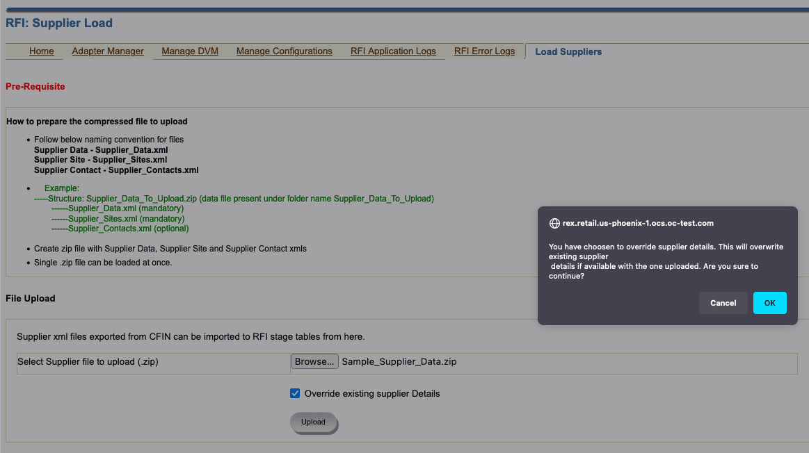

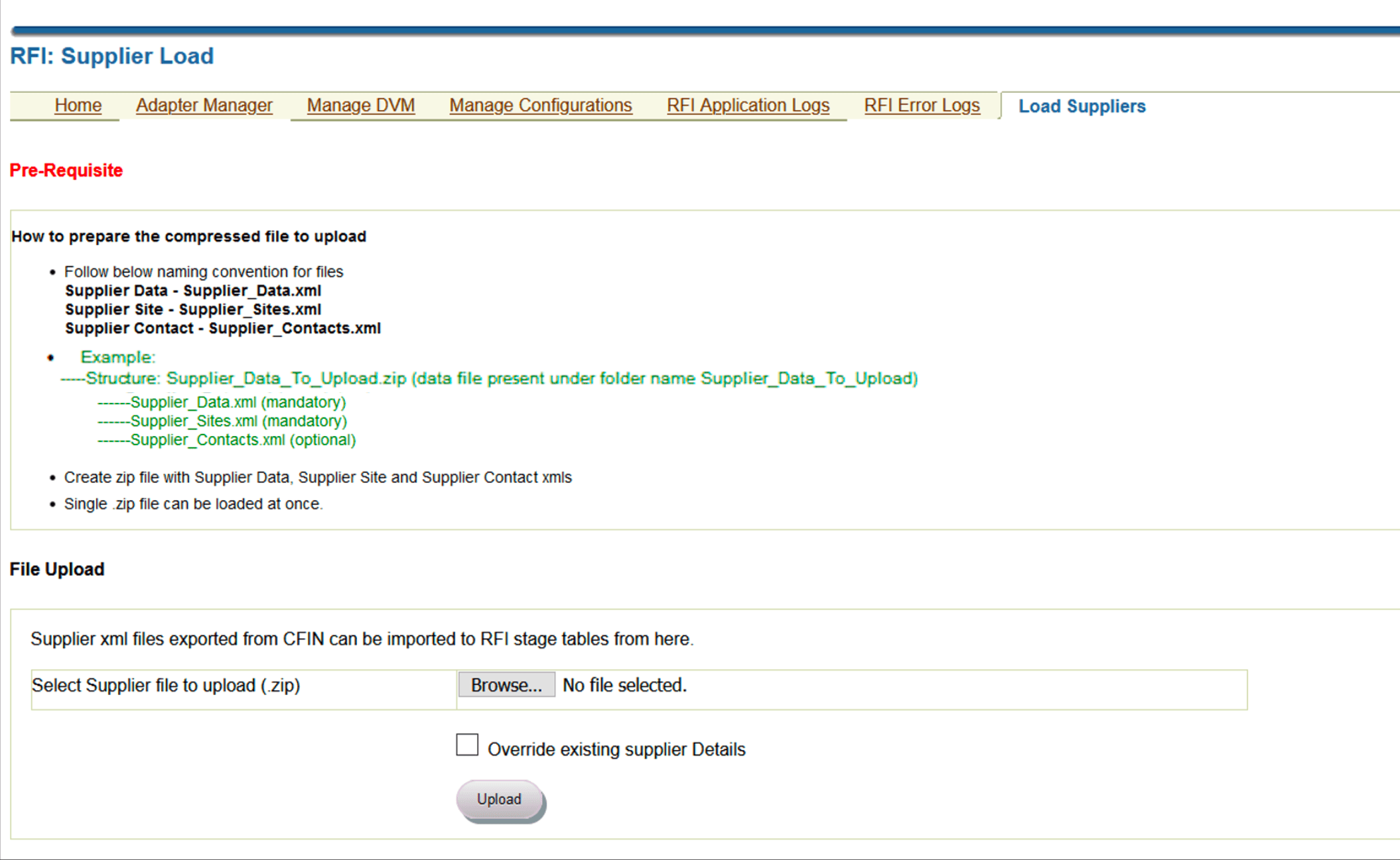

Start or Run Initial Load of Supplier Parties from CFIN

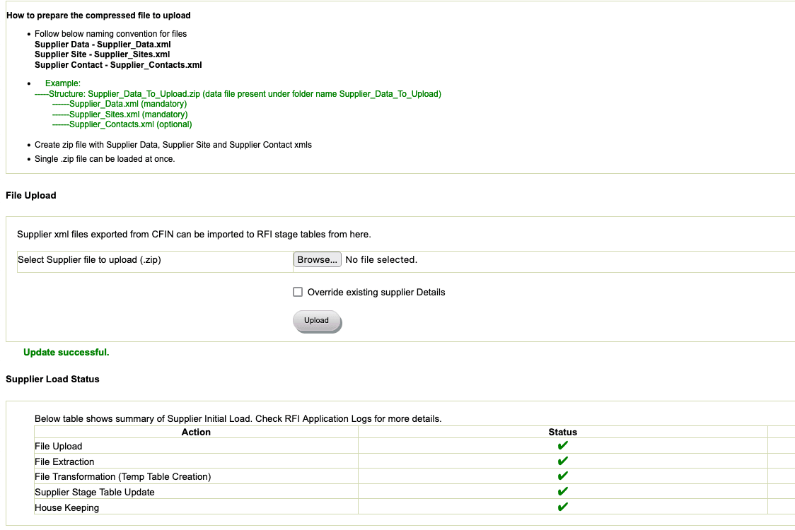

The purpose of this flow is to load the existing active Suppliers, Supplier Sites, and Supplier Contacts from CFIN into Retail.
These are the steps to load the Supplier details initially from Oracle CFIN to Retail.
Download supplier data from CFIN: The first step is to extract the supplier profile data from CFIN. This can be done as follows.

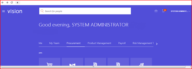

  1. Login to CFIN. You need to have access to the Oracle ERP Cloud Procurement module and to the Oracle Business Intelligence module to perform this task.
    CFIN login

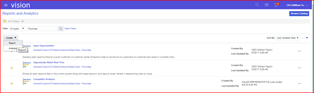

  2. On the left-hand side menu go to Tools and then Reports and Analysis.
    reports and analytics
  3. There is no standard repost in CFIN to extract the required supplier data. Therefore you need to create a new report for this purpose.
    create report

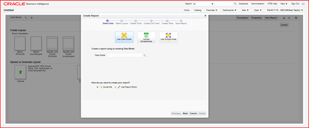

  4. The system will then open the Oracle Business Intelligence on the Create Report screen. Click Cancel on the wizard dialog.
    create report screen

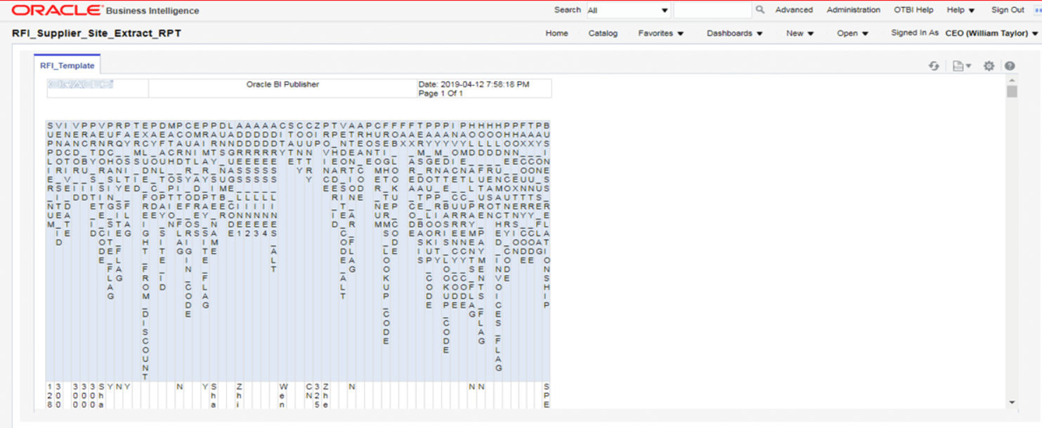

    If there are no supplier contacts, RFI will generate a supplier contact with description NO CONTACTS as contacts as mandatory in Oracle Retail.
    Supplier Site Invoice Currency, Supplier Site Payment Terms and Supplier Site Freight Terms, although not mandatory in CFIN, are required, as mandatory attributes in the extraction.

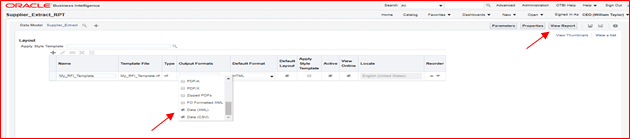

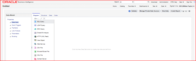

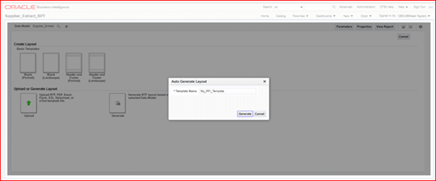

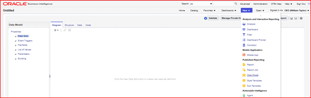

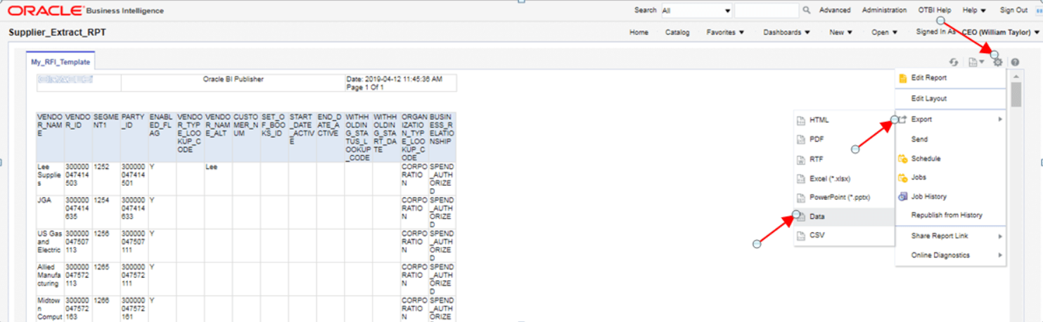

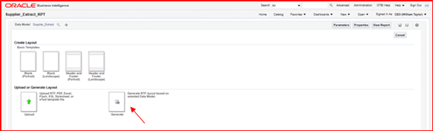

  6. To start the extraction process, click New on the Oracle Business Intelligence home page and then, on the drop-down menu Data Model. Please note you need to have the right access privileges to access the creation of new Data Models in Oracle Business Intelligence.
    create data model

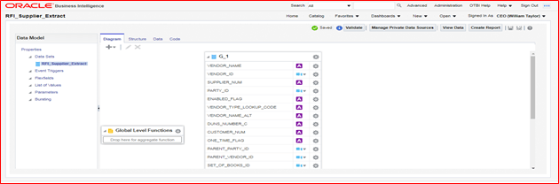

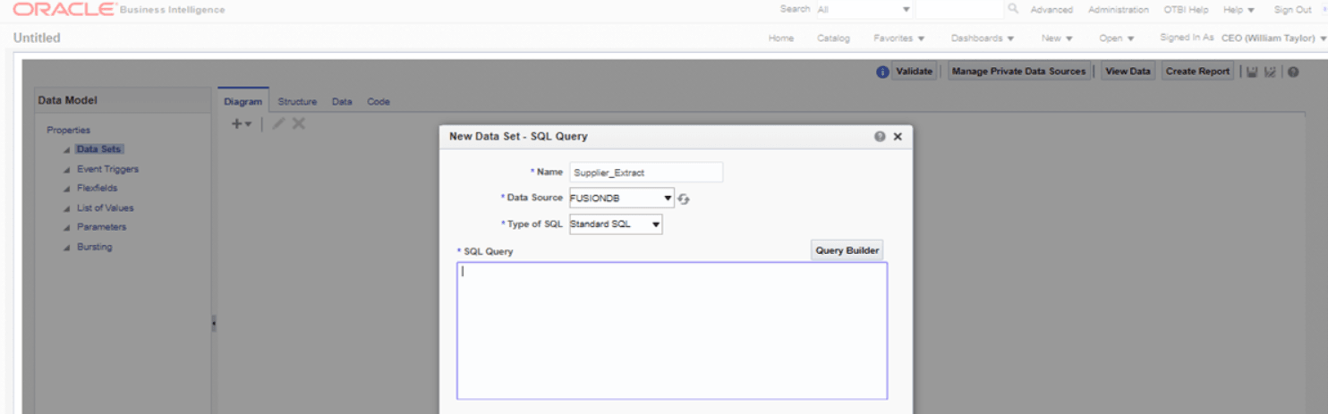

  7. On the Data Model screen, tab Diagram, click SQL Query.
    sql query

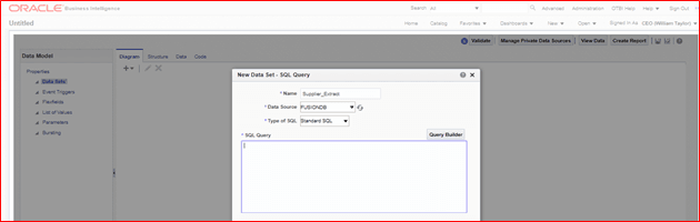

  8. Then, give a name to your Data Model, choose the Data Source which in a standard implementation would be FUSIONDB. Please note that in your implementation this maybe have a different name so choose the Data Source where your Oracle Procurement Cloud module is implemented.
    new data set screen
  9. Then, on the SQL Query text area copy and paste the following SQL statement and click OK.

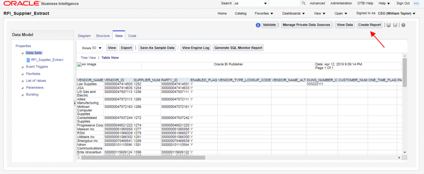

    This will extract all the Suppliers that are approved for transactions on the system (i.e. Business Relationship = "SPEND_AUTHORIZED").
    You need to replace the name of the schema on the SQL statement (i.e. "from"FUSION"."POZ_SUPPLIERS_V" "POZ_SUPPLIERS_V") with the name of the schema of your implementation.

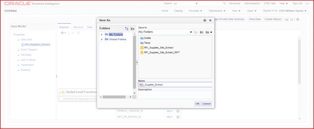

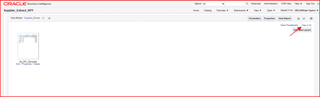

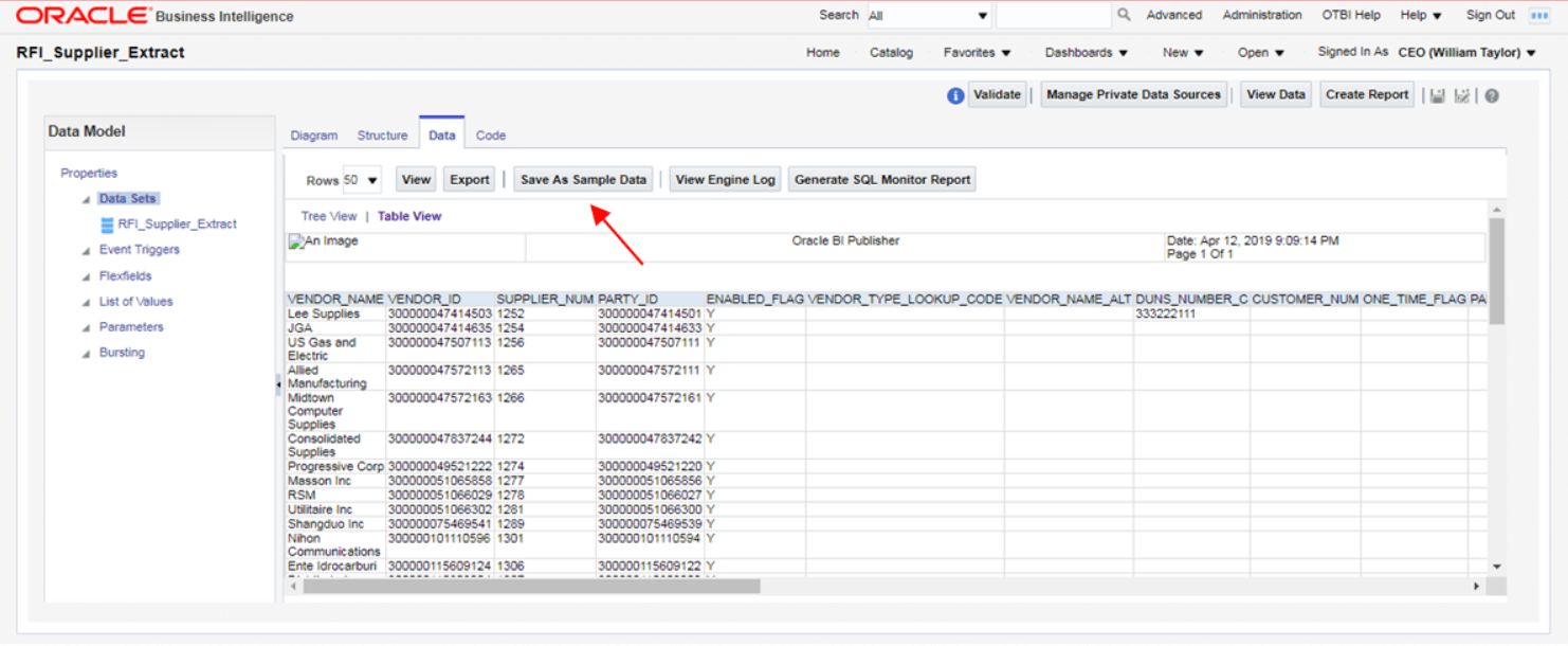

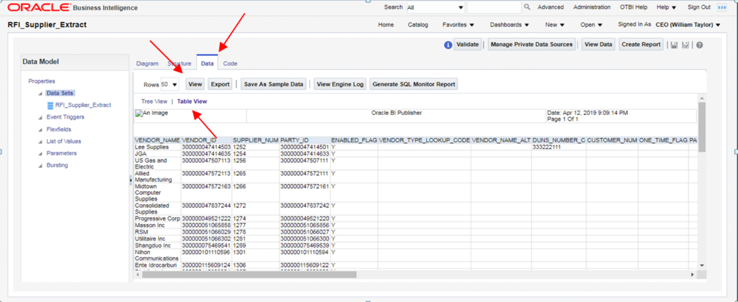

  10. The system will generate the data model and display it on the screen. Save the data model to your personal folder.
    save the data model
    save as screen
  11. Click on the Data tab, option View and the option Table View.
    table view
  12. Save the sample data by clicking on Save As Sample Data.
    save as sample data
    sample data
  13. Then, save the data model again and click the option Create Report.
  14. Then, the system will display the Create Report screen. The data model you just created will appear in the Data Model field. Then click on the option Use Report Editor option and then Finish. At this point the system will ask you to save your report.
  15. After you save the report, the system will display the Report Editor. Choose the option Generate RTF layout based on selected Data Model.
    generate rtf layout
  16. Generate this layout as your template (give it a name and click Generate).
    generate layout
  17. The system will generate the report template. Click on the option View List.
    view list
  18. On the Output Formats column tick the Data option and also the Apply Style Template option.
    apply style template
  19. Save the report and then click on the View Report option. The system will display the report and the related data. Then export the data by clicking on the option Export and then Data.
    export data
  20. The system will generate a XML file and will prompt you to save it to your localhost. For this extraction the procedure is concluded.

  22. On the SQL Query text area copy and paste the following SQL statement and click OK:
    select "POZ_SUPPLIERS_V"."SEGMENT1" as "SUPPLIER_NUM", "POZ_SUPPLIER_SITES_V"."VENDOR_SITE_ID" as "VENDOR_SITE_ID", "POZ_SUPPLIER_SITES_V"."INACTIVE_DATE" as "INACTIVE_DATE", "POZ_SUPPLIER_SITES_V"."VENDOR_ID" as "VENDOR_ID", "POZ_SUPPLIER_SITES_V"."PRC_BU_ID" as "PRC_BU_ID", "POZ_SUPPLIER_SITES_V"."PARTY_SITE_ID" as "PARTY_SITE_ID", "POZ_SUPPLIER_SITES_V"."VENDOR_SITE_CODE" as "VENDOR_SITE_CODE", "POZ_SUPPLIER_SITES_V"."PURCHASING_SITE_FLAG" as"PURCHASING_SITE_FLAG", "POZ_SUPPLIER_SITES_V"."RFQ_ONLY_SITE_FLAG" as "RFQ_ONLY_SITE_FLAG", "POZ_SUPPLIER_SITES_V"."PAY_SITE_FLAG" as "PAY_SITE_FLAG", "AP_TERMS_TL"."NAME" as "TERMS_ID", "POZ_SUPPLIER_SITES_V"."EXCLUDE_FREIGHT_FROM_DISCOUNT" as"EXCLUDE_FREIGHT_FROM_DISCOUNT", "POZ_SUPPLIER_SITES_V"."PAY_ON_CODE" as "PAY_ON_CODE", "POZ_SUPPLIER_SITES_V"."DEFAULT_PAY_SITE_ID" as"DEFAULT_PAY_SITE_ID", "POZ_SUPPLIER_SITES_V"."MATCH_OPTION" as "MATCH_OPTION", "POZ_SUPPLIER_SITES_V"."PCARD_SITE_FLAG" as "PCARD_SITE_FLAG", "POZ_SUPPLIER_SITES_V"."COUNTRY_OF_ORIGIN_CODE" as"COUNTRY_OF_ORIGIN_CODE", "POZ_SUPPLIER_SITES_V"."EMAIL_ADDRESS" as "EMAIL_ADDRESS", "POZ_SUPPLIER_SITES_V"."PRIMARY_PAY_SITE_FLAG" as"PRIMARY_PAY_SITE_FLAG",
    "POZ_SUPPLIER_SITES_V"."PARTY_SITE_NAME" as "PARTY_SITE_NAME", "POZ_SUPPLIER_SITES_V"."DUNS_NUMBER" as "DUNS_NUMBER", "POZ_SUPPLIER_SITES_V"."LANGUAGE_CODE" as "LANGUAGE_CODE", "POZ_SUPPLIER_SITES_V"."ADDRESS_LINE1" as "ADDRESS_LINE1", "POZ_SUPPLIER_SITES_V"."ADDRESS_LINE2" as "ADDRESS_LINE2", "POZ_SUPPLIER_SITES_V"."ADDRESS_LINE3" as "ADDRESS_LINE3", "POZ_SUPPLIER_SITES_V"."ADDRESS_LINE4" as "ADDRESS_LINE4", "POZ_SUPPLIER_SITES_V"."ADDRESS_LINES_ALT" as "ADDRESS_LINES_ALT", "POZ_SUPPLIER_SITES_V"."CITY" as "CITY", "POZ_SUPPLIER_SITES_V"."STATE" as "STATE", "POZ_SUPPLIER_SITES_V"."COUNTY" as "COUNTY", "POZ_SUPPLIER_SITES_V"."COUNTRY" as "COUNTRY", "POZ_SUPPLIER_SITES_V"."ZIP" as "ZIP", "POZ_SUPPLIER_SITES_V"."PROVINCE" as "PROVINCE", "POZ_SUPPLIER_SITES_V"."TP_HEADER_ID" as "TP_HEADER_ID", "POZ_SUPPLIER_SITES_V"."VENDOR_SITE_CODE_ALT" as"VENDOR_SITE_CODE_ALT", "POZ_SUPPLIER_SITES_V"."ATTENTION_AR_FLAG" as "ATTENTION_AR_FLAG",
    "POZ_SUPPLIER_SITES_V"."AREA_CODE" as "AREA_CODE", "POZ_SUPPLIER_SITES_V"."PHONE" as "PHONE", "POZ_SUPPLIER_SITES_V"."CUSTOMER_NUM" as "CUSTOMER_NUM", "POZ_SUPPLIER_SITES_V"."FREIGHT_TERMS_LOOKUP_CODE" as"FREIGHT_TERMS_LOOKUP_CODE", "POZ_SUPPLIER_SITES_V"."FOB_LOOKUP_CODE" as "FOB_LOOKUP_CODE", "POZ_SUPPLIER_SITES_V"."FAX" as "FAX", "POZ_SUPPLIER_SITES_V"."FAX_AREA_CODE" as "FAX_AREA_CODE", "POZ_SUPPLIER_SITES_V"."TERMS_DATE_BASIS" as "TERMS_DATE_BASIS", "POZ_SUPPLIER_SITES_V"."PAY_GROUP_LOOKUP_CODE" as"PAY_GROUP_LOOKUP_CODE", "POZ_SUPPLIER_SITES_V"."PAYMENT_PRIORITY" as "PAYMENT_PRIORITY", "POZ_SUPPLIER_SITES_V"."PAY_DATE_BASIS_LOOKUP_CODE" as"PAY_DATE_BASIS_LOOKUP_CODE", "POZ_SUPPLIER_SITES_V"."INVOICE_CURRENCY_CODE" as"INVOICE_CURRENCY_CODE", "POZ_SUPPLIER_SITES_V"."PAYMENT_CURRENCY_CODE" as"PAYMENT_CURRENCY_CODE", "POZ_SUPPLIER_SITES_V"."HOLD_ALL_PAYMENTS_FLAG" as"HOLD_ALL_PAYMENTS_FLAG", "POZ_SUPPLIER_SITES_V"."HOLD_FUTURE_PAYMENTS_FLAG" as"HOLD_FUTURE_PAYMENTS_FLAG", "POZ_SUPPLIER_SITES_V"."HOLD_REASON" as "HOLD_REASON", "POZ_SUPPLIER_SITES_V"."HOLD_UNMATCHED_INVOICES_FLAG" as"HOLD_UNMATCHED_INVOICES_FLAG", "POZ_SUPPLIER_SITES_V"."PHONE_COUNTRY_CODE" as "PHONE_COUNTRY_CODE", "POZ_SUPPLIER_SITES_V"."PHONE_EXTENSION"
    as "PHONE_EXTENSION", "POZ_SUPPLIER_SITES_V"."FAX_COUNTRY_CODE" as "FAX_COUNTRY_CODE", "POZ_SUPPLIER_SITES_V"."TAX_COUNTRY_CODE" as "TAX_COUNTRY_CODE", "POZ_SUPPLIER_SITES_V"."PAY_ON_USE_FLAG" as "PAY_ON_USE_FLAG", "POZ_SUPPLIERS_V"."BUSINESS_RELATIONSHIP" as "BUSINESS_RELATIONSHIP", "POZ_SUPPLIER_SITES_V"."LOCATION_ID" as "LOCATION_ID" from "FUSION".POZ_SUPPLIERS_V" "POZ_SUPPLIERS_V", "FUSION".POZ_SUPPLIER_SITES_V" "POZ_SUPPLIER_SITES_V", "FUSION"."AP_TERMS_TL" "AP_TERMS_TL" where "POZ_SUPPLIER_SITES_V"."VENDOR_ID"=POZ_SUPPLIERS_V.VENDOR_ID and ("POZ_SUPPLIER_SITES_V"."PURCHASING_SITE_FLAG"='Y' or"POZ_SUPPLIER_SITES_V"."PAY_SITE_FLAG"='Y') and "POZ_SUPPLIER_SITES_V"."TERMS_ID" = "AP_TERMS_TL"."TERM_ID" and "AP_TERMS_TL"."LANGUAGE"='US' and "POZ_SUPPLIERS_V"."BUSINESS_RELATIONSHIP" ='SPEND_AUTHORIZED'
    This will extract only Purchasing and Payment Supplier Sites.
    You need to replace the name of the schema on the SQL statement (i.e. "from"FUSION"."POZ_SUPPLIERS_V" "POZ_SUPPLIERS_V" ) by the name of the schema of your implementation.

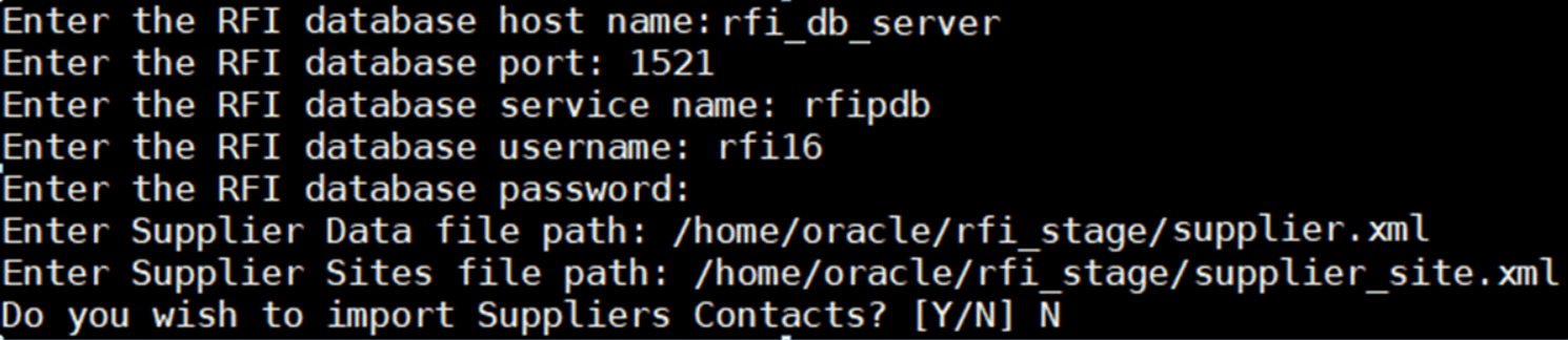

  2. Run supplier_initial_load.sh (./supplier_inital_load.sh).
  3. The script will request some information to perform correctly:
    • Oracle RFI database server hostname (rfi_db_server)
    • Oracle RFI database port (1521)
    • Oracle RFI database service name (rfipdb)
    • Oracle RFI database username (rfi_db_user)
    • Oracle RFI database password
    • File path for Supplier data extracted from CFIN (No white spaces should be present in the file path)
    • File path for Supplier Sites data extracted from CFIN (No white spaces should be present in the file path)
    • If you chose to integrate Contacts, file path for Supplier Site Contacts data extracted from CFIN (No white spaces should be present in the file path)

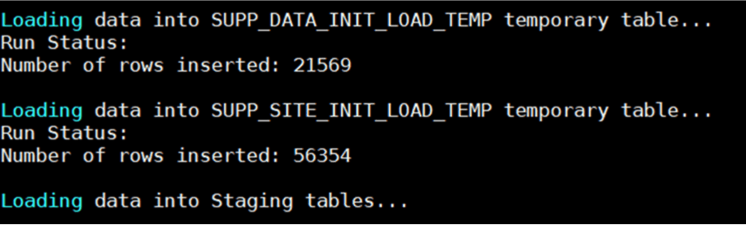

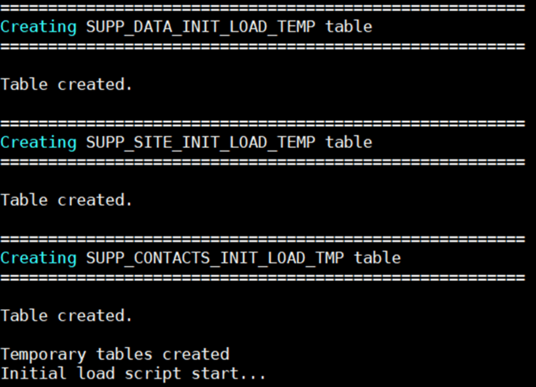

  4. Temporary tables will be created.
    tables created
  5. Data will be loaded into Temporary tables.
    data loaded

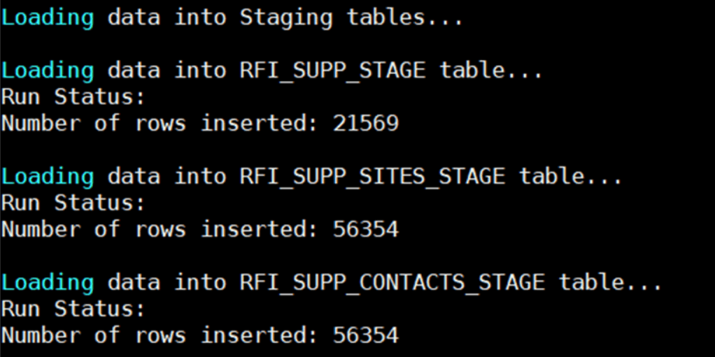

  6. Suppliers, Supplier Sites, Supplier Contacts records are pushed to RFI Staging tables RFI_SUPP_STAGE, RFI_SUPP_SITES_STAGE, and RFI_SUPP_CONTACTS_STAGE respectively and temporary tables dropped.
    records pushed to staging tables
  7. The number of rows inserted into Temporary tables should be the same for staging tables.

RFI Supplier upload by UI screen: Follow below steps to upload the supplier through UI-
  1. Login to the RFI UI with valid credentials. Navigate to the Load Suppliers tab.
  2. Create a compressed file (.zip) with Supplier xmls exported from CFIN. It is mandatory to follow below naming convention for suppliers to be loaded successfully. Make sure the CSV files doesn’t have any control m characters in them, else it would fail upload. Keep all the required files inside a folder and then zip them.
  3. Read the Pre-Requisite section carefully before uploading files.
    Supplier Upload Pre-Requisites
  4. Click the Browse button under the File upload section. Browse for the .zip file created in the above step.
  5. Click the Override existing supplier Details check box to override existing suppliers (if found) with the details specified in the xml. A confirmation window appears asking to confirm selections.
    Supplier Upload Confirmation
  6. Click OK to continue with the current selection or Cancel to reselect.
    RFI does not support partial update of supplier details.
  7. If the supplier ID that you are trying to upload is already available in RFI stage tables and the Override existing supplier Details check box is checked, then all details about that supplier are deleted from the RFI stage tables and the new details specified in the xml are loaded into the stage table.
  8. If the supplier ID that you are trying to upload is already available in RFI stage tables and the Override existing supplier Details check box is NOT checked, then the supplier load process is terminated with an exception and no data gets loaded into the RFI stage tables.
  9. The status of the supplier upload process is displayed in the Supplier Upload Status section. Navigate to the RFI Application Logs section for detailed logs.
    Supplier Upload Status Logs
    • A single .zip file can be uploaded at once. Multiple file upload is not supported.
    • No other file formats except .xml are supported.
    • Ensure that the zip file has single entry for Supplier Data, Supplier Site and Supplier Contact
