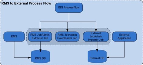

There are process flow dsl files for each interface from RMS to external and External to other applications which have all the activities for the particular interface as depicted in below pictures. Scheduler will trigger the process flow to execute the activities within the dsl file. Process flows are available out of box to move data end to end. The only thing to implement is extractor or importer packages or both.
Figure 6-2 Merchandising to External Process Flow
