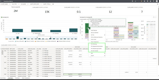

Once in the report, users can select the specific piece of information or data point that requires attention. By right-clicking on the selected item, a contextual menu will appear, offering the option to choose the relevant section within the IPO system where this information should be displayed. Upon selection, the IPO system will open in a new browser tab. The system is designed to recognize the data selected in the report, applying appropriate filters so that users are immediately presented with the most relevant information.
Figure 1-37 Right Click on Selected Portion of Data

Within each report you can launch into Inventory Planning to view the alert information in greater detail.
  1. To see these alerts in Inventory Planning, right-click the bar chart on the right and select
  2. Click Open IPO - Planning.
  3. The Inventory Planning application will launch already filtered to the products and locations from the report.
  4. Use the Cycle Area to select the desired product.
  5. The Plan View will update to show information about that product.
  6. Any alerts will be highlighted in the tables.
