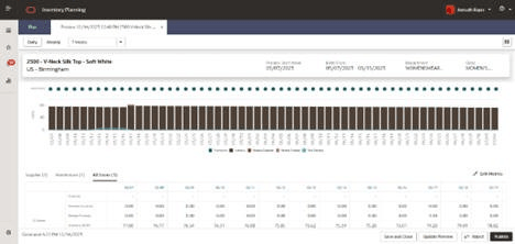

A preview is based upon a single product for a set of locations; it opens in a new tab within the IP application.
Their design is similar to a Plan View, with many common features such as:
- Aggregate chart
- Aggregate area with supply chain navigation
- Individual location tables with supply chain navigation
- Promotions
- Edit metrics
Figure 1-28 Preview
