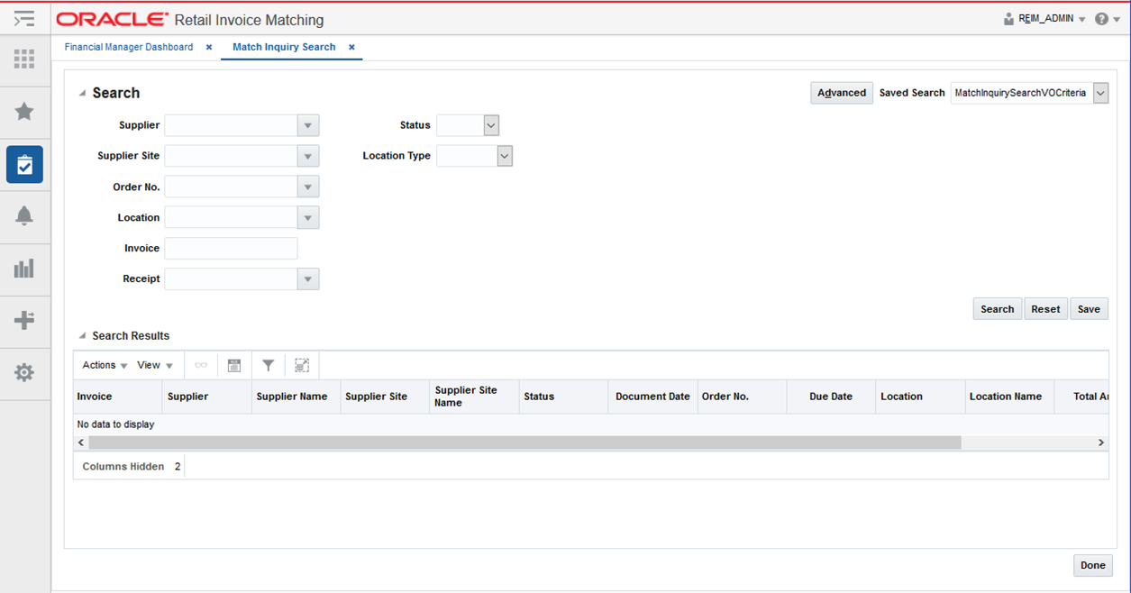

Navigate: From the Tasks menu, select Invoice Matching > Match Inquiry Search. The Summary Match Search window opens.
Figure 3-1 Match Inquiry Search Window
Perform a search for the invoice you want to unmatch. See "Search for Documents" for additional details.

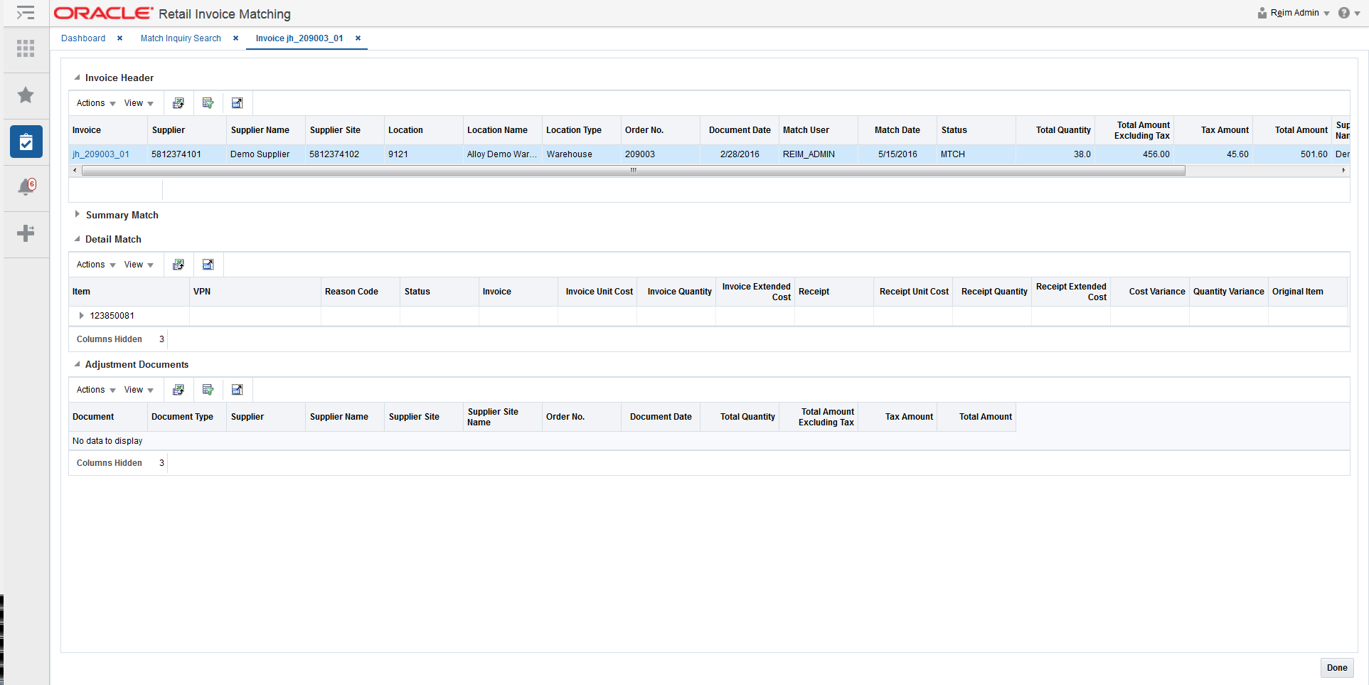

In the search results, click the invoice you want to unmatch. The Matched Invoice screen is displayed.
Figure 3-2 Matched Invoice Screen

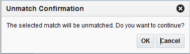

Select Unmatch from the Action menu. An Unmatch Confirmation dialog is displayed.
Figure 3-3 Unmatch Confirmation Dialog

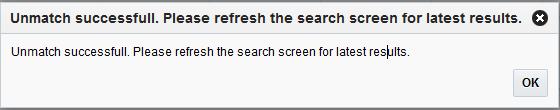

Click OK to confirm the unmatch. A dialog is displayed confirming that the unmatch was successful.
Figure 3-4 Unmatch Successful Dialog
Click OK. You are returned to the Match Inquiry Search screen.
