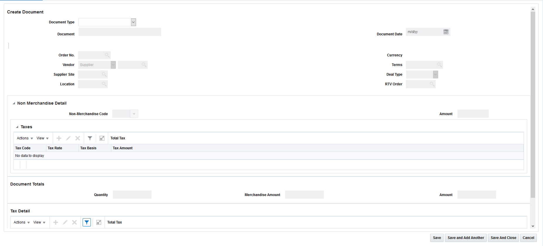

Navigate: From the Tasks menu, select Document Maintenance > Create Document. The Create Document screen opens.
Figure 1-1 Create Document
Open the Create Document screen. The Create Document screen is launched when the user chooses to create a Document through either of the one of the following:
Clicking the Create Document link under the Document Maintenance subgroup on the Global Navigation section
Select Create Document from the Actions menu on the Search Results Pane
In the Document Type field, select Merchandise Invoice. Once the Document Type is selected, the field is disabled and the Vendor Type is set to Supplier.
Header Information
In the Document field, enter the identifier for the Document in Invoice Match that is used in communication with the vendors and will be displayed to the end user. This must be unique by vendor, document type, and (optionally depending on system setting) by document date.
In the Document Date field, enter the date the invoice was created, or click the calendar button and select a date.
In the Order No. field, select the Purchase Order against which the Document (or Invoice) is raised.
If an Order No. is entered before the vendor, the vendor, supplier site, and terms will default to values from the purchase order. Additionally, if there is only one location on the purchase order, then the location will default to that location as well.
In the Vendor field, select the Supplier against which the Invoice is raised.
If a Supplier is specified before the Order No, the combo box list of values dropdown displays orders corresponding to all suppliers in the same supplier group as the supplier specified.
The Terms field defaults to the term of the specified PO. The defaulted value can be modified on the invoice document.
In the Supplier Site field, select the Supplier Site against which the Document (or Invoice) is raised.
In the Location field, select the Invoicing (Billing) Location from the list of valid locations (stores and physical warehouses). These locations are defined in Merchandising.
The Location field value is defaulted if the Order No selected has a single Location to which it is associated.
For import PO's the Import Location is used as the location in Invoice Match.
Non Merchandise Detail
The Non Merchandise Details section allows the addition of a single non merchandise code / amount to an invoice document as part of a quick entry flow. Additional codes and details can be entered using the Non Merchandise Details window available on the Document Maintenance screen.
In the Non Merchandise Code field, specify a single non merchandise code that is applicable to the document. Additional codes can be entered using the Non Merchandise Costs screen if needed.
In the Non Merchandise Amount field, specify the non merchandise amount corresponding to the Non Merchandise Code specified.
In a Global Tax environment, taxes associated with the non-merchandise codes can be entered into a tax table. Select the plus key on the tax table and a popup will appear allowing the entry of the tax code, tax rate, and tax basis. The OK and Add Another button allows multiple taxes to be associated with the non-merchandise code.
Document Totals
The Document Totals section allows the user to specify Total Merchandise Amount, Total Quantity, and Total Invoice Amount.
In the Quantity field, enter the total number of units on the document.
There is a supplier option that can be used to make the quantity field required.
The Merchandise Amount field represents the Total Merchandise Value excluding tax.
Total Merchandise Amount = Total Amount - Non Merchandise Amount - Tax Amount
The Amount field represents the total value of the document. This field is automatically populated with the sum of the Merchandise Amount, Non Merchandise Amount, and Tax Amount(s).
Tax Details
In a Single Tax Environment the Tax Detail section allows the addition of a single tax code, tax basis and amount to an invoice as part of a quick entry flow. Additional codes and details may be entered using the Tax Breakdown window available on the Document Maintenance screen.
In the Code field, specify the tax code applicable on the document at a header level.
The basis field is automatically calculated when the tax code is entered if the merchandise amount is entered first. The calculated amount can be overwritten.
The Amount field is automatically populated. It is computed by applying the tax code on the taxable basis if the tax code and basis are added first. The Amount field can be overwritten by the user.
In a Global Tax environment, document taxes can be entered into a tax table. Select the plus key on the tax table and a popup will appear allowing the entry of the tax code, tax rate type, tax rate, and tax basis. The OK and Add Another button allows multiple taxes to be included on the document. The tax table supports the entry of both percent or per unit taxes.
Save the Document
When all of the necessary information is added to your entry, choose one of the following options:
Click Save to save the document and navigate to the Document Maintenance window to add additional details to the document.
Click Save and Add Another to save the current invoice and open an empty Create Document page.
Click Save and Close to save the current invoice and close the Create Document page.
Click Cancel to reject all entries.

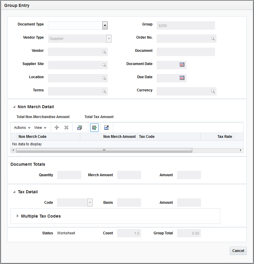

The Group Entry window facilitates the quick entry of multiple header-only documents. Group entry is available for merchandise invoices, non-merchandise invoices, and credit notes. All other document types are available using the single document entry process. The group entry window uses defaults where feasible to facilitate quick entry of documents. Group entry accepts the minimum fields necessary to create a header-only invoice, so if the user needs to enter item details or other information such as reference fields they would need to use the single document entry process.
Navigate: From the Tasks menu, select Document Maintenance > Group Entry. The Group Entry window opens.
Figure 1-4 Group Entry Window
From the Group Entry window, select the Document Type. Options are:
Merchandise Invoice
Non Merchandise Invoice
Credit Note
Once a document type is selected, enter information for the following:
Table 1-1 Group Entry Fields
Field Description Group ID
The Group ID is automatically assigned as the next number in a sequence.
Vendor Type
This field represents the type of vendor on the document being referenced. Options are:
Agent
Applicant
Bank
Broker
Consignee
Consolidator
Escheat- Country
Escheat - State
Expense Vendor
External Finisher
Factory
Freight Forwarder
Import Authority
Importer
Supplier
Order No
This field allows for selection of the Purchase Order against which the Document (or Invoice) is raised. The field will be enabled for selection when the Document Type is Supplier.
Note: If an Order No. is entered before the vendor, the vendor, supplier site, and terms default to the values from the purchase order. Additionally, if there is only one location on the purchase order, then the location will default to that value as well.
Vendor
This field allows selection of the Vendor against whom the Document (or Invoice) is raised.
Supplier Site
This field is available if the Vendor Type is set to Supplier. This field allows selection of the Supplier Site against whom the Document (or Invoice) is raised.
Terms
This field allows specification of the Document Terms.
This field will default to the value specified below depending on the document being created.
Merch Invoice – Terms on the PO specified
Non Merch Invoice – Terms associated with the Vendor in RMS
Credit Note – Terms associated with the Vendor in RMS
The defaulted value can be modified on the document.
Location
This field indicates the Invoicing (Billing) Location. The value is selectable from the list of valid locations (stores and physical warehouses) defined in Merchandising. This field is defaulted if the Order No selected has a single Location on it.
Document ID
Identifier for the Document in Invoice Match that is used in communication with the vendors and is displayed to the end user. This value must be unique by vendor, document type, and document date.
If the vendor created the document (i.e. merchandise invoice, etc), this field will hold the vendors id for the document.
Document Date
Specifies the document date. The document date is the date the document was created. When documents are created by an outside party, the document date can be different from the create date (i.e. the document date on a merchandise invoice from a supplier will be the date the supplier generates the invoice while the create date for this record will be the date the invoice was entered/uploaded into Invoice Match).
Due Date
Represents the day the document is due for payment. Is computed based on the document date (or the last receipt date depending on supplier option) and the applicable Payment Terms. This is a view only field.
Currency
This column holds the currency associated with the document. Currency is display only on merchandise invoices.
If you are entering a Non-Merchandise document (or adding non-merchandise entry to a merchandise document), the following non-merchandise fields are available from the non-merchandise table:
Table 1-2 Non-Merchandise Document Fields
Field Description Non Merch Code
Available largely as a quick entry alternative. Allows specification of a single non merch code applicable to the document. Additional codes if required can be entered via the Non Merch Costs tab.
Non Merch Amount
Available largely as a quick entry alternative in case of single non merchandise cost scenarios. Represents the Non merch Amount corresponding to the Non Merch Code specified.
If multiple non-merch codes are entered, this field will display the accumulated total of the non-merch amounts.
Tax Code
Enter the tax code associated with the non merchandise entry.
Tax Rate
The tax rate associated with the non merch Tax code will display.
Tax Amount
The Tax Amount associated with the non merch tax code is calculated and displayed here.
In the Document Totals section, enter information for the following fields:
Table 1-3 Document Totals Fields
Field Description Total Quantity
This field represents the total number of units on the document.
If the Total Quantity Required indicator is set for this supplier site, then total quantity must be entered. If the indicator is not set, then quantity is optional.
Total Merch Amount
Represents the Total Merchandise Value excluding tax. Is computed based on the below formula
Total Merch Amount= Total Amount- Non Merch Amount- Tax Amount
Total Amount
Represents the total value of the Document. This field is automatically populated with the sum of the Non Merch Amount and Tax Amounts if not entered. It can be overridden or entered by the user.
In the Tax Totals section, enter information for the following fields:
Table 1-4 Tax Totals Fields
Field Description Tax Code
Available largely as a quick entry alternative in single tax scenarios. Specifies the tax code applicable on the document at a header level. Additional codes if required can be entered via the Tax Breakdown detail tab
Taxable Basis
Available largely as a quick entry alternative in single tax scenarios. Specifies the taxable basis on which the tax code should be applied. Will be computed by dividing the tax amount by the tax rate if the tax code and tax amount are added first
Tax Amount
Available largely as a quick entry alternative in single tax scenarios. This amount is computed by applying the tax code on the taxable basis if the tax code and basis are added first. Can be overwritten by the user.
There is also a Tax Table to support entry of multiple taxes if necessary.
In the Group Totals section, enter information for the following fields:
Table 1-5 Group Totals Fields
Field Description Document Status
This field displays the status of the document. This is a view only field.
Group Count
This should be a count of the number of invoices included in the group entry batch. The count includes the current invoice, so it is incremented after the document id and date are both provided.
Group Total Amount
This is an accumulated total amount of all the invoices included in the group entry batch. The total amount includes the current invoice, so the total amount is incremented whenever the total invoice amount is updated.
When all of the necessary information is added to your entry, click Save. Clicking the arrow adjacent to the Save button provides the following options:
Save and Add Another – This option performs validation on the document to ensure it can be added in 'approved' mode, though it will stay in 'Worksheet' status until an 'Approve' is performed. If it passes validation, the document is updated to the database and the screen is cleared awaiting the next entry.
Save and Close – This step performs the same validation and if it passes adds the document to the database just like the Save and Add Another, but then the UI is closed. Save and close will keep the documents in worksheet status. You must click Approve for the documents to be approved.
In addition to the options above, group entry has the following features:
You can save and close a group without approving, then later call the Group back up through Document maintenance. In Document Maintenance, you search for the group, then highlight any invoice in the group. With the invoice highlighted, choose the 'Group Entry' action from the Actions drop down menu.
There are also forward and backward navigation buttons in group entry which can be used to page through the invoices in the group to verify/correct the information.
