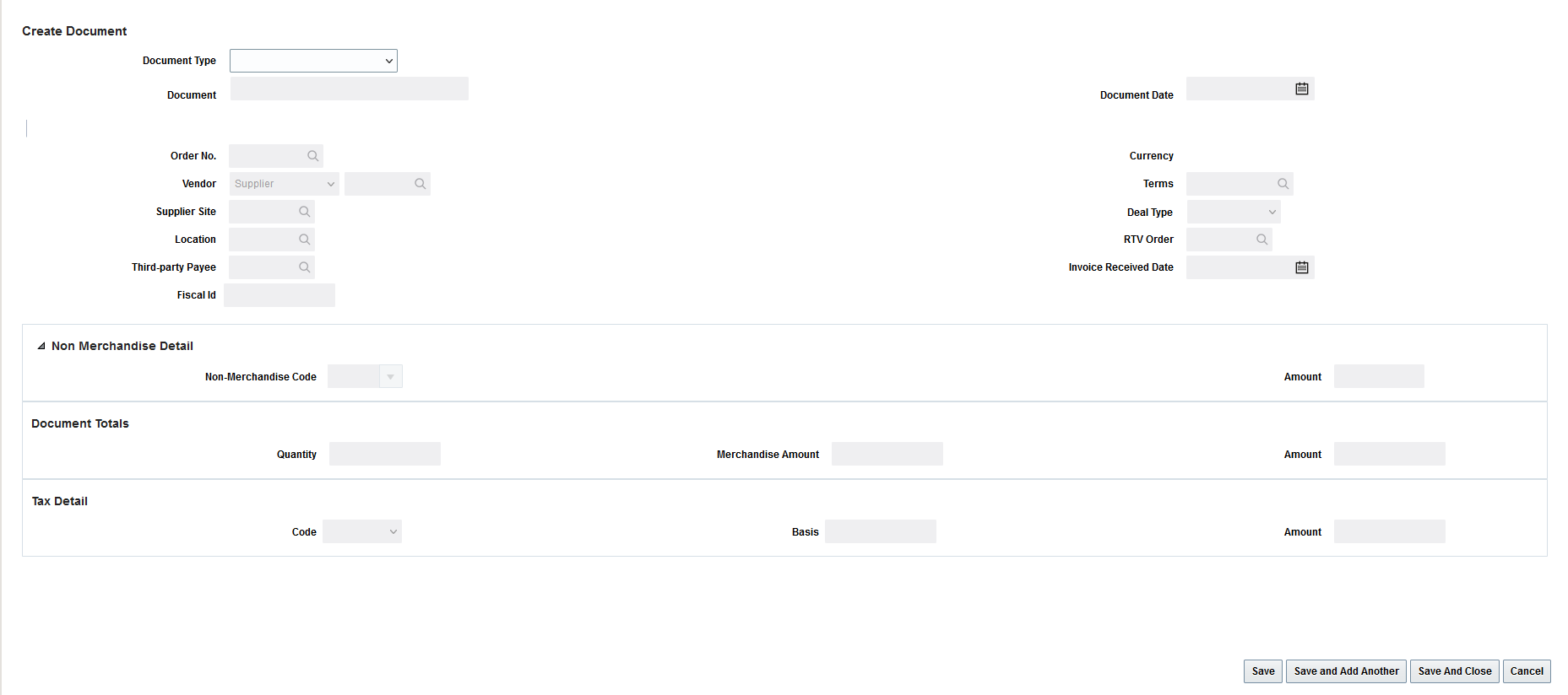

Navigate: From the Tasks menu, select Document Maintenance > Create Document. The Create Document screen opens.
Figure 1-1 Create Document
Create Document window
  1. Open the Create Document screen. The Create Document screen is launched when the user chooses to create a Document through either of the one of the following:
    • Clicking the Create Document link under the Document Maintenance subgroup on the Global Navigation section
    • Select Create Document from the Actions menu on the Search Results Pane
  2. In the Document Type field, select Merchandise Invoice. Once the Document Type is selected, the field is disabled and the Vendor Type is set to Supplier.
