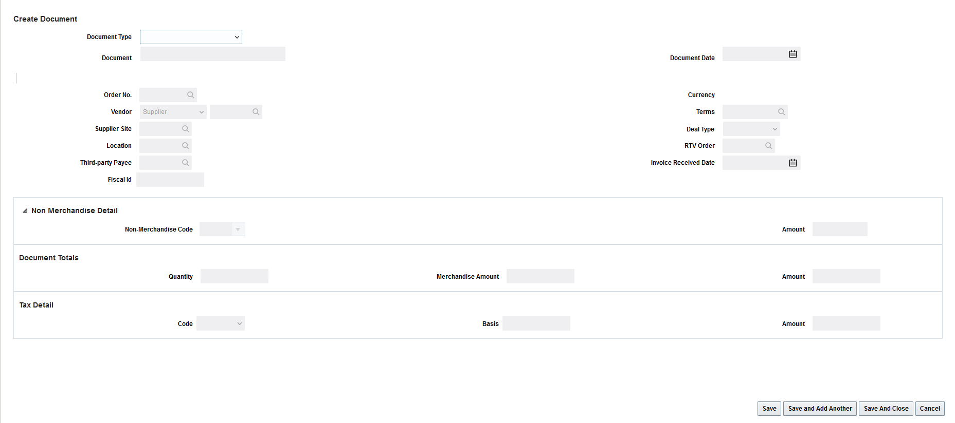

Navigate: From the Tasks menu, select Document Maintenance > Create Document. The Create Document screen opens.
Figure 1-1 Create Document
Create Document window
  1. Open the Create Document screen. The Create Document screen is launched when the user chooses to create a Document through either of the one of the following:
    • Clicking the Create Document link under the Document Maintenance subgroup on the Global Navigation section
    • Select Create Document from the Actions menu on the Search Results Pane
  2. In the Document Type field, select Merchandise Invoice. Once the Document Type is selected, the field is disabled and the Vendor Type is set to Supplier.
Header Information
  1. In the Document field, enter the identifier for the Document in Invoice Match that is used in communication with the vendors and will be displayed to the end user. This must be unique by vendor, document type, and (optionally depending on system setting) by document date.
  2. In the Document Date field, enter the date the invoice was created, or click the calendar button and select a date.
  3. In the Order No. field, select the Purchase Order against which the Document (or Invoice) is raised.
    If an Order No. is entered before the vendor, the vendor, supplier site, and terms will default to values from the purchase order. Additionally, if there is only one location on the purchase order, then the location will default to that location as well.
  4. In the Vendor field, select the Supplier against which the Invoice is raised.
    If a Supplier is specified before the Order No, the combo box list of values dropdown displays orders corresponding to all suppliers in the same supplier group as the supplier specified.
  5. The Terms field defaults to the term of the specified PO. The defaulted value can be modified on the invoice document.
  6. In the Supplier Site field, select the Supplier Site against which the Document (or Invoice) is raised.
  7. In the Location field, select the Invoicing (Billing) Location from the list of valid locations (stores and physical warehouses). These locations are defined in Merchandising.
    The Location field value is defaulted if the Order No selected has a single Location to which it is associated.
    For import PO's the Import Location is used as the location in Invoice Match.
  8. In the Third-party Payee field, enter the name of the third-party vendor who will remit payment instead of the vendor associated with the PO. The third-party payee can be any valid parent supplier from the Merchandising system.
    The Third-party Payee field is only displayed if the Allow Third-Party Payee system option is checked
  9. In the Invoice Received Date, enter the date the document was received from the vendor.
  10. In the Fiscal ID field, enter the fiscal ID. The fiscal ID is an optional identifier used by government agencies to assist in the auditing of financial transactions.
    The Fiscal ID field is enabled unless E-Invoicing is configured and the document type is ‘retailer issued’. See the Retail Invoice Matching Cloud Service Implementation Guide for details on E-Invoicing.
Non Merchandise Detail
The Non Merchandise Details section allows the addition of a single non merchandise code / amount to an invoice document as part of a quick entry flow. Additional codes and details can be entered using the Non Merchandise Details window available on the Document Maintenance screen.
  1. In the Non Merchandise Code field, specify a single non merchandise code that is applicable to the document. Additional codes can be entered using the Non Merchandise Costs screen if needed.
  2. In the Non Merchandise Amount field, specify the non merchandise amount corresponding to the Non Merchandise Code specified.
In a Global Tax environment, taxes associated with the non-merchandise codes can be entered into a tax table. Select the plus key on the tax table and a popup will appear allowing the entry of the tax code, tax rate, and tax basis. The OK and Add Another button allows multiple taxes to be associated with the non-merchandise code.
Document Totals
The Document Totals section allows the user to specify Total Merchandise Amount, Total Quantity, and Total Invoice Amount.
  1. In the Quantity field, enter the total number of units on the document.
    There is a supplier option that can be used to make the quantity field required.
  2. The Merchandise Amount field represents the Total Merchandise Value excluding tax.
    Total Merchandise Amount = Total Amount - Non Merchandise Amount - Tax Amount
  3. The Amount field represents the total value of the document. This field is automatically populated with the sum of the Merchandise Amount, Non Merchandise Amount, and Tax Amount(s).
Tax Details
In a Single Tax Environment the Tax Detail section allows the addition of a single tax code, tax basis and amount to an invoice as part of a quick entry flow. Additional codes and details may be entered using the Tax Breakdown window available on the Document Maintenance screen.
  1. In the Code field, specify the tax code applicable on the document at a header level.
  2. The basis field is automatically calculated when the tax code is entered if the merchandise amount is entered first. The calculated amount can be overwritten.
  3. The Amount field is automatically populated. It is computed by applying the tax code on the taxable basis if the tax code and basis are added first. The Amount field can be overwritten by the user.
In a Global Tax environment, document taxes can be entered into a tax table. Select the plus key on the tax table and a popup will appear allowing the entry of the tax code, tax rate type, tax rate, and tax basis. The OK and Add Another button allows multiple taxes to be included on the document. The tax table supports the entry of both percent or per unit taxes.
Save the Document
When all of the necessary information is added to your entry, choose one of the following options:
  • Click Save to save the document and navigate to the Document Maintenance window to add additional details to the document.
  • Click Save and Add Another to save the current invoice and open an empty Create Document page.
  • Click Save and Close to save the current invoice and close the Create Document page.
  • Click Cancel to reject all entries.

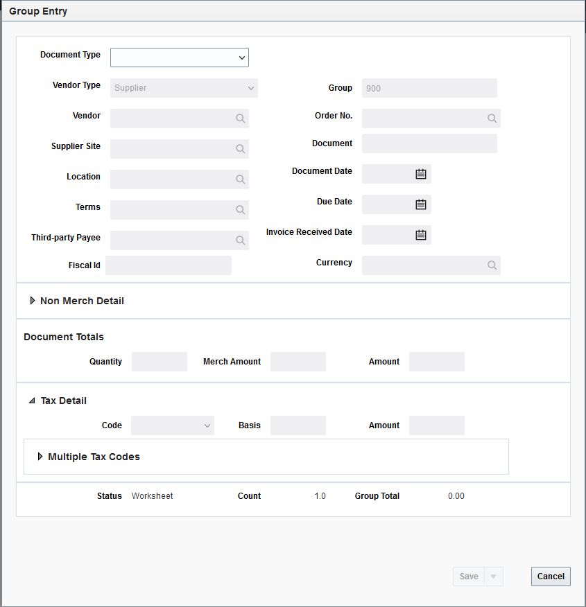

Navigate: From the Tasks menu, select Document Maintenance > Group Entry. The Group Entry window opens.
Figure 1-4 Group Entry Window
Group Entry Window
  1. From the Group Entry window, select the Document Type. Options are:
    • Merchandise Invoice
    • Non Merchandise Invoice
    • Credit Note
  2. Once a document type is selected, enter information for the following:
    Table 1-1 Group Entry Fields
    Field Description
    Group ID
    The Group ID is automatically assigned as the next number in a sequence.
    Vendor Type
    This field represents the type of vendor on the document being referenced. Options are:
    • Agent
    • Applicant
    • Bank
    • Broker
    • Consignee
    • Consolidator
    • Escheat- Country
    • Escheat - State
    • Expense Vendor
    • External Finisher
    • Factory
    • Freight Forwarder
    • Import Authority
    • Importer
    • Supplier
    Order No
    This field allows for selection of the Purchase Order against which the Document (or Invoice) is raised. The field will be enabled for selection when the Document Type is Supplier.
    Note: If an Order No. is entered before the vendor, the vendor, supplier site, and terms default to the values from the purchase order. Additionally, if there is only one location on the purchase order, then the location will default to that value as well.
    Vendor
    This field allows selection of the Vendor against whom the Document (or Invoice) is raised.
    Supplier Site
    This field is available if the Vendor Type is set to Supplier. This field allows selection of the Supplier Site against whom the Document (or Invoice) is raised.
    Terms
    This field allows specification of the Document Terms.
    This field will default to the value specified below depending on the document being created.
    • Merch Invoice – Terms on the PO specified
    • Non Merch Invoice – Terms associated with the Vendor in RMS
    • Credit Note – Terms associated with the Vendor in RMS
    The defaulted value can be modified on the document.
    Location
    This field indicates the Invoicing (Billing) Location. The value is selectable from the list of valid locations (stores and physical warehouses) defined in Merchandising. This field is defaulted if the Order No selected has a single Location on it.
    Document ID
    Identifier for the Document in Invoice Match that is used in communication with the vendors and is displayed to the end user. This value must be unique by vendor, document type, and document date.
    If the vendor created the document (i.e. merchandise invoice, etc), this field will hold the vendors id for the document.
    Document Date
    Specifies the document date. The document date is the date the document was created. When documents are created by an outside party, the document date can be different from the create date (i.e. the document date on a merchandise invoice from a supplier will be the date the supplier generates the invoice while the create date for this record will be the date the invoice was entered/uploaded into Invoice Match).
    Due Date
    Represents the day the document is due for payment. Is computed based on the document date (or the last receipt date depending on supplier option) and the applicable Payment Terms. This is a view only field.
    Currency
    This column holds the currency associated with the document. Currency is display only on merchandise invoices.
    Third-party Payee
    Specifies the name of the third-party vendor who will remit payment instead of the vendor associated with the PO. The third-party payee can be any valid parent supplier from the Merchandising system.
    Specifies the date the document was received from the vendor.
    Fiscal ID
    Specifies the fiscal ID. The fiscal ID is an identifier used by government agencies to assist in the auditing of financial transactions.
  3. If you are entering a Non-Merchandise document (or adding non-merchandise entry to a merchandise document), the following non-merchandise fields are available from the non-merchandise table:
    Table 1-2 Non-Merchandise Document Fields
    Field Description
    Non Merch Code
    Available largely as a quick entry alternative. Allows specification of a single non merch code applicable to the document. Additional codes if required can be entered via the Non Merch Costs tab.
    Non Merch Amount
    Available largely as a quick entry alternative in case of single non merchandise cost scenarios. Represents the Non merch Amount corresponding to the Non Merch Code specified.
    If multiple non-merch codes are entered, this field will display the accumulated total of the non-merch amounts.
    Tax Code
    Enter the tax code associated with the non merchandise entry.
    Tax Rate
    The tax rate associated with the non merch Tax code will display.
    Tax Amount
    The Tax Amount associated with the non merch tax code is calculated and displayed here.
  4. In the Document Totals section, enter information for the following fields:
    Table 1-3 Document Totals Fields
    Field Description
    Total Quantity
    This field represents the total number of units on the document.
    If the Total Quantity Required indicator is set for this supplier site, then total quantity must be entered. If the indicator is not set, then quantity is optional.
    Total Merch Amount
    Represents the Total Merchandise Value excluding tax. Is computed based on the below formula
    Total Merch Amount= Total Amount- Non Merch Amount- Tax Amount
    Total Amount
    Represents the total value of the Document. This field is automatically populated with the sum of the Non Merch Amount and Tax Amounts if not entered. It can be overridden or entered by the user.
  5. In the Tax Totals section, enter information for the following fields:
    Table 1-4 Tax Totals Fields
    Field Description
    Tax Code
    Available largely as a quick entry alternative in single tax scenarios. Specifies the tax code applicable on the document at a header level. Additional codes if required can be entered via the Tax Breakdown detail tab
    Taxable Basis
    Available largely as a quick entry alternative in single tax scenarios. Specifies the taxable basis on which the tax code should be applied. Will be computed by dividing the tax amount by the tax rate if the tax code and tax amount are added first
    Tax Amount
    Available largely as a quick entry alternative in single tax scenarios. This amount is computed by applying the tax code on the taxable basis if the tax code and basis are added first. Can be overwritten by the user.
    There is also a Tax Table to support entry of multiple taxes if necessary.
  6. In the Group Totals section, enter information for the following fields:
    Table 1-5 Group Totals Fields
    Field Description
    Document Status
    This field displays the status of the document. This is a view only field.
    Group Count
    This should be a count of the number of invoices included in the group entry batch. The count includes the current invoice, so it is incremented after the document id and date are both provided.
    Group Total Amount
    This is an accumulated total amount of all the invoices included in the group entry batch. The total amount includes the current invoice, so the total amount is incremented whenever the total invoice amount is updated.
  7. When all of the necessary information is added to your entry, click Save. Clicking the arrow adjacent to the Save button provides the following options:
    • Save and Add Another – This option performs validation on the document to ensure it can be added in 'approved' mode, though it will stay in 'Worksheet' status until an 'Approve' is performed. If it passes validation, the document is updated to the database and the screen is cleared awaiting the next entry.
    • Save and Close – This step performs the same validation and if it passes adds the document to the database just like the Save and Add Another, but then the UI is closed. Save and close will keep the documents in worksheet status. You must click Approve for the documents to be approved.
    In addition to the options above, group entry has the following features:
    • You can save and close a group without approving, then later call the Group back up through Document maintenance. In Document Maintenance, you search for the group, then highlight any invoice in the group. With the invoice highlighted, choose the 'Group Entry' action from the Actions drop down menu.
    • There are also forward and backward navigation buttons in group entry which can be used to page through the invoices in the group to verify/correct the information.

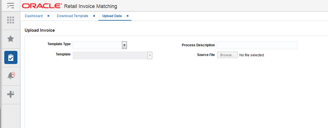

Navigate: From the Tasks menu, select Data Loading > Upload Data. The Upload Data window opens.
Figure 1-5 Upload Data Window
Upload Data Window
  1. From the Upload Data window, select a template type in the Template Type field. The following template types are supported:
    • Non-merchandise Invoice
    • Credit Note
    • Debit Memo
    • Credit Memo
    • Credit Note Request
  2. Select a template from the Template list. The list of values allows the selection of a template from all the templates defined in the system that are linked to the selected Template Type. It is mandatory to select a Template.
  3. Enter a value in the Process Description field. The value specified in this field allows the user to more easily search for and find the process created for the upload in order to identify the status of the upload and view any errors that may have been identified. This is a mandatory field.
  4. In the Source field, enter the directory and filename of your upload file. Alternatively, you can use the Browse button to browse to the upload file.
    Click Upload to submit your upload for processing.
