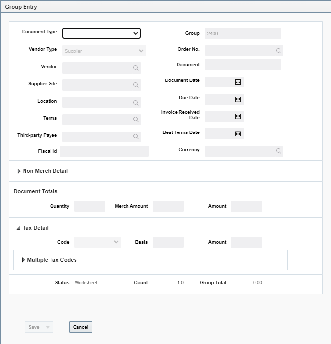

Use Group Entry
Group entry is an extension of the manual entry process with the addition of features such as control totals and defaulting common values to provide greater accuracy and efficiency when manually entering documents. The group entry feature allows the entry of header only documents. Merchandise invoices, non-merchandise invoices, and credit notes are the only document types allowed in the group entry function.
Group Entry of Header-Only Documents
The Group Entry window facilitates the quick entry of multiple header-only documents. Group entry is available for merchandise invoices, non-merchandise invoices, and credit notes. All other document types are available using the single document entry process. The group entry window uses defaults where feasible to facilitate quick entry of documents. Group entry accepts the minimum fields necessary to create a header-only invoice, so if the user needs to enter item details or other information such as reference fields they would need to use the single document entry process.
Navigate: From the Tasks menu, select Document Maintenance > Group Entry. The Group Entry window opens.
Figure 1-4 Group Entry Window
Group Entry Window
  1. From the Group Entry window, select the Document Type. Options are:
    • Merchandise Invoice
    • Non Merchandise Invoice
    • Credit Note
  2. Once a document type is selected, enter information for the following:
    Table 1-1 Group Entry Fields
    Field Description
    Group ID
    The Group ID is automatically assigned as the next number in a sequence.
    Vendor Type
    This field represents the type of vendor on the document being referenced. Options are:
    • Agent
    • Applicant
    • Bank
    • Broker
    • Consignee
    • Consolidator
    • Escheat- Country
    • Escheat - State
    • Expense Vendor
    • External Finisher
    • Factory
    • Freight Forwarder
    • Import Authority
    • Importer
    • Supplier
    Order No
    This field allows for selection of the Purchase Order against which the Document (or Invoice) is raised. The field will be enabled for selection when the Document Type is Supplier.
    Note: If an Order No. is entered before the vendor, the vendor, supplier site, and terms default to the values from the purchase order. Additionally, if there is only one location on the purchase order, then the location will default to that value as well.
    Vendor
    This field allows selection of the Vendor against whom the Document (or Invoice) is raised.
    Supplier Site
    This field is available if the Vendor Type is set to Supplier. This field allows selection of the Supplier Site against whom the Document (or Invoice) is raised.
    Terms
    This field allows specification of the Document Terms.
    This field will default to the value specified below depending on the document being created.
    • Merch Invoice – Terms on the PO specified
    • Non Merch Invoice – Terms associated with the Vendor in RMS
    • Credit Note – Terms associated with the Vendor in RMS
    The defaulted value can be modified on the document.
    Location
    This field indicates the Invoicing (Billing) Location. The value is selectable from the list of valid locations (stores and physical warehouses) defined in Merchandising. This field is defaulted if the Order No selected has a single Location on it.
    Document ID
    Identifier for the Document in Invoice Match that is used in communication with the vendors and is displayed to the end user. This value must be unique by vendor, document type, and document date.
    If the vendor created the document (i.e. merchandise invoice, etc), this field will hold the vendors id for the document.
    Document Date
    Specifies the document date. The document date is the date the document was created. When documents are created by an outside party, the document date can be different from the create date (i.e. the document date on a merchandise invoice from a supplier will be the date the supplier generates the invoice while the create date for this record will be the date the invoice was entered/uploaded into Invoice Match).
    Due Date
    Represents the day the document is due for payment. Is computed based on the document date (or the last receipt date depending on supplier option) and the applicable Payment Terms. This is a view only field.
    Currency
    This column holds the currency associated with the document. Currency is display only on merchandise invoices.
    Third-party Payee
    Specifies the name of the third-party vendor who will remit payment instead of the vendor associated with the PO. The third-party payee can be any valid parent supplier from the Merchandising system.
    Invoice Received Date
    Specifies the date the document was received from the vendor.
    Fiscal ID
    Specifies the fiscal ID. The fiscal ID is an identifier used by government agencies to assist in the auditing of financial transactions.
    Best Term Date
    In the Best Terms Date field, users can optionally enter the Best Terms Date. If entered, the date will override the best terms date which is derived in the Best Terms calculation. The Best Terms Date is the basis date which is passed to the financial system with the Best Terms (payment terms) and is used as the starting date to calculate the due date.
  3. If you are entering a Non-Merchandise document (or adding non-merchandise entry to a merchandise document), the following non-merchandise fields are available from the non-merchandise table:
    Table 1-2 Non-Merchandise Document Fields
    Field Description
    Non Merch Code
    Available largely as a quick entry alternative. Allows specification of a single non merch code applicable to the document. Additional codes if required can be entered via the Non Merch Costs tab.
    Non Merch Amount
    Available largely as a quick entry alternative in case of single non merchandise cost scenarios. Represents the Non merch Amount corresponding to the Non Merch Code specified.
    If multiple non-merch codes are entered, this field will display the accumulated total of the non-merch amounts.
    Tax Code
    Enter the tax code associated with the non merchandise entry.
    Tax Rate
    The tax rate associated with the non merch Tax code will display.
    Tax Amount
    The Tax Amount associated with the non merch tax code is calculated and displayed here.
  4. In the Document Totals section, enter information for the following fields:
    Table 1-3 Document Totals Fields
    Field Description
    Total Quantity
    This field represents the total number of units on the document.
    If the Total Quantity Required indicator is set for this supplier site, then total quantity must be entered. If the indicator is not set, then quantity is optional.
    Total Merch Amount
    Represents the Total Merchandise Value excluding tax. Is computed based on the below formula
    Total Merch Amount= Total Amount- Non Merch Amount- Tax Amount
    Total Amount
    Represents the total value of the Document. This field is automatically populated with the sum of the Non Merch Amount and Tax Amounts if not entered. It can be overridden or entered by the user.
  5. In the Tax Totals section, enter information for the following fields:
    Table 1-4 Tax Totals Fields
    Field Description
    Tax Code
    Available largely as a quick entry alternative in single tax scenarios. Specifies the tax code applicable on the document at a header level. Additional codes if required can be entered via the Tax Breakdown detail tab
    Taxable Basis
    Available largely as a quick entry alternative in single tax scenarios. Specifies the taxable basis on which the tax code should be applied. Will be computed by dividing the tax amount by the tax rate if the tax code and tax amount are added first
    Tax Amount
    Available largely as a quick entry alternative in single tax scenarios. This amount is computed by applying the tax code on the taxable basis if the tax code and basis are added first. Can be overwritten by the user.
    There is also a Tax Table to support entry of multiple taxes if necessary.
  6. In the Group Totals section, enter information for the following fields:
    Table 1-5 Group Totals Fields
    Field Description
    Document Status
    This field displays the status of the document. This is a view only field.
    Group Count
    This should be a count of the number of invoices included in the group entry batch. The count includes the current invoice, so it is incremented after the document id and date are both provided.
    Group Total Amount
    This is an accumulated total amount of all the invoices included in the group entry batch. The total amount includes the current invoice, so the total amount is incremented whenever the total invoice amount is updated.
  7. When all of the necessary information is added to your entry, click Save. Clicking the arrow adjacent to the Save button provides the following options:
    • Save and Add Another – This option performs validation on the document to ensure it can be added in 'approved' mode, though it will stay in 'Worksheet' status until an 'Approve' is performed. If it passes validation, the document is updated to the database and the screen is cleared awaiting the next entry.
    • Save and Close – This step performs the same validation and if it passes adds the document to the database just like the Save and Add Another, but then the UI is closed. Save and close will keep the documents in worksheet status. You must click Approve for the documents to be approved.
    In addition to the options above, group entry has the following features:
    • You can save and close a group without approving, then later call the Group back up through Document maintenance. In Document Maintenance, you search for the group, then highlight any invoice in the group. With the invoice highlighted, choose the 'Group Entry' action from the Actions drop down menu.
    • There are also forward and backward navigation buttons in group entry which can be used to page through the invoices in the group to verify/correct the information.

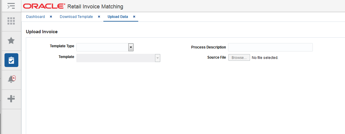

Upload Data
Once users have added the documents to the spreadsheet, they will submit an upload request.
Navigate: From the Tasks menu, select Data Loading > Upload Data. The Upload Data window opens.
Figure 1-5 Upload Data Window
Upload Data Window
  1. From the Upload Data window, select a template type in the Template Type field. The following template types are supported:
    • Non-merchandise Invoice
    • Credit Note
    • Debit Memo
    • Credit Memo
    • Credit Note Request
  2. Select a template from the Template list. The list of values allows the selection of a template from all the templates defined in the system that are linked to the selected Template Type. It is mandatory to select a Template.
  3. Enter a value in the Process Description field. The value specified in this field allows the user to more easily search for and find the process created for the upload in order to identify the status of the upload and view any errors that may have been identified. This is a mandatory field.
  4. In the Source field, enter the directory and filename of your upload file. Alternatively, you can use the Browse button to browse to the upload file.
    Click Upload to submit your upload for processing.
