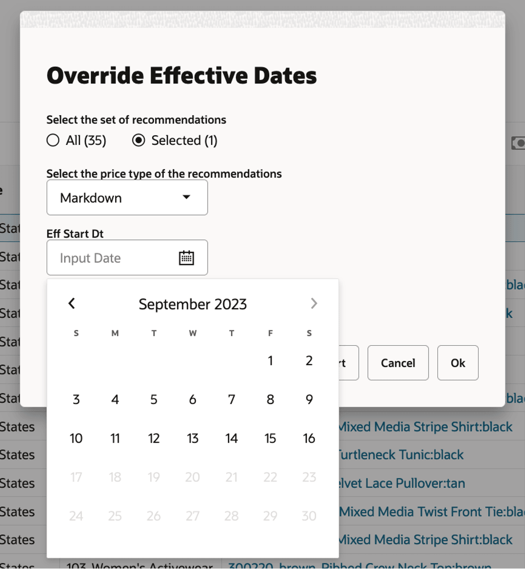

Date Override
Date Override is used to adjust the effective start and end dates for a promotion or the effective start date for a markdown recommendation. You can select the recommendations that are in Ready for Review status and click Date Override, which displays the Override Effective Dates screen, as shown in the following figure. You can select Price Type and then pick the corresponding dates from the date picker. The Price Type can be either Promotion or Markdown.

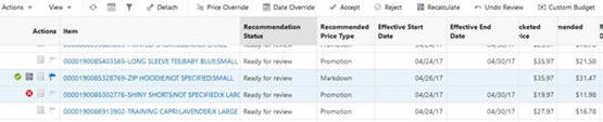

If you wanted to modify the effective start date for a Markdown recommendation, but accidentally selected both Promotion and Markdown recommendations, after the Date Override operation, the system will return a failure for the Promotion recommendation, as shown in the following figure. Successful date overrides are shown with a green check mark and a recalculate icon; the latter indicates that this item must be submitted for a recalculation in order to adjust the projected metrics due to the date override.
Figure 7-18 Results for Date Override Action
