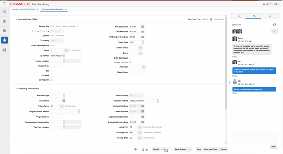

In certain entities in Merchandising, there is an option to integrate
with the Slack collaboration tool. When this feature is turned on,
the contextual area of an enabled screen shows the related conversations
for the entity (e.g., purchase order) being maintained. Click on the
conversation tab in the contextual pane
to access the conversation. From here, you can create a new
conversation for an entity, view all existing messages for an entity,
and post messages and replies. You can also add or remove members
from a conversation and view documents that have been uploaded to
Slack. Conversations create channels in Slack.
Figure 9-1 Conversations Pane

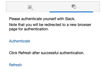

Log In
To begin using this functionality, you will first need to log into the Slack application that has been configured for Merchandising. To do this, click on the Authenticate link and then enter your Slack username and password. Then, click the Refresh link in Merchandising after authenticating.
