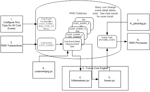

Future Cost Process
This process focuses on batch runs of the future cost engine.
Figure 9-4 Future Cost Process
Administrators configure the system (COST_EVENT_RUN_TYPE) to define which cost events types will be processed synchronously, asynchronously or in batch. Configuration by cost event type also determines some threading and chunking parameters.
Merchandising transactions that should drive future cost recalculation write Cost Events (COST_EVENT and cost event type specific tables).
Future Cost Engine recalculates future cost
This process flow focuses on batch recalculations, but synchronous or asynchronous processes could easily be substituted in this step.
fcthreadexec.pc prepares threads for processing
fcexec.pc recalculates future cost and writes it the future cost table (FUTURE_COST)
Merchandising processes use future cost information to determine investment buy, margin, and so on.
fc_pricechg.pc performs special calculation of pricing cost for franchise locations
costeventprg.pc purges aged cost events from the working cost event tables.
