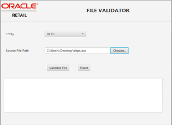

To use the Off-line File Validator tool, double click the DataConversionFileValidator.jar to run the application.

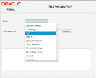

Select the entity (table) whose file you want to validate.
Choose the source file path.

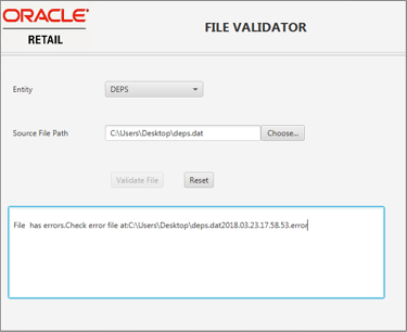

Click the Validate File button. If the data has errors, then an error file is generated and the file path is displayed in the text area.

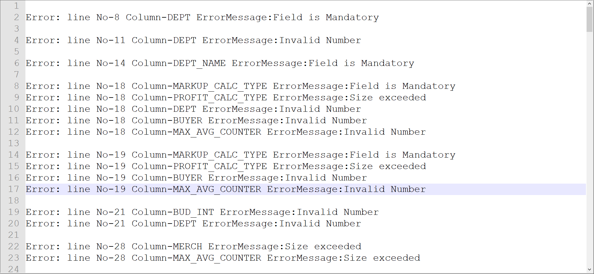

Below is an example of what an error file might look like.
