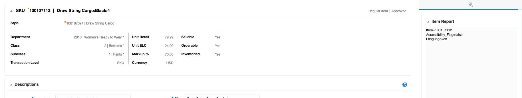

For all of the Merchandising contextual panes, there is a report that can be used to help with visibility to the parameters available. This helper report can be configured on during development phases of your program and then configured off in production. It is controlled by the report system option RMS_OI_SYSTEM_OPTIONS.DISPLAY_CONTEXTUAL_PAYLOAD.Here is an example of what the report looks like in the Item workflow:
Additionally, all the Merchandising contextual models support the following two parameters:
Accessibility flag (accessibilityEnabled) - indicates whether or not the user has turned on Screen Reader mode
Preferred Language (preferredLanguage) - indicates what is the language that the user selected in User Preferences
